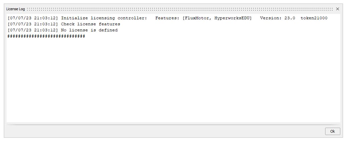

- Firstly, the License Log window will open automatically and display an error message indicating that no license has been defined or that no FluxMotor feature is valid.
- Secondly, the “License setup” window will open automatically.
| License Log window indicating that no license has been defined or that no FluxMotor feature is valid. |

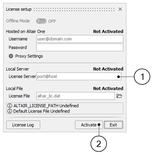

- Launch the software. If you do not have a valid license on your workstation, the
“License setup” window will open automatically, and the license status will show
as “Not Activated”.
Figure 1 – License status Not Activated - Enter the port@host information for the License Server (Mark 1 - Figure 1 –
License status ).
Example: 6200@192.168.100.5
- Click on the “Activate” button (Mark 2 - Figure 1 – License status ). The status
changes to “Activated” when the license is validated, or you will receive an error
message if unsuccessful. Warning:
This license activation will be available only during the FluxMotor® session. After the closure of FluxMotor®, you will have to do this action again.
Please refer to section 5.2.3 (Specifying a license with a Windows environment variable) if you want to save your license registration.

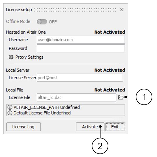

Standalone license activation
Certain applications will have standalone licenses available from your reseller. In this case, you will need to specify your license file in the HyperWorks section of the “License setup” window.
Prerequisites: Obtain a valid license file from your Altair Account Manager.
- Once your license file has been emailed to you, copy it to your preferred location on your workstation.
“License Setup” window will open automatically, and the license status will show as
“Not Activated”.
Figure 2 – License status Not-Activated - Click on the browser button (Mark 1 - Figure 2 – License status Not-Activated) and browse to the location of the License File.
- Click on the Activate button (Mark 2 - Figure 2 – License status Not-Activated). The
status will change to Activated when the license is validated, or you will receive an
error message if unsuccessful. Warning:
The license activation will be available only during the FluxMotor® session. After the closing of FluxMotor® session, the license must be reactivated for using FluxMotor®.
Please, refer to the section 5.2.3 (Specifying a license with a Windows environment variable) for specifying a license with a windows environment variable.
Tip: You can also use an environment variable to specify a license file.

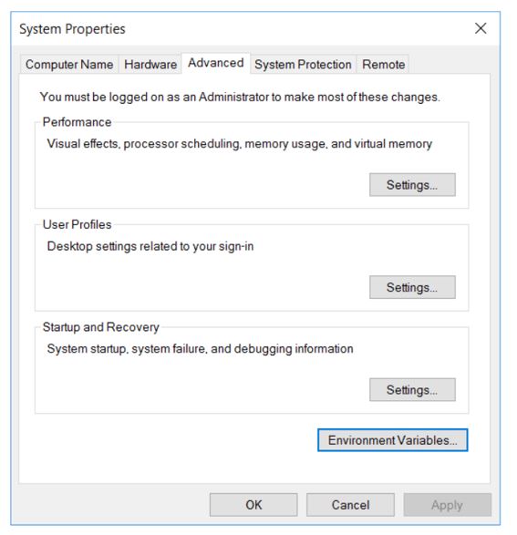

Some companies prefer to use environment variables for licensing. When setting up an environment variable, you can specify a single-user license file on your local machine or a network server license.
You can also point to multiple files, locally or on a server, with the environment variable.
- Click the Windows Start menu and navigate to System Properties.Tip: In Windows 10, type "env" and then select Edit the System Environment Variables.
Figure 3 – System Properties – Definition of Environment variable ALTAIR_LICENSE_PATH - Click the Environment Variables button.
- Under User variables, click New and create a variable named ALTAIR_LICENSE_PATH. If you already have this variable, highlight it and click Edit.
- Set the variable value to point to the single-user license file or the license
server. Enter the complete file path to the license file, for instance:"C:\Users\name\Documents\licensefile.dat" or enter the port@host for the license server.Tip: You can use a semicolon to append a value with additional license locations.
- Click OK

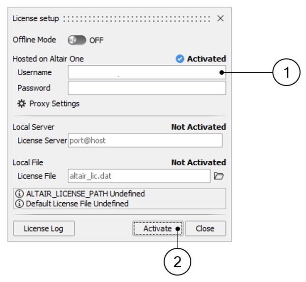

as Not Activated.
Figure 4 – License via Altair One - Dialog box - Enter the Username and Password you created for your Altair OneTM account (Mark 1 - Figure 4 – License via Altair One - Dialog box).
- Click on the Activate button (Mark 2 - Figure 4 – License via Altair One - Dialog box). The status changes to “Activated” when the license is validated, or you will receive an error message if unsuccessful.

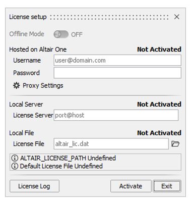

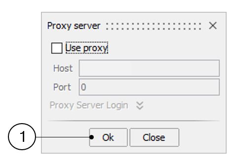

- If your company uses a proxy server, click Proxy Settings, select Use Proxy, and
enter the Host and Port numbers.
Figure 5 – Proxy Server Settings - Dialog box - If your proxy server requires authentication, click Proxy Server Login and enter a Username and Password.
- Click on the OK button (Mark 1 - Figure 5 – Proxy Server Settings - Dialog box). The status will change to Activated when the license is validated, or you will receive an error message if unsuccessful.

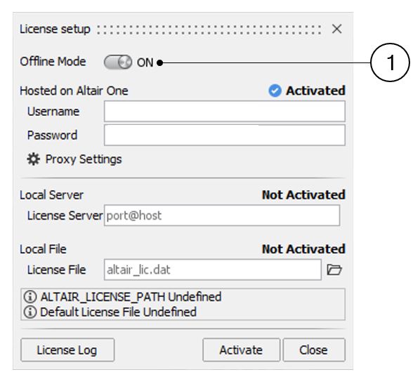

Using Altair OneTM account license in offline
- Select File > Licensing to open the “License setup” window.
Figure 6 – License via Altair One – Offline Mode -
Click the “Offline Mode” slider (Mark 1 Figure 6 – License via Altair One – Offline Mode).
You may now run the application without an internet connection for up to two weeks. Note that each application must be checked out individually.
- To check the units back in, click the “Online Mode” check box again.
