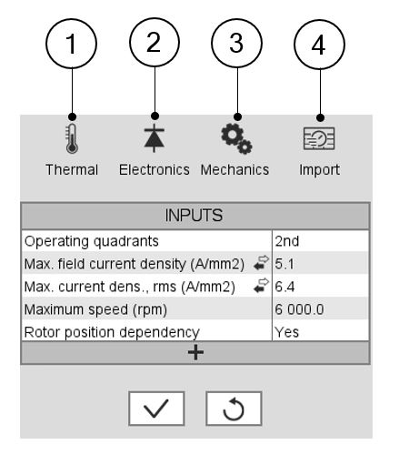

Test inputs & settings – Overview
Settings
Settings allow defining the context in which the test is going to be performed.
Their definition is specific to each test.
- Thermal:
- To make the choice of the thermal solving (when available)
- To define the winding temperatures
- Electronics: To define the power electronics stage feeding the machine
- Mechanics: To define the mechanical loss model parameters
- Import: To import data/setting/input from one test to another, if possible
| 1 | Button to define the thermal inputs (Solving mode or winding temperatures) |
| 2 | Button to define the user inputs of the power electronics stage |
| 3 | Button to define the parameters of the mechanical loss model |
| 4 | Button to import data/setting/input from one test to another, if possible |

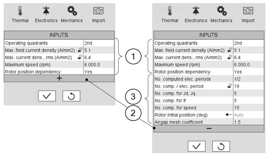

Advanced parameters
In addition to standard parameters, the users can access a list of advanced parameters.
| 1 | List of standard user input parameters |
| 2 |
Click on “+” allows to display advanced parameters Once displayed, advanced parameters can be hidden by clicking on “-” |
| 3 | List of advanced parameters |
