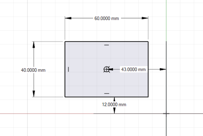

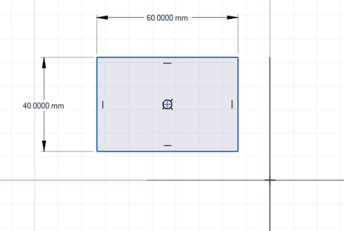

- Once a rectangle sketch has been defined by two dimensions (e.g. length and width) additional dimensions will be captured as reference dimensions by default.

A sketch is fullly defined when its dimensions and its position relative to the point of origin have been defined. A fully defined sketch will appear in black.

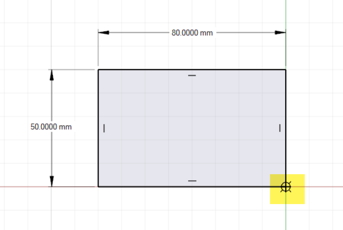

Apply dimensions between the sketch and the point of origin.
Right-click and mouse through the check mark to exit, or double-right-click.
Tip: To find and open a tool, press Ctrl+F. For more information, see Find and Search for Tools.
The easiest way to fully define a sketch is to start it from the global point of origin.

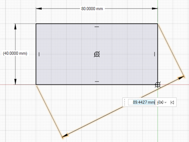

- In an active sketch, select a dimension.
In the microdialog:
- Enter the desired dimension in the text field OR
- Select the
icon the assign a
variable to the dimension
- Press the Enter key.
- Left-click to close the microdialog.

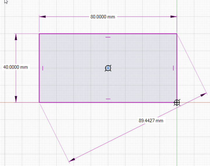

Edit a Reference Dimension
Convert a reference dimension to a driving dimension and edit it.

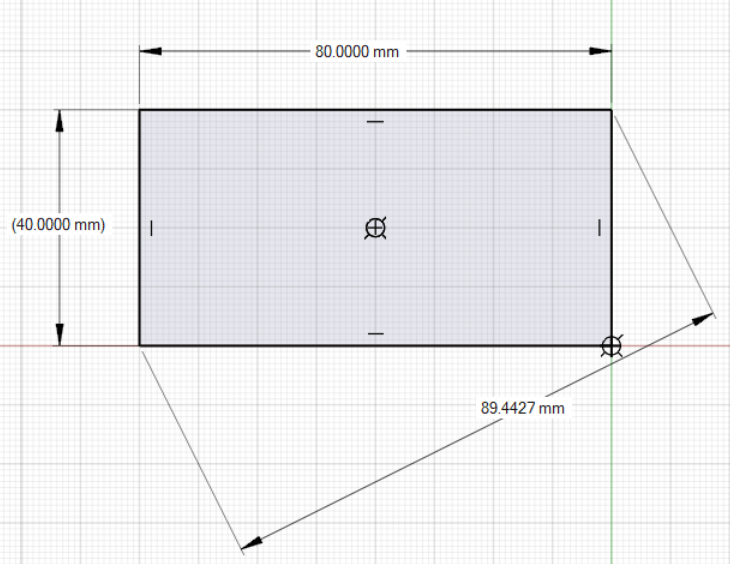

- In an active sketch, right-click the reference dimension you wish to edit.
Deselect Reference on the context menu.

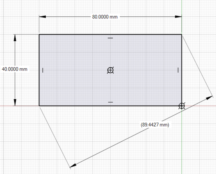

The dimension will appear as a driving dimension (without parentheses), but the sketch may now be colored magenta, indicating that it is overconstrained.
Right-click one of the other dimensions. Select
Reference in the context menu.
The dimension now appears in parentheses, indicating that it is a reference dimension. The sketch is no longer colored magenta.
Select the dimension you wish to edit.
In the microdialog:
- Enter the desired dimension in the text field, OR
- Select the
icon to assign a
variable to the dimension.
