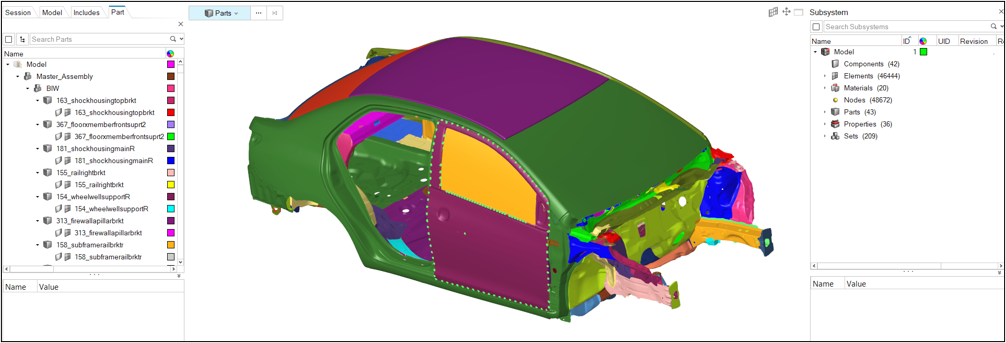

- From the Model Browser, double-click Include Files to open the Include Browser.
From the Assembly ribbon, select the
Parts tool to open the Part Browser.
Subsystems tool to open the Subsystem Browser.
Figure 3.
Left-click and drag the Subsystem Browser to the right side
of the screen as shown in Figure 4.

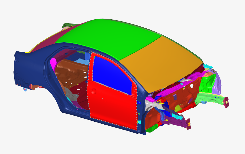

Create New Subsystems
- From the Part Browser, click the Front_Door_RH part assembly under and drag it into the Subsystem Browser.

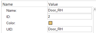

- From the Subsystem Browser, select the newly created subsystem named Subsystem1.
- From the Entity Editor, rename the new subsystem from Subsystem1 to Door_RH.
Set the UID to Door_RH.
Figure 5.
- From the Include Browser, right-click Subsystem1, select Rename from the context menu, and enter Door_RH.fm as the name.
From the Include Browser, click
Body.fem and drag it into the Subsystem Browser.

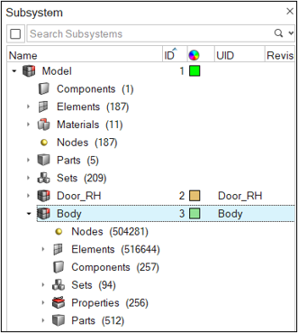

A new subsystem named Body has been created.
Figure 6.

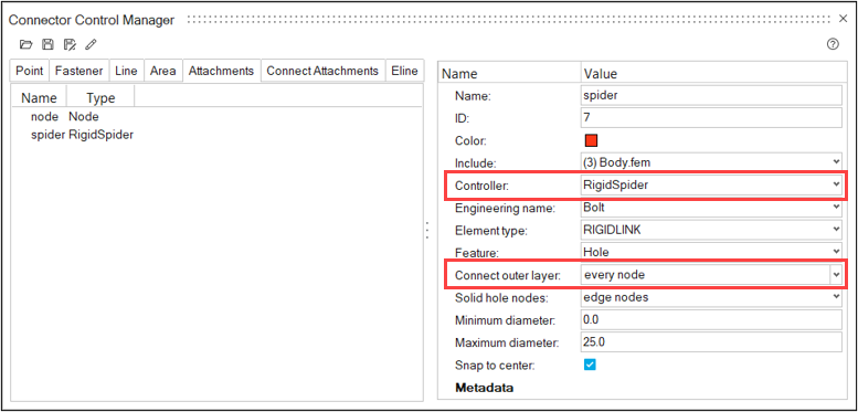

- In the Attachments tab of the Connector Control Manager dialog, click on spider.
- Verify that Controller is set to RigidSpider.
Change Connect outer layer to every node.
Figure 9.
Close the dialog.
In the Attachments guide bar, the control is set to spider.

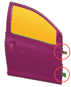

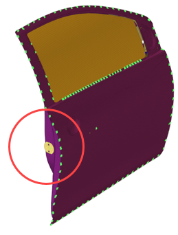

Zoom in on the locations shown in Figure 10 and Figure 11 and select the parts with holes.
Figure 10.
Figure 11.
From the guide bar, verify that the
Realize check box is selected and click
to create and realize the attachments.

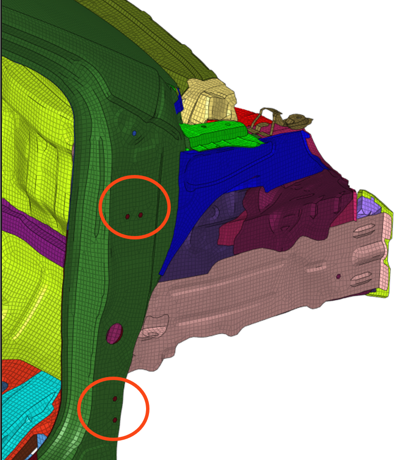

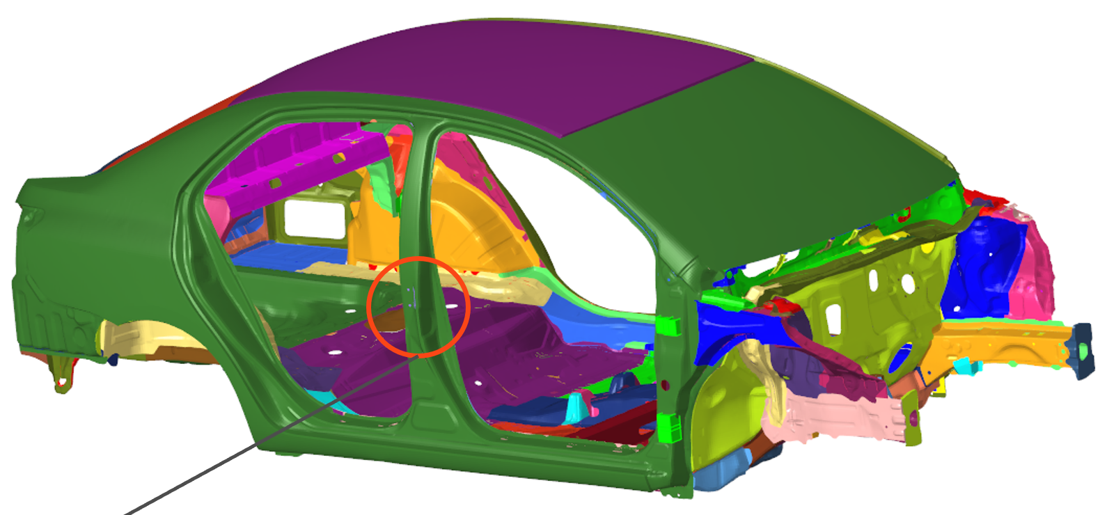

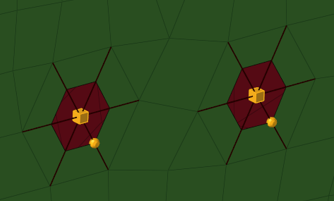

Zoom in on the locations shown in Figure 13 and select one node around each hole as shown in Figure 14 and Figure 15.
Figure 13.
Figure 14.
Figure 15.

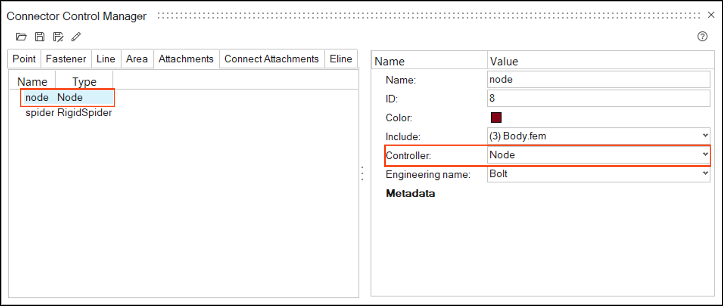

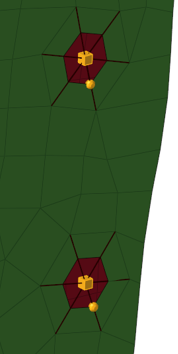

- From the guide bar, click spider and select Create New/Edit from the drop-down menu to open the Connector Control Manager dialog.
From the Attachments tab, click on node and verify
Controller is set to Node.
Figure 16.
Close the Connector Control Manager dialog.
In the Attachments guide bar, the control is set to node.
Zoom in on the locations shown in Figure 17 and select the nodes shown in Figure 18.
Figure 17.
Figure 18.

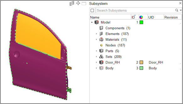

- From the Subsystem Browser, right-click on the Door_RH subsystem and select Show from the context menu.

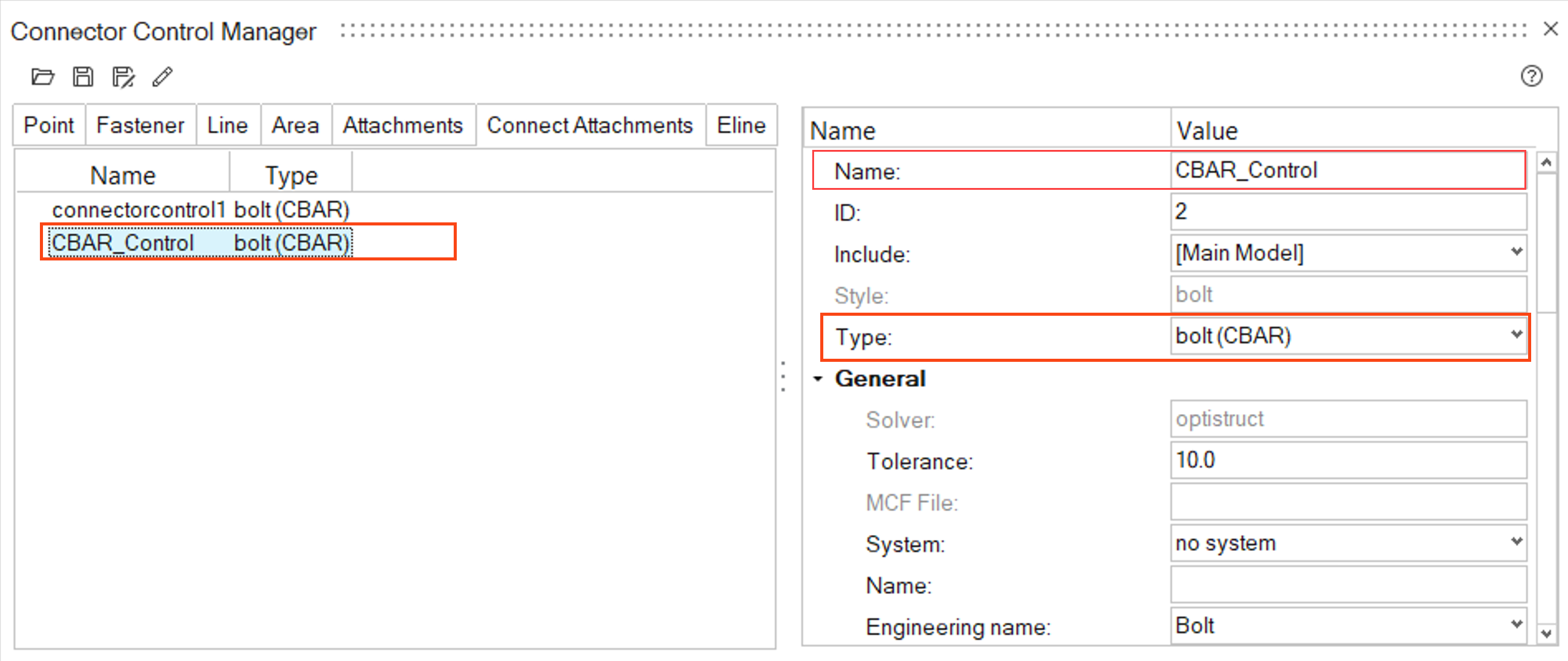

- From the guide bar, click Undefined and select Create New/Edit from the drop-down menu to open the Connector Control Manager dialog.
- From the Connect Attachments tab, right-click and select Create from the context menu.
- Rename the connector control to CBAR_Control.
Set Type to bolt(CBAR).
Figure 20.
Close the dialog.
In the guide bar, the control is set to CBAR_Control.

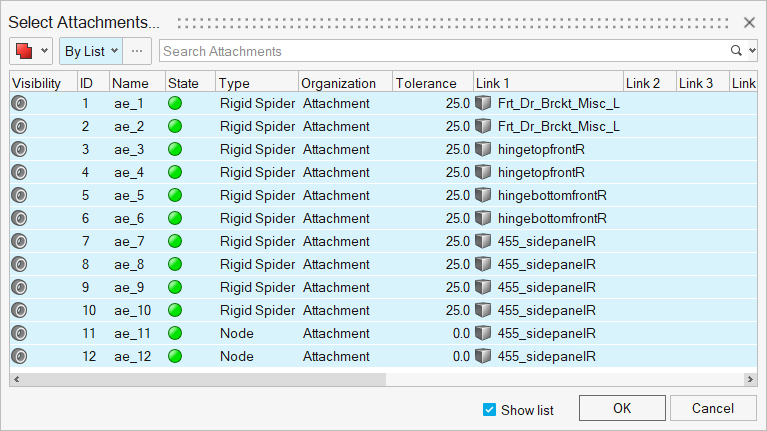

to open the Select Attachments dialog.
From the Select Attachments dialog, select all twelve
attachments and click OK.
Figure 21.

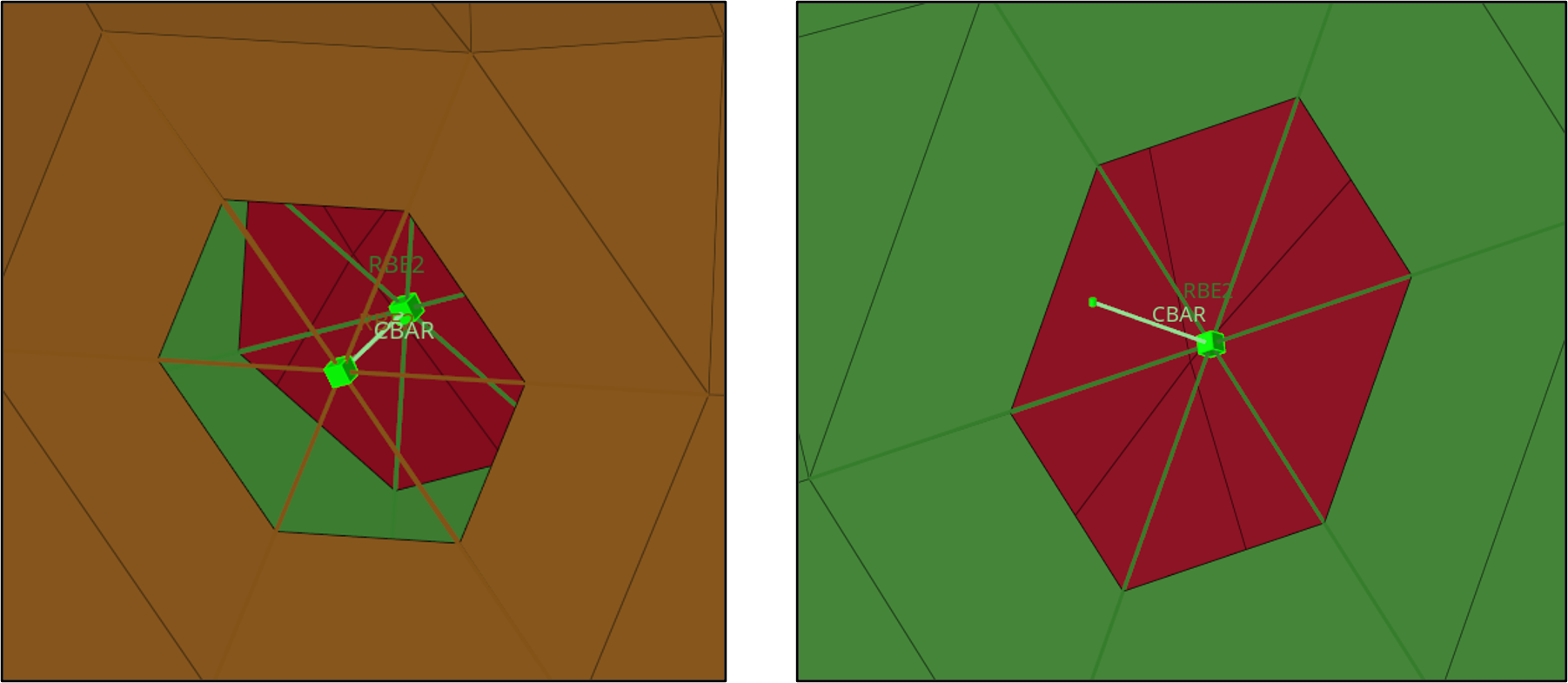

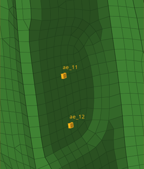

Zoom in on and review the attachments locations.
Figure 22.
There are CBAR elements connecting the doors and the body attachments.
Tip: For a better visualization of the CBARs, hide the Door_RH subsystem. - In the Subsystem Browser, right-click the new Subsystem connectors_1 subsystem and select Review from the context menu to see the connectors' locations.

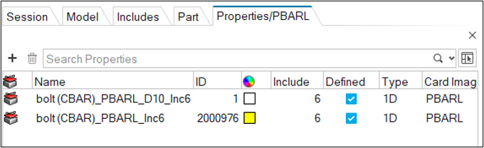

In the Properties Browser, review the newly created PBARL properties.
Figure 23.

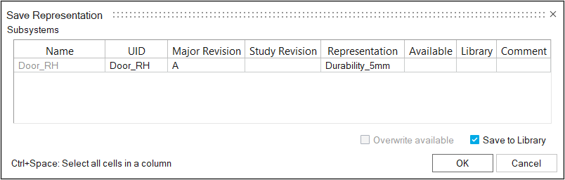

- From the Subsystem Browser, right-click on the Door_RH subsystem and select from the context menu.
- From the Save Representation dialog, verify that UID is set to Door_RH.
- Click the blank field under Major Revision and enter A.
Click the blank field under Representation and enter
Durability_5mm and click OK.
Figure 24.
The representation file is saved in the working directory. In the Subsystem Browser, the Representation column is filled with Durability_5mm for the Door_RH subsystem.

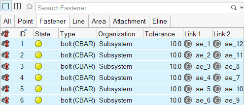

From the Connectors ribbon, select the
Connectors tool to open the Connector Browser.
Figure 25.
From the Fastener tab of the Connector Browser, select all
of the connectors.
Figure 26.
- Right-click and select Realize from the context menu.
- From the menu bar, click and save the file as Yaris_BIW_and_Door-REALIZED.hm.
