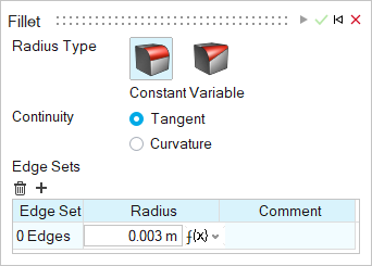

Fillet Edges
Round edges to create fillets with a constant or variable radius.
On the Geometry ribbon, select the
Fillet Edges tool.
Tip: To find and open a tool, press Ctrl+F. For more information, see Find and Search for Tools.The guide panel appears.
Choose a Radius Type:
- Constant: Create fillets with the same radius for every edge.
- Variable: Create fillets with a variable radius at selected points along the edges.
Choose a Continuity type:
- Tangent: Force tangent (G1) continuity along the edge.
- Curvature: Force curvature (G2) continuity along the edge.
Create and modify edge sets:
To Do this Add an edge set - Click the + button and select the edges.Tip: In the microdialog, select Tangent Propagation so that clicking an edge will also select all of its tangent edges.
To select all of the boundary edges of a face, click the face.
- You can adjust the Radius for each edge set.
