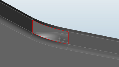

Close Holes: Examples
Example 1: Close Holes - Before
Example 1: Close Holes - After
Example 2: Close Between Edges -Before
Example 2: Close Between Edges - After
Example 3: Close Between Lines -Before
Example 3: Close Between Lines - After
