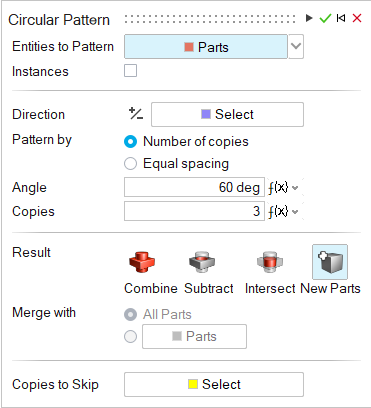

Circular Pattern
Pattern parts or faces around an axis.
On the Geometry ribbon, in the
Pattern tool group, select the Circular
Pattern tool.
Tip: To find and open a tool, press Ctrl+F. For more information, see Find and Search for Tools.The guide panel appears.
Choose the type of Entities to Pattern:
- PartsNote: To make all of the parts in the pattern instances of the original part, turn on Instances.
- Faces
- Parts
In the modeling window, select one or more parts or faces.
Note: To deselect a feature, hold down Ctrl while clicking. To clear all selected features, in the microdialog click Clear Selection.
Define the direction of the pattern:
- In the guide panel, next to Direction, click the Select button.
- In the modeling window, select a reference line, edge, or axis to which the pattern will be parallel.
- (Optional): To reverse the direction, click
in the microdialog.
Select a pattern method:
- Number of copies: Select this option to specify the Angle between each copy and the Number of Copies.
- Equal spacing: Select this option to equally space the copies within a specified Angle.
(Parts only) Adjust the pattern:
To Do this - Change the angle between each copy (Number of copies method)
- Specify the angle within which the copies are equally spaced (Equal spacing method)
Enter an Angle. Change the number of copies Enter the number of Copies. Pattern symmetrically about the selected center Turn on Symmetry. -
(Parts only) Choose a Result type:
- Combine: Combine the patterned parts with the existing parts.
- Subtract: Carve out the patterned parts from the existing parts.
- Intersect: Retain only the intersecting portions of the patterned parts and the existing parts.
- New Part: Create new parts from patterned parts.
(Parts only) If you selected Combine,
Subtract, or Intersect, choose
a Merge method:
- All Parts (default): Merge the patterned parts with all touching parts.
- Parts: Select the radio button to merge the patterned parts with selected parts. Then select the parts that you’d like to merge the patterned parts with.
- Optional:
Select the copies to skip:
- Next to Copies to Skip, click the Select button.
- Select the copies to exclude from the pattern.
- Click Apply.

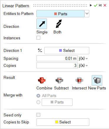

Linear Pattern
Pattern parts or faces in a linear direction.
Pattern tool group, select the Linear
Pattern tool.
- Faces
- Parts
Choose a Direction:
- Single (default): Create the pattern in one direction.
- Both: Create the pattern in both directions.
Define Direction 1 or Direction 2
of the pattern:
- In the guide panel, next to Direction 1 or Direction 2, click the Select button.
in the microdialog.
(Parts only) Adjust the pattern along Direction 1 or
Direction 2:
To Do this Change the distance between two copies In the microdialog, enter the Spacing. Change the number of copies In the microdialog, enter the number of Copies. Pattern symmetrically along direction 1 or 2 In the guide panel, for Direction 1 or 2, turn on Symmetry. -
Subtract, or Intersect, choose a
Merge method:
- Optional:
- (Optional): To pattern the entities only along the first row and first column, turn on Seed only.
- Click Apply.
