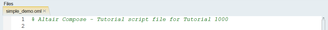

Select the file simple_demo.oml and click Open.

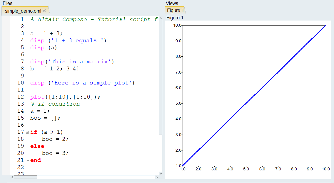

This opens a new tab in the Editor window titled simple_demo.oml. This tab is now the active tab, indicating that this file is the active file.
Click Run File,
, to execute the file simple_demo.oml.
After the script is run, results are displayed in the Command Window and Plot area. -
Click the expand icon,
, at the top right corner of the plot pane. The plot pane is lined up with the title Plots in the top left corner.
The plot pane is expanded to cover the Editor.
- Click the icon again (currently collapsed) to go back to the tiled display.
Similarly, expand the editor by clicking on its expand icon at the top right
corner of the Editor pane. The Editor panel is lined up with the title Files.
The editor is expanded to cover the plot.

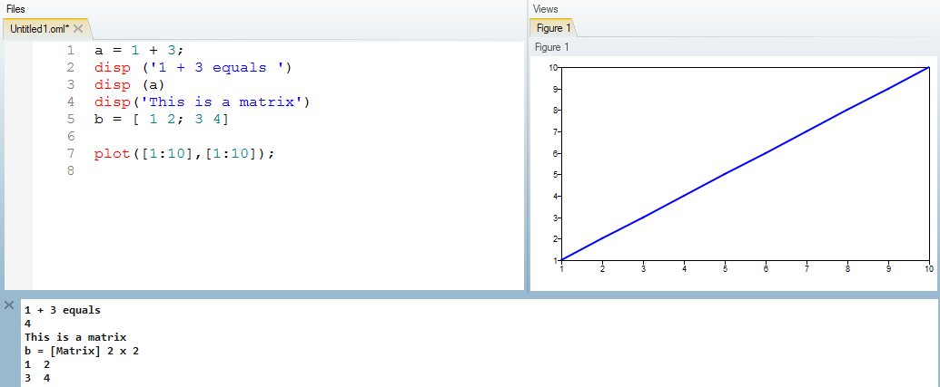

Creating an OML Script

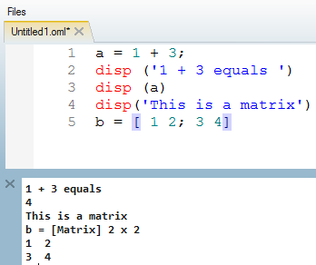

In the Editor window, type a = 1 +
3 and press Run.
If we type a ';' we can suppress this output.
You’ll notice that this time, nothing is displayed in the output yet there is the variable 'a' in the Variable Browser.
On the next line, type disp ('1 + 3 equals '); disp (a);
and then run the script.
This forces the output to display the value of 'a'.
Press Enter and then add the following two lines to
assign a matrix to '
b
' :disp('This is a matrix') b = [ 1 2; 3 4]
Without the '
' the matrix is displayed just like 'a
' was. Click Run again. The following is displayed: -
To create a simple plot, type plot([1:10],[1:10]); and
click Run.
A linear plot is displayed.

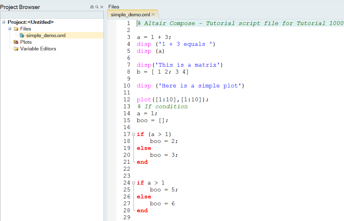

Managing a Project
By default, the Project Browser is displayed in the left pane. This helps you manage matrices, plots, and projects.
- Close all plots and files opened previously.
Right-click simple_demo.oml. The
simple_demo.oml file is added to the Project Browser.
and navigate to
Double-click the OML script to open it in the Editor.

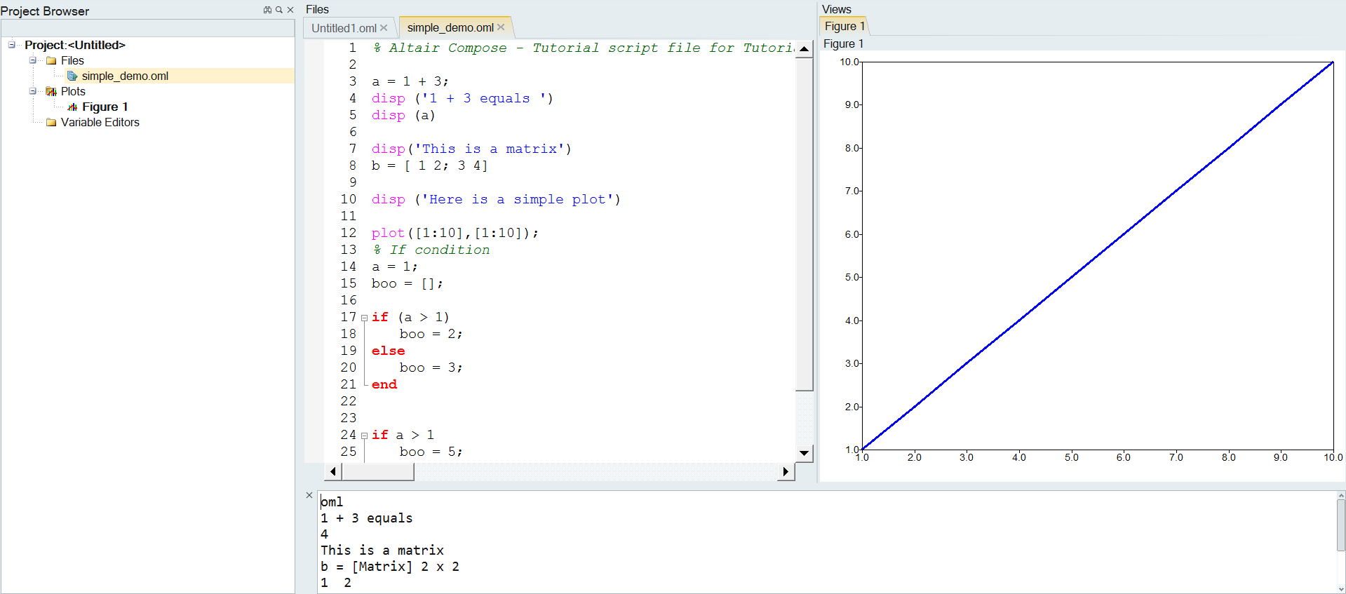

Run the file as previously outlined and you’ll notice that the plot
Figure 1 was added to the Plots.

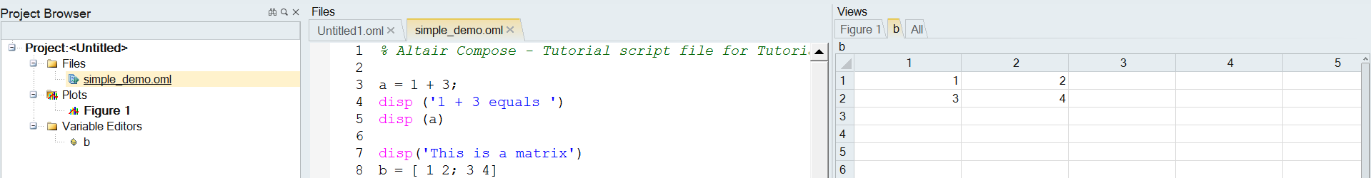

To add the Matrix Editors, navigate to
b
that we defined earlier. Notice now thatb
is added the Matrix Editors and can be modified by the matrix editor tile. and double-click the matrix variable
