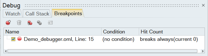

Click the Breakpoints tab, located next to the Call
Stack tab at the bottom of the GUI. Or, from the Debug menu, select .
A breakpoint is now listed and located at line 15.

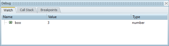

Variables can also be inspected using the Watch window.
The Watch window is located in the lower left corner of
the Compose GUI. In the Editor window, using the left mouse button, highlight the
variable boo, then drag the variable from the Editor window into the Watch window.
You can also highlight boo, then right-click to choose Add Selection to Watch.
The value of boo is currently 3.

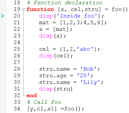

To enter the function
foo
, click the Step Into icon,.
Selecting Step Over executes the function
foo
. If you want to individually execute each line inside the functionfoo
, select Step Into instead.Once Step Into has been selected, the blue triangle moves to line 20.

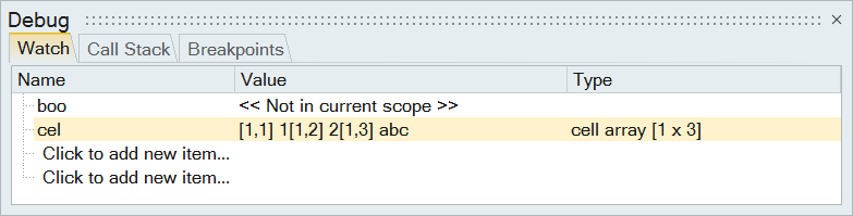

Under the Name column in the Watch window, type the
variable name cel.
The contents of the variable cel are updated in the Watch window. The Type column indicates that the variable cel is a cell and there are three elements in the cell. The values are listed in the Value column. You can also type cel in the OML Command Window to check the elements’ values:

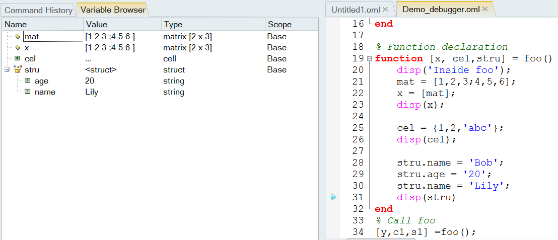

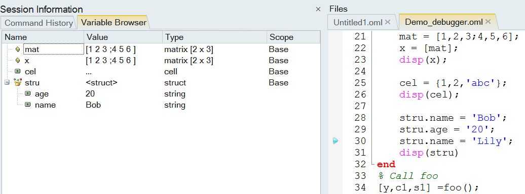

In the script, line 30 resets the stru’s name from ‘
Bob
’ to ‘Lily’
. As a result, the struct’s name field is updated accordingly. -
After running line 29, you can view the stru fields by clicking the
'+' in front of this struct in Variable Browser. The struct is now expanded and you can see
its content.
