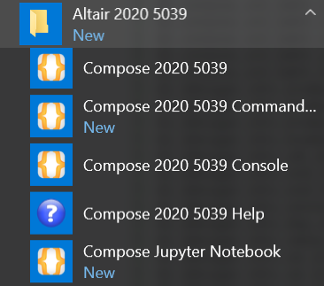

To open Compose in console mode, go to .

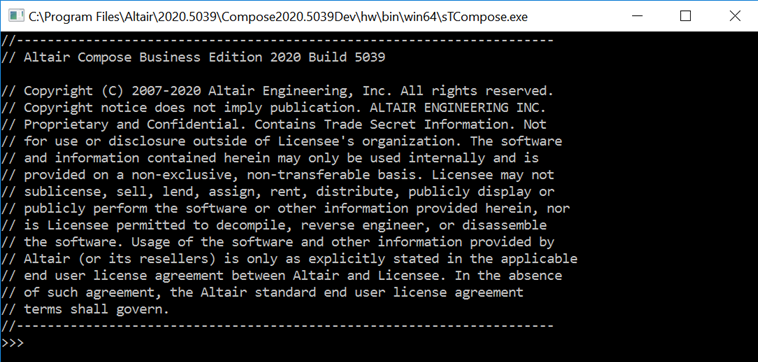

A command window with the Compose application
running in Console mode is open as shown below:

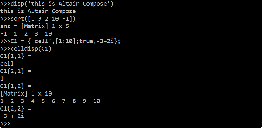

From here, all commands (except plot-related) are available. Type any command at the prompt and press ENTER to evaluate them immediately.

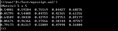

Assume a script named myscript.oml exists under D:/Test and contains these commands:
M1 = rand(5,5); disp(M1)
Run this in Console mode, and check the results:

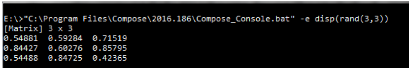

OML commands can be directly executed using the
–e option. Following the
Compose_Console.bat command, type –e "Any
valid OML command". For example:
Compose_Console.bat –e disp(rand(3,3))
This prints a 3x3 matrix in the command prompt:

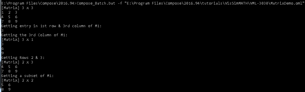

OML scripts can be directly executed using the
–f option. Following the .bat
command, type –f and the path to the file
MatrixDemo.oml. This should look like the
following:
Compose_Console.bat –f <installation_dir>\tutorials\MatrixDemo.oml
Press ENTER to run the file. Notice how all the output is displayed to the command prompt. Also, the output is the same as what was displayed in Compose in the OML Command window when the script file was evaluated.
