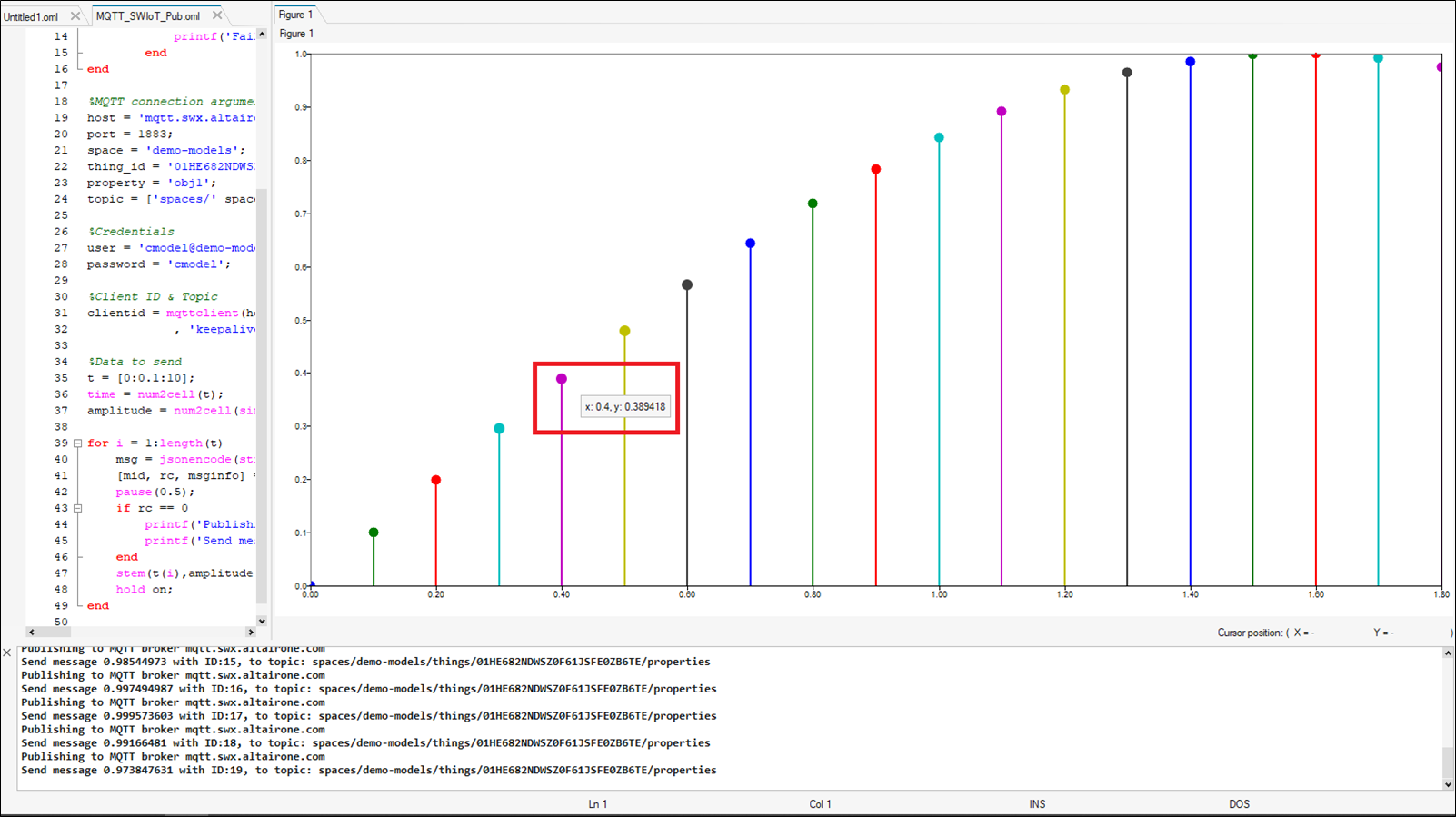

In this case, a simple sinusoidal wave signal is generated to be sent to the client.Note: Cells are used to be better manipulated further in the publishing section:t = [0:0.1:10]; time = num2cell(t); amplitude = num2cell(sin(t));
Create a loop to send the sinusoidal data individually. IoT Studio requires JavaScript Object Notation (JSON)
format on the data. For that, a function is used to manipulate the data
individually, accessing each cell member of the sinusoidal wave. Finally, a plot
is created, having 0.5 seconds as a pause condition, to see what is the data
that is sent:

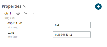

for i = 1:length(t) msg = jsonencode(struct(property, struct('amplitude', num2str(time{i}), 'time', num2str(amplitude{i})))); [mid, rc, msginfo] = mqttpublish(clientid, topic, msg, 2, true); pause(0.5); if rc == 0 printf('Publishing to MQTT broker %s\n', host) printf('Send message %s with ID:%s, to topic: %s\n',num2str(amplitude{i}),num2str(mid), topic) end stem(t(i),amplitude{i}); hold on; end
It is possible to see that the data sent from Compose is being received on IoT Studio using the MQTT protocol.

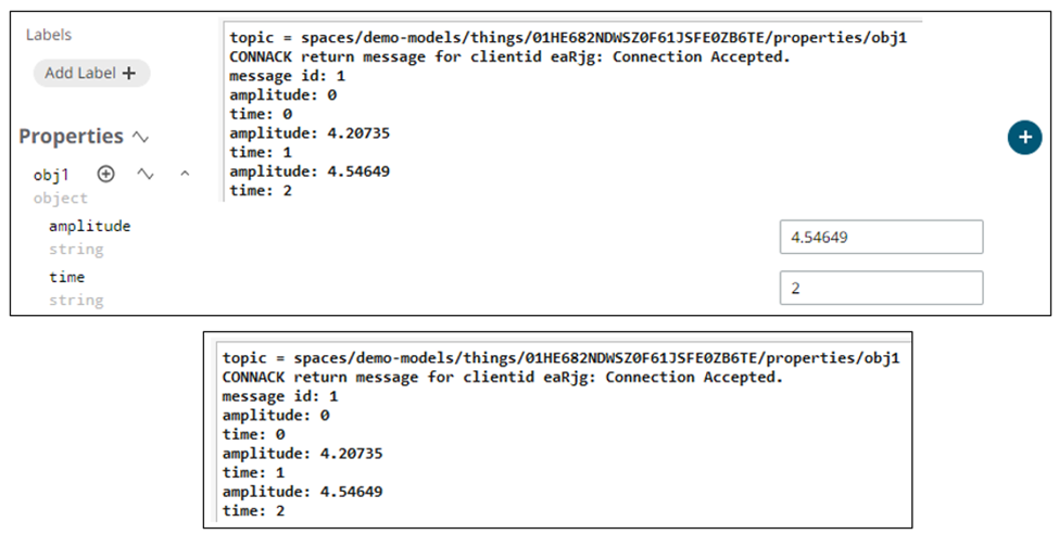

With all the setup done, subscribe to the broker and receive all the messages
that are sent to the IoT platfom:
[mid1, rc1, msginfo1] = mqttsubscribe(clientid, topic, 0);
Considering that Compose is subscribed to the topic, if any message is sent from one device to that topic, Compose receives it:It is possible to see that the data sent from IoT Studio is being received on Compose using the MQTT protocol.
