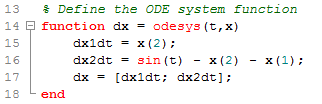

This is what our system function looks like, using x in the code for the vector [φ, ξ].
The system function implements the two equations derived above. The first argument is the current time, and the second argument contains the values of the state variables in a vector.

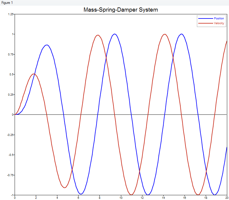

The time vector is reproduced as the first output argument. It is identical to the input for this case. The second output argument, x, contains the values of φ and ξ by column at each time in vector t.

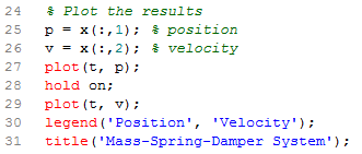

The following code extracts and plots the results.
For a spring-mass-damper system, the plot represents the position and velocity. For the RLC circuit, the plot represents the current and its rate of change.
