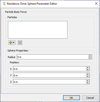

are to be measured, you can define the parameters as follows:
In this example, you are defining a sphere to track the Custom Residence Time.

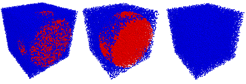

In this example, the particle of type New Particle 1 inside the described sphere is the only particle to meet both criteria. As a result, it is the only particle whose Custom Residence Time value will be increased.
The results are as follows:
