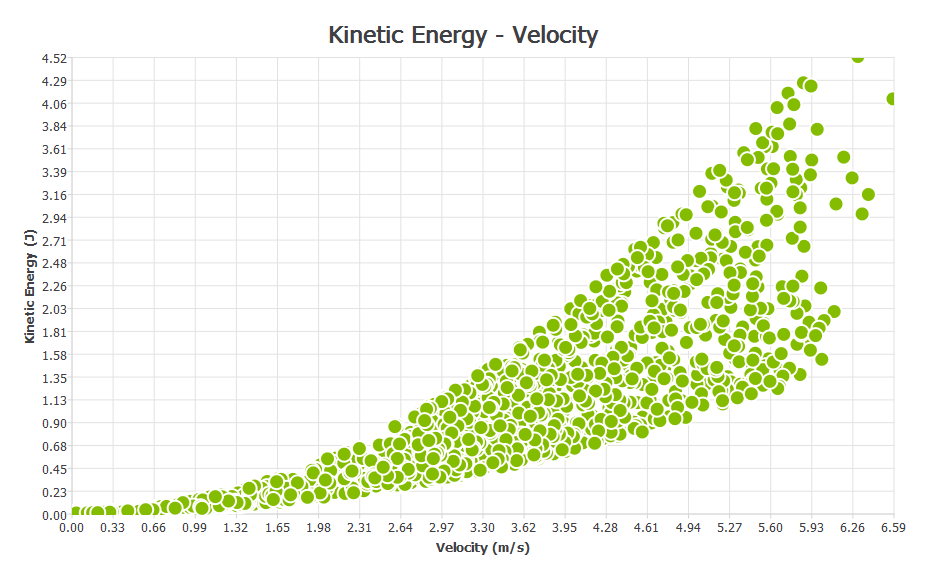

A wide scatter of the plots denotes poor correlation between the two
variables. If the two variables are perfectly correlated, then all the
plots will fall on the diagonal (regression line), such as the velocity
of a set of particles vs kinetic energy.
In this Scatter graph, the kinetic energy is higher with greater particle
velocity, and the distribution of energy is due to the particle size
distribution.
