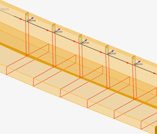

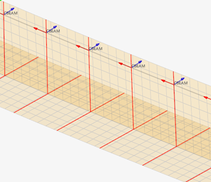

- Cut per element
- Automatically perform a section cut on each target element. As
explained in Orientation and Offset, the resultant section is valid per element no matter its
orientation. The intersection is done by default on the midpoint
of the target element. You can set a value (0 to 1) to specify
the parametric position between the target element’s nodes
(Figure 4). The orientation can’t be changed. The
plane is normal to the target’s X axis.
