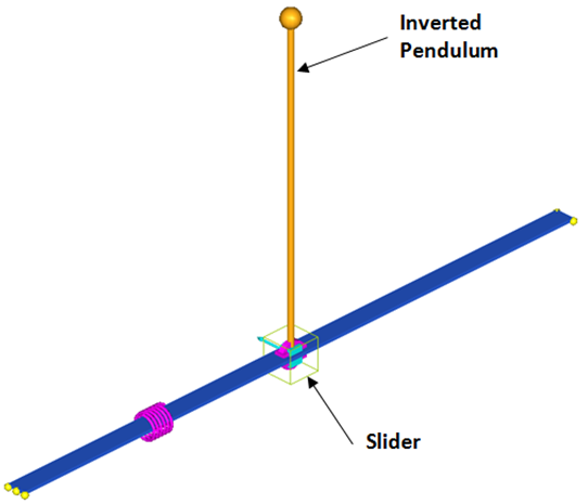

You want to find a full-state feedback control law to achieve the goal. The control input is a force applied to the slider along the global X-axis. Plant output is the pendulum angle of rotation about the global Y-axis.
Start by loading the file inv_pendu.mdl, located in the mbd_modeling\motionsolve folder, into MotionView. Upon examination of the model topology, you will notice that everything needed for this exercise is already included in the model. However, depending on which task you are performing, you will need to activate or deactivate certain entities.

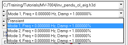

Click Animate.
The result animation H3D will be loaded in the adjacent window.
From the Results Browser select individual modes.
Click Start/Pause Animation
to visualize the mode shape.

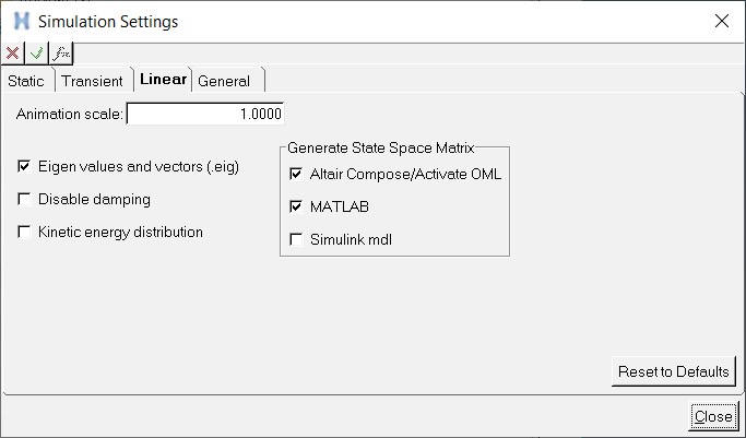

Figure 3. Linear Tab in Simulation Settings Dialog for Specifying the MATLAB Matrix Files Output
- From the Simulation Settings dialog, click the Linear tab and select the MATLAB option under the Generate State Space Matrix section.
From the Main tab, click Run.
You should get six new files with base name inv_pendu_state_matrices and extensions .a, .b, .c, .d, .pi, and .po. The .pi and .po files contain information about the input and output variables.

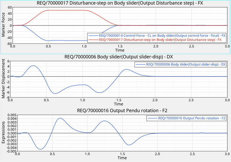

Once the job is completed, close the solver window and plot the following
results in a new HyperGraph page using
inv_pendu_dyn.abf.
Output Y-Type Y-Request Y-Component control force Marker Force REQ/70000014 Control Force - CL on Body slider(Output control force - final) FX disturbance force Marker Force REQ/70000017 Disturbance-step on Body slider(Output Disturbance step) FX slider displacement -X Marker Displacement REQ/70000006 Body slider(Output slider-disp) DX pendulum angular displacement Expressions REQ/70000016 Output Pendu rotation F2 The plots of disturbance force, control force, slider x displacement, and pendulum angular displacement are shown below.Figure 4. Plots of Disturbance and Control Forces as well as Slider Translational and Pendulum Angular Displacements
