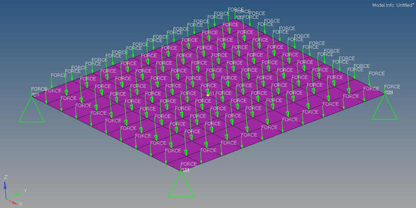

The FE Input file corresponding to the plate and the distributed load is shown in Figure 2.
- Five interface nodes, four corner nodes (1, 11, 111, 121) and one center
node (61) were defined
ASET1 123 111 121 1 11 ASET1 123456 61
- Point load is applied on all nodes as follows
- Force of 253.36 N is applied along the negative Z-axis on the corner nodes
- Force of 506.72 N is applied along the negative Z-axis along the nodes on the edge of the plate
- Force of 1013.4 N is applied on all the internal nodes
FORCE 7 56 01.0 0.0 0.0 -506.72 FORCE 7 67 01.0 0.0 0.0 -506.72 FORCE 7 78 01.0 0.0 0.0 -506.72 FORCE 7 89 01.0 0.0 0.0 -506.72 FORCE 7 100 01.0 0.0 0.0 -506.72 FORCE 7 11 01.0 0.0 0.0 -253.36 FORCE 7 1 01.0 0.0 0.0 -253.36 FORCE 7 121 01.0 0.0 0.0 -253.36 FORCE 7 111 01.0 0.0 0.0 -253.36

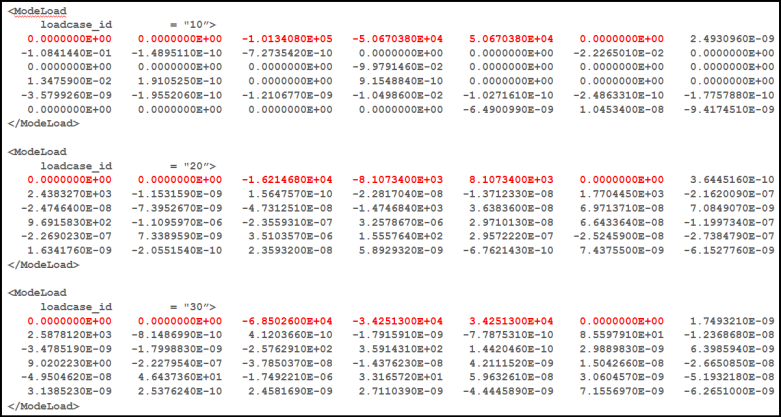

The ModeLoad section in the Reference_FlexData block of the MotionSolve XML input file specifies the different load-cases that are available for use. The plate model has 3 load cases. Each load case has an ID or an index.
- When the ModeLoad data is obtained from an Adams MNF, the load case index is available.
- When the data is obtained from a Flex H3D file, the load case ID is available. In this example, the load-case was obtained from OptiStruct, so a load case ID is available for use.
The load case represents a load shape, it needs to be scaled by a scale factor to obtain the true load on the plate. Each load case consists of 6+N numbers.
- The first 6 numbers, highlighted in yellow-red, are the rigid body loads. For the plate model, FZ, TX and TY are non-zero.
- The next N numbers are the contribution to equations of motion for each mode. The plate was characterized by 42 modes, so N=42 for this example.

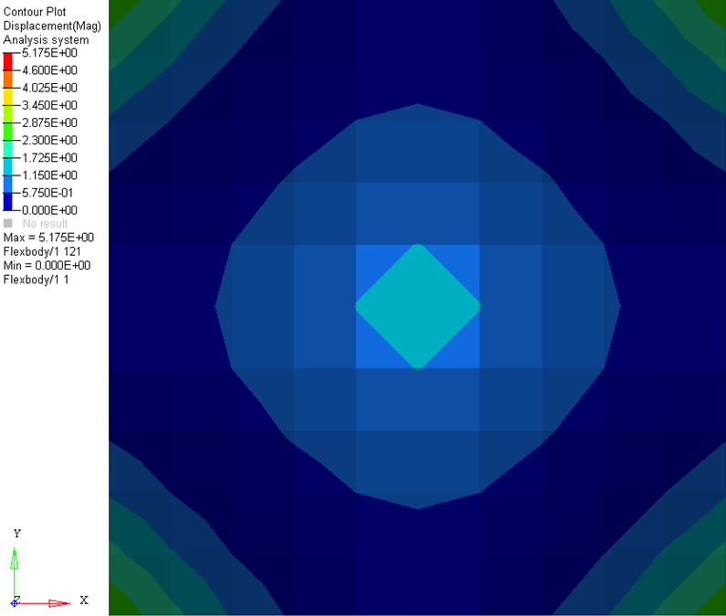

Figure 4 shows the deformation contour of the plate at T=0.45s.
