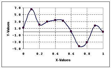

The following example depicts an experimentally measured steering wheel angle versus time profile that is to be used in a motion definition. The data is embedded directly in the XML input file. The abscissa (x-value) represents simulation time and the ordinate (y-value) represents the steering wheel angle.
<Reference_Spline
id = "301001"
num_x = "11">
0.00E+00 1.09E+00
1.00E-01 6.88E+00
2.00E-01 2.52E+00
3.00E-01 3.02E+00
4.00E-01 3.30E+00
5.00E-01 3.23E+00
6.00E-01 -8.91E-02
7.00E-01 -4.20E+00
8.00E-01 -3.00E+00
9.00E-01 2.05E+00
1.00E+00 0.04E+00
</Reference_Spline>
