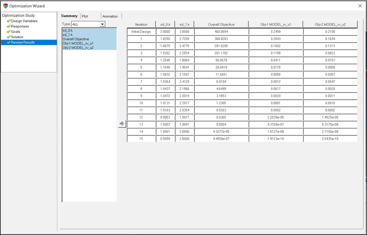

Navigate to the Review Results page.
The Summary tab appears that lists the history of design variables,
responses and objective functions in a tabular format for each iteration of
optimization run.
Note:MotionSolve uses SLSQP
algorithm for optimization. Hence the last iteration is usually the optimum
configuration with least value of cost function. See Figure 9. Figure 9. Summary tab listing cost function (objective), response variables
and design variables

values are set to the values in the iteration number you
choose.
