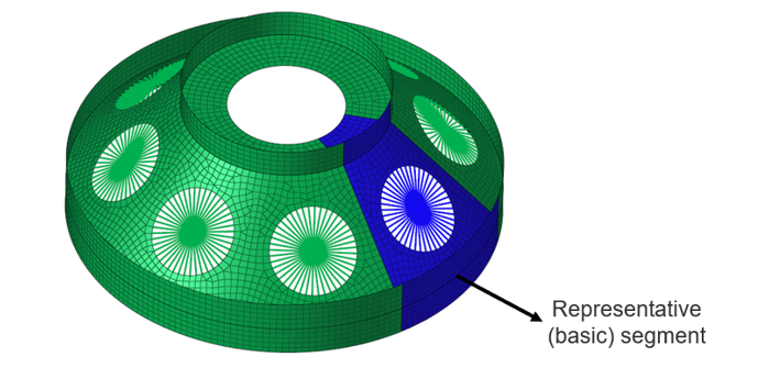

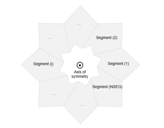

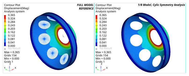

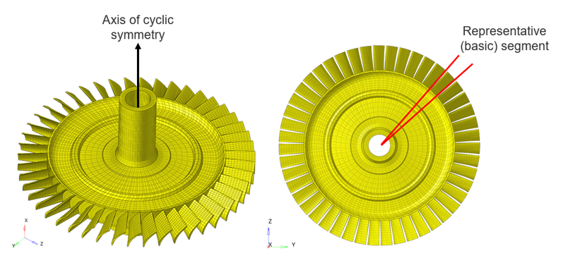

Cyclic symmetry is a type of symmetry in which a representative (or basic) segment, if patterned circularly about an axis of symmetry would result in the full model.
Structures with symmetry can often be modeled with one representative entity, from which the full structure can be obtained after certain operations (pattern, mirror, rotation, etc.). Such methods can lead to huge savings in modeling effort, computational time, and file storage. Therefore, exploiting symmetry in finite element models could prove to be very advantageous.
- The basic segment could either be the smallest repeating unit in the model or could involve several repeating units.
- Depending on your requirements, a full 360 degree model or a partial (as in, 270 degrees) model could be analyzed by suitably specifying the number of segments in the model definition.

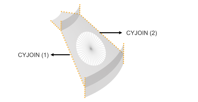

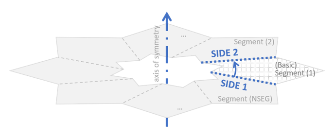

In a cyclic symmetry analysis, the boundaries on either side of the modeled base segment which are to be connected to adjacent segments are defined as SIDE 1 and 2. The direction of the axis of symmetry are determined using the right-hand thumb rule.
In a cyclic symmetry analysis, the response of the full model is determined from a linear combination of several independent basic responses, known as solution harmonics. They are represented using indices called harmonic indices and they could be selected during the modeling process.
The harmonic indices are supposed to be non-negative and must be no greater than (NSEG is the number of segments to be modeled).
