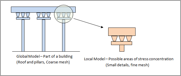

In Figure 1, an example building is illustrated wherein sections containing the pillar-roof joint are modeled as separate submodels with a refined mesh. The finer mesh allows for better accuracy at regions with high stress concentrations. Using the Global-Local Analysis capability, the results from the coarser global model are interpolated and applied to the finer mesh of the local model at the cut surface. This allows for the local model to be driven by the results of the global model.
