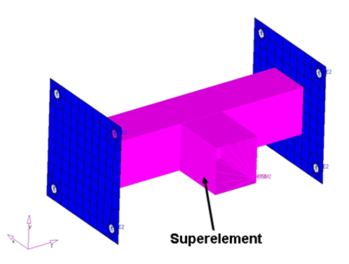

A superelement is a reduced representation of the behavior and performance of a structure or a part of a structure.
DMIG is the acronym for Direct Matrix Input at Grid points. This matrix is defined by a single header entry and one or more column entries. The DMIG Bulk Data Entry can be used to directly define matrices to be included in the model (such as stiffness and mass matrices). DMIG entries can be selected in the case control section using K2GG, M2GG, B2GG entries and so on for inclusion in the model.

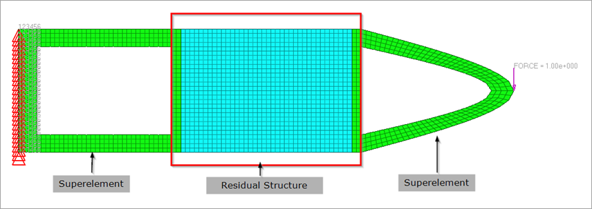

Residual Structure
The part of the full model that remains after the superelement has been created is the Residual structure (or simply, Residual).

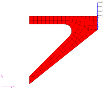

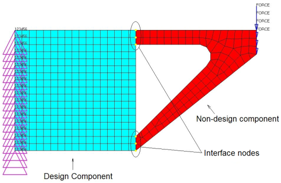

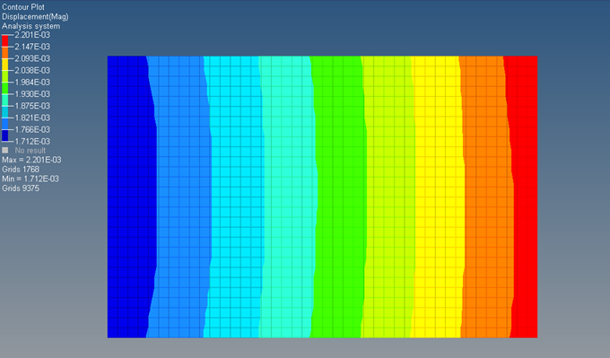

Example 1: Static Condensation
First of all, a linear static analysis is performed on the complete structure. The displacement and von Mises stress results from this analysis (Figure 12).
All of the degrees of freedom at the interface nodes (Figure 10) are selected as boundary degrees
of freedom. ASET or
ASET1 Bulk Data Entries are
used to indicate this. The reduced matrices output
is requested through the inclusion of the
PARAM,EXTOUT,DMIGPCH
Bulk Data Entry. The model is submitted to
OptiStruct, resulting
in the creation of the file
filename_AX.pch which contains
the reduced matrices in ASCII format. (Had
PARAM,EXTOUT,DMIGBIN
been used, the reduced matrices would be written
in binary form to the file
filename_AX.dmg).
- Delete the Bulk Data Entries for the nodes and elements of the non-design component.
- Delete all loads and boundary conditions that were only applied to the non-design component.
- Include the file containing the reduced matrices in the Bulk Data section.
- Select the reduced stiffness matrix with the Subcase Information Entry K2GG. (In this example, the reduced stiffness matrix will have the default name KAAX).
- Select the reduced load vector with the Subcase Information Entry P2G. (In this example, the reduced load vector will have the default name PAX).

Component Dynamic Analysis (CDSMETH) Superelement Generation
The CDS superelement should be used when it is anticipated that a large number of residual runs will be made on a very large model at the higher end of the frequency range of study.
For example, this approach should be used when studying a variety of inputs on an automobile model in the frequency range of 400 to 800 Hz. For the residual analysis to run as fast as possible, all components, except very small ones, should be converted into CDS superelements. The major limitation of this approach is that it takes longer to generate the CDS superelements than with the other superelement creation methods. Also, the analysis must be performed at the fixed set of frequencies specified when the CDS superelement is formed. The major benefit of the CDS superelement is that the residual run will be much faster than with superelements created by other methods.
For an example of the body CDS superelement generation, see the input data for a body-in-white below. The special data for this input are the case control data: CDSMETH = 1; the FREQ card which restricts the residual analyses to just those frequencies; the CDSMETH data (see the CDSMETH card definition); and the BNDFREE data which defines the exterior points on the component.
CDS Body Super Element Example
MODEL = NONE
TITLE = BODY-IN-WHITE CDS MODEL
SUBCASE 1
FREQUENCY = 1
METHOD = 2
CDSMETH = 1
BEGIN BULK
$==01==><==02==><==03==><==04==><==05==><==06==><==07==><==08==><==09==><==10==>
FREQ1 1 1.0 0.2 94
FREQ1 1 20.0 0.5 159
FREQ1 1 100.0 1.0 99
FREQ1 1 200.0 2.0 200
EIGRA 2 1000.0
CDSMETH 1
BNDFREE1 123456 1000000 through 1006001
INCLUDE '/MODELS/BODY/BODYNEW.dat'
ENDDATA
CDS superelement is saved in the file: XXX_CDS.h3d
The interface points (exterior points) are where the component is attached to another superelement directly or to the residual structure. These interface points must be independent degrees of freedom. If they are the dependent point of an RBE3, they must be made independent by transferring the dependencies to one of the independent grids referenced by the RBE3 element using UM data on the RBE3 definition, or use PARAM,AUTOMSET,YES. In the Bulk Data Entry section on the RBE3 element, the UM parameter shows how to redefine the dependency. The RBE3 can also be changed to an RBE2, but this could stiffen up the local area as a result.
In order to be formed into a superelement, a component FEA model has to be complete. All grids referenced in the superelement must be in the component model file. This includes local coordinate systems grids. All properties and material referenced in the components must also be included in the component. The component model must be able to be run successfully by itself in a modal analysis run.
The OSET field on the CDSMETH entry can be used to recover responses from the interior grids of the CDS superelements.
