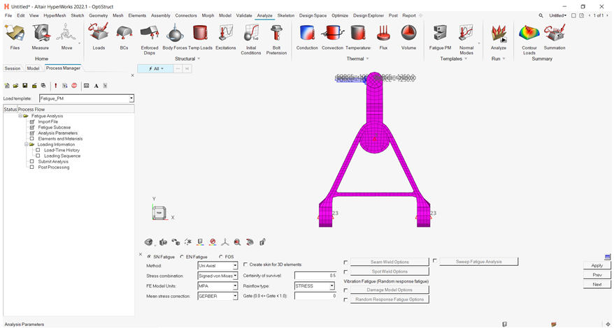

Apply Fatigue Analysis Parameters
- Make sure the task Analysis Parameters is selected in the Fatigue Analysis tree.
- Select the following options:
- Analysis type
- S-N
- Stress combination method
- Signed von Mises
- FEA model unit
- MPA
- Mean stress correction
- GERBER
- Rainflow type
- STRESS
- Enter the following values:
- Certainty of survival
- 0.5
- Gate
- 0.0
Click Apply.
This saves the current definitions and guides you to the next task Elements and Materials of the Fatigue Analysis tree. For details, consult the Altair HyperWorks 2024 help.

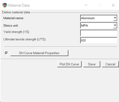

Click Add Material.
A Material Data window opens.
Figure 10. Material Data Definition
- For Material name, select Aluminum.
- Make sure Stress unit is set to MPA.
- For Ultimate tensile strength (UTS), enter 600.

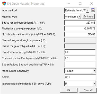

Click SN Curve Material Properties.
An SN Curve Material Properties dialog opens.
Figure 11.
- For Input method of defining S-N curve, select Estimate From UTS.
Click the Show SN curve definition icon
An SN method description window introducing how to generate the SN material parameter opens. - Click Close.
For Material type, select Aluminum Alloys and click
Estimate.
All the data for SN curve definition are automatically estimated.
- Click OK.

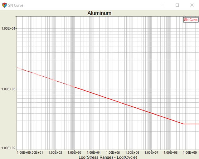

Click Plot SN Curve at the bottom of the window to show
the SN curve.
Figure 12.

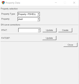

Click Add Property.
A Property Data dialog opens.
Figure 13.
- For Property Type, select Property - PSHELL.
For Property name, select shell.
This is the skin coating the solid control arm.
- Click Create to create PFAT property.
- For LAYER, select TOP.
- For FINISH, select NONE.
- For TREATMENT, select NONE.
- Leave the field after KF (Fatigue strength reduction factor) set at 1.0.
- Click Close to save the definition of the SN data for the selected property.
Click Close in the Property Data dialog to save the
fatigue definition.

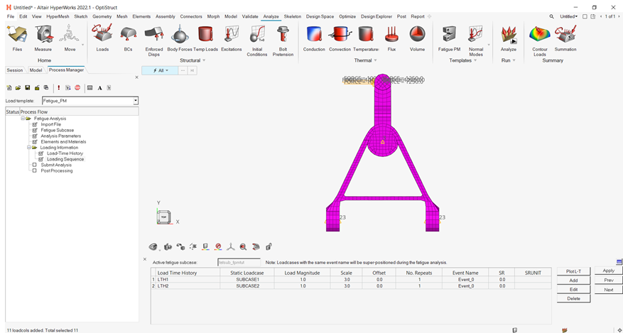

Load Sequences
- Make sure the task Loading Sequences is selected in the Fatigue Analysis tree.

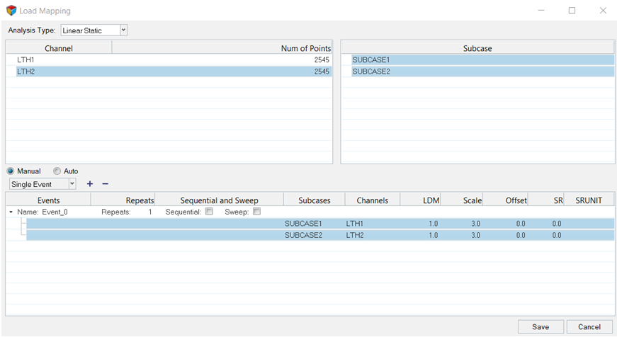

Click Add.
A Load Mapping window opens.
- For Channels, select LTH1 and LTH2.
- For Subcase, select SUBCASE1 and SUBCASE2.
- Activate the radio button Auto and leave the event creation method set to default Single Event.
- Click + to create a single event with two subcases and two channels.
Set Scale to 3.0, as shown below.
Figure 17. Load Mapping to associate load-time history with static subcase
Click Save to close the window and create the fatique
event using selected subcases and channels.
Figure 18. Loading Sequences Definition

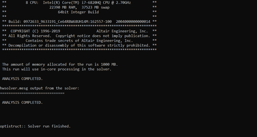

Click Submit.
This launches OptiStruct 2024 to run the fatigue analysis. If the job is successful, the new results files should be in the directory from which ctrlarm_fpmtut.fem was selected.The default files written to the directory are:
ctrlarm_fpmtut.0.3.fat An ASCII format file which contains fatigue results of each fatigue subcase in iteration step. ctrlarm_fpmtut.h3d Hyper 3D binary results file, with both static analysis results and fatigue analysis results. ctrlarm_fpmtut.out OptiStruct output file containing specific information on the file set up, the set up of your fatigue problem, compute time information, etc. Review this file for warnings and errors. ctrlarm_fpmtut.stat Summary of analysis process, providing CPU information for each step during analysis process. Note: The filename.#.fat is created for each fatigue subcase at the first and last iterations only if a fatigue optimization is performed.Figure 19. Submit Fatigue Analysis

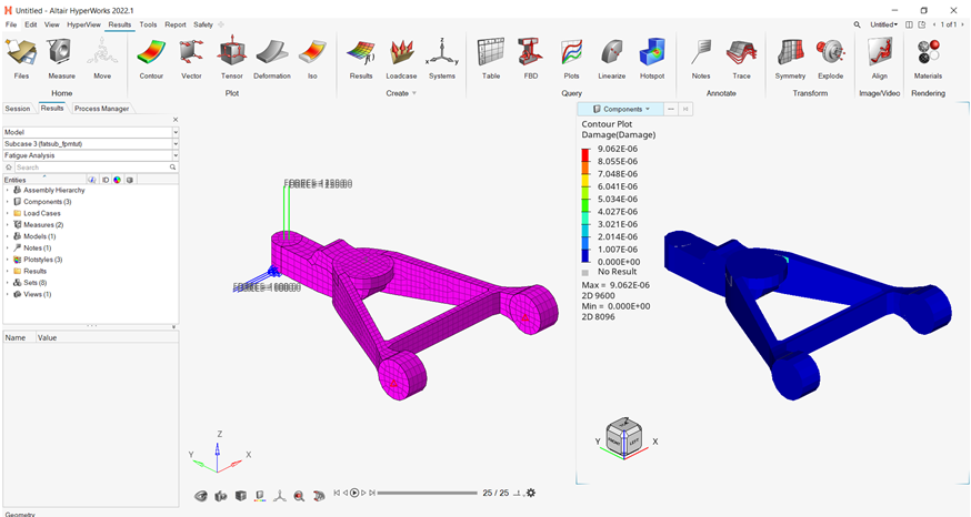

Post-process the Analysis
Make sure the task Post-processing is selected in the Fatigue Analysis
tree.
When fatigue analysis has completed successfully after the previous submit, it will automatically go into this task.
- For Fatigue subcase, make sure Select Subcase is selected.
- For Result Type and Data Component, select the required data you want to contour from the drop-down menu.
Click Load H3D Results (HV).
This launches HyperView and loads the ctrlarm_fpmtut.h3d results file. It applies the result contour for selected result type and component. You can use HyperView for more detailed results.
Click Exit to unload Fatigue Process Manager.
Figure 21. Post-Processing
Figure 22. Damage Contour in HyperView
