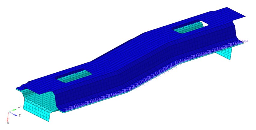

The model being used for this exercise is that of an automotive frame. The fem file consists of the 3 static load steps to which the frame is subjected to – Frontal torsion, Rear torsion and the Vertical Bending.

Figure 2. Fatigue Setup - Spot Welds

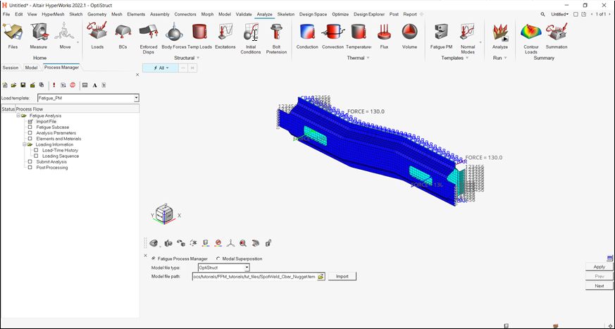

Import the Model
- Make sure the task Import File is selected in the Fatigue Analysis tree.
- For the Model file type, select OptiStruct.
Click the Open model file icon
A Select File browser window opens. - Select the Spotweld_CbarNugget.fem file you saved to your working directory and click Open.
Click Import.
This loads the control arm model. It includes a whole definition of two static subcases, elements sets, and material static properties, etc.
Click Apply.
This guides you to the next task Fatigue Subcase of the Fatigue Analysis tree.
Figure 3. Import a Finite Element Model file

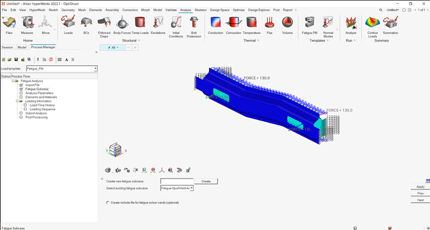

Set Up the Model
Create a Fatigue Subcase
- Make sure the task Fatigue Subcase is selected in the Fatigue Analysis tree.
- In the Create new fatigue subcase field, enter Fatigue-SpotWeld-Analysis.
- Click Create.
For the Select existing fatigue subcase field, select the newly created fatigue
subcase Fatigue-SpotWeld-Analysis.
Fatigue-SpotWeld-Analysis is selected as the active fatigue subcase. Definitions in the following processes (analysis parameters, fatigue elements and properties, loading sequences, etc.) will be for this subcase.
- Optionally, you can choose to create all fatigue solver cards (such as FATPARM, FATDEF, FATEVNT, PFAT etc. that are created in subsequent steps) in a separate include file. For this, you should select the check box Create include file for fatigue solver cards (optional).
Click Apply.
This saves the current definitions and guides you to the next task Analysis Parameters of the Fatigue Analysis tree.
Figure 4. Create and Select Active Fatigue Subcase to Process

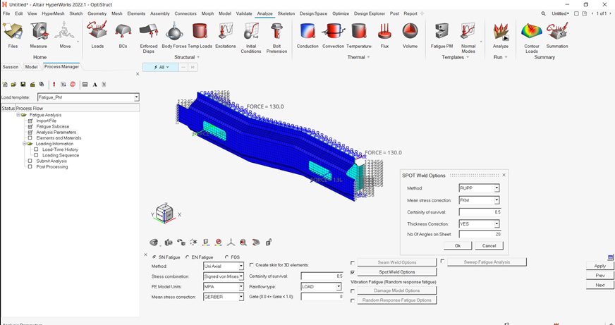

Apply Fatigue Analysis Parameters
- Make sure the task Analysis Parameters is selected in the Fatigue Analysis tree.
- Select the following options:
- Analysis type
- S-N
- Stress combination method
- Signed von Mises
- FEA model unit
- MPA
- Mean stress correction
- GERBER
- Rainflow type
- LOAD
- Enter the following values:
- Certainty of survival
- 0.5
- Gate
- 0.0
Check the box for Spot Weld Options.
Select the follow options from the dialog.
- METHOD
- RUPP
- Mean Stress Correction
- FKM
- 0.5
- THCKCORR
- YES
- NANGLE
- 20
Click Apply.
This saves the current definitions and guides you to the next task Elements and Materials of the Fatigue Analysis tree. For details, consult the Altair HyperWorks 2024 help.
Figure 5. Fatigue Analysis Parameters Definition

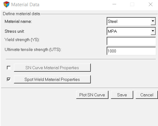

- For Material name, select Steel.
- Make sure Stress unit is set to MPA.
- For Ultimate tensile strength (UTS), enter 1000.

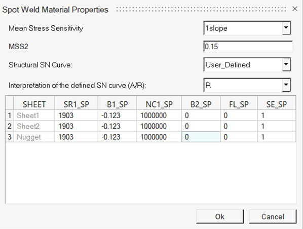

Activate Spot Weld Material
Properties, then click Spot Weld Material
Properties.
Figure 6. Material Data Definition
Enter the values for Mean Stress Sensitivity, MSS2, Structural SN Curve along
with bending and membrane SN curve material values.
Figure 7. Spot Weld Material Properties dialog
- Click OK.

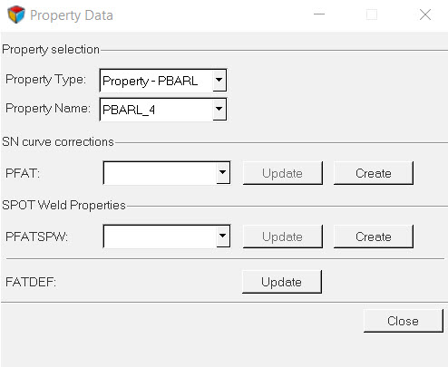

Click Add Property.
Figure 8. Property Data dialog
- For Property Type, select Property - PBARL.
- For Property Name, select PBARL_4.
- Click Close to save the definition of the SN data for the selected property.

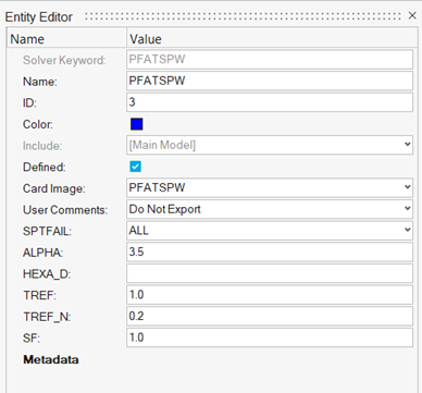

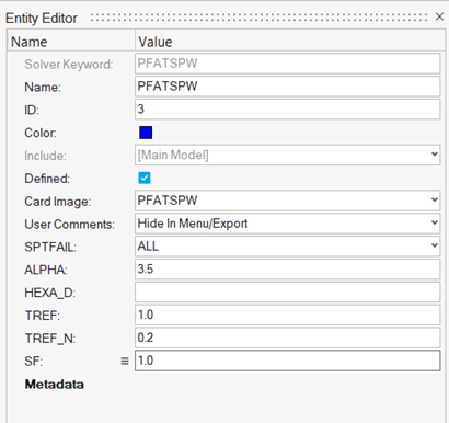

Define PFATSPW Property
This saves the current definitions and guides you to the next task Load-Time History of the Fatigue Analysis tree.
Click Create button next to PFATSMW.
A PFATSMW Entity Editor dialog opens.
- For Name, enter PFATSPW.
- For Card Image, select PFATSPW.
- Set SPTFAIL to All.
- Set ALPHA to 3.5.
- Set TREF to 1.0.
Set TREF_N to 0.2.
Figure 9. PFATSPW Dialog
- Set SF to 1.0.
- Click Close.

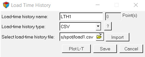

Apply Load-Time History
- Make sure the task Load-Time History is selected in the Fatigue Analysis tree.
Click Add by File.
A Load Time History window opens.
- For Load-time history name, enter LTH1.
- For Load-time history type, select CSV.
Click the Open load-time file icon
An Open file browser window opens. - Browse for load1.csv.
- Click .
Click Save to write the new load-time history into
HyperMesh database.
Figure 11. Import Load-Time History
- Click Plot L-T to show the load-time history.
- Close the Load Time History window.
Click Apply.
This saves the current definitions and guides you to the next task Loading Sequences of the Fatigue Analysis tree.
Figure 12. Load-Time History Definition

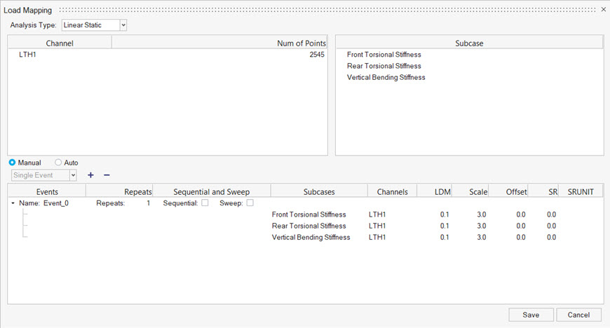

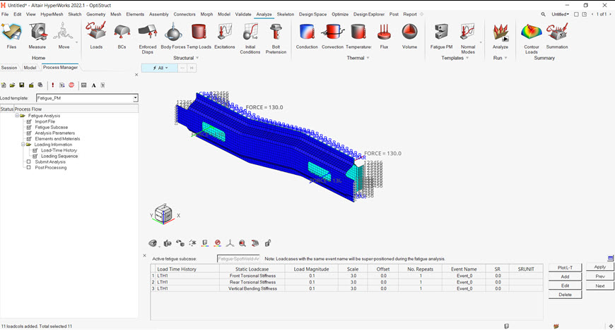

Load Sequences
- Make sure the task Loading Sequences is selected in the Fatigue Analysis tree.
Click Add.
A Load Mapping window opens.
- For Channels, select LTH1.
- Activate the radio button Manual and leave the event creation method set to default Single Event.
- Click + button to create a single event with three subcases and two channels.
- Drag and drop the three subcases (Front Torsional Stiffness, Rear Torsional Stiffness and Vertical Bending Stiffness) under Subcases of the newly created event.
Set LDM to 0.1 and Scale to 3.0 for all three
cases.
Figure 13. Load Mapping to associate load-time history with static subcase
Click Save to close the window and create the fatigue
event using selected subcases and channels.
Figure 14. Loading Sequences Definition

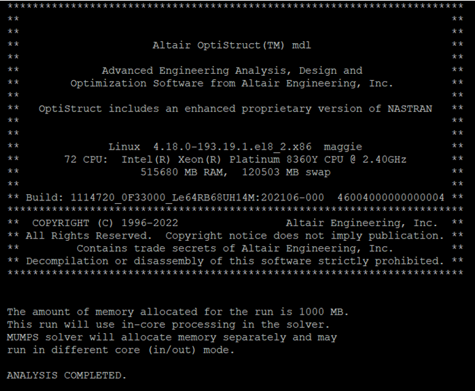

This launches OptiStruct to run the fatigue analysis.If the job was successful, new results files can be seen in the directory where the OptiStruct model file was written. The default files written to your directory are:
- SpotWeld_Cbar_Nugget_fat.hd3
- Hyper 3D binary results file, with both static analysis results and fatigue analysis results.
- SpotWeld_Cbar_Nugget_fat.out
- OptiStruct output file containing specific information on the file set up, the set up of your fatigue problem, compute time information, etc. Review this file for warnings and errors.
- SpotWeld_Cbar_Nugget_fat.stat
- Summary of analysis process, providing CPU information for each step during analysis process.
Figure 15. Submit Fatigue Analysis

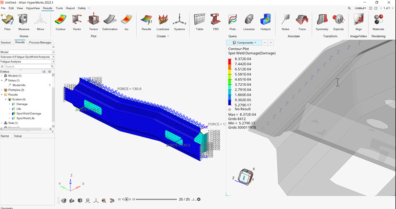

Post-process the Analysis
Make sure the task Post-processing is selected in the Fatigue Analysis
tree.
When fatigue analysis has completed successfully after the previous submit, it will automatically go into this task.
- For Fatigue subcase, make sure Select Subcase is selected.
- For Result Type and Data Component, select the required data you want to contour from the drop-down menu.
Click Load H3D Results (HV).
This launches HyperView and loads the SpotWeld_Cbar_Nugget_fat.h3d results file. It applies the result contour for selected result type and component. You can use HyperView for more detailed results.
Click Exit to unload Fatigue Process Manager.
Figure 17. Post-Processing
Figure 18. Damage Contour in HyperView
