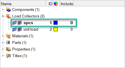

  1. In the Model Browser, right-click and select Create > Load Collector.
  2. For Name, enter spcs.
  3. Click Color and select a color from the color palette.
  4. For Card Image, set to None.
    A new load collector, spcs is created.
  5. In the Model Browser, right-click and select Create > Load Collector.
  6. For Name, enter unit-load.
  7. Click Color and select a color from the color palette.
    A new load collector, unit-load is created.

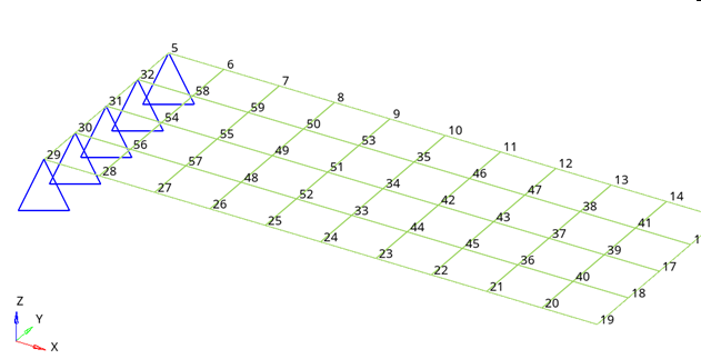

Create Constraints
  1. In the Model Browser, right-click the load collector spcs and select Make Current.
    rd2000_spc_load_collector
  2. Click BCs > Create > Constraints to open the Constraints panel.
  3. Click the entity selection switch and select nodes from the pop-up menu.
  4. Click nodes and select nodes 5, 29, 30, 31 and 32 (see Figure 2).
    Figure 2. Illustration of Nodes to Select for Applying Single Point Constraints
    os1100_pic1
  5. Constrain dof1, dof2, dof3, dof4, and dof5.
    • DOFs with a check will be constrained while DOFs without a check will be free.
    • DOFs 1, 2, and 3 are x, y, and z translation degrees of freedom.
    • DOFs 4, 5, and 6 are x, y, and z rotational degrees of freedom.
  6. Click create.
    The selected nodes will be free to rotate about the z-axis since dof6 was not checked.
  7. Click return to go back to the main menu.

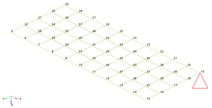

Create a Unit Load at a Point on the Flat Plate
  1. In the Model Browser, right-click on the load collector unit-load and select Make Current.
  2. Click BCs > Create > Constraints to open the Constraints menu.
  3. Select node number 19 on the plate by clicking on it (Figure 3).
    Figure 3. Node Selected for Creating Unit Vertical Load
    os1100_pic2
  4. Uncheck all the dof's except dof3 and click the = to the right of dof3 and enter a value of 1.
  5. Click load types= and verify that DAREA is selected from the extended entity selection menu.
  6. Click create, and then click return.
    The unit load is applied to the selected node.

  6. For SPC, select Unspecified > Loadcol.
  7. From the Select Loadcol dialog, select spcs.
  8. For DLOAD, select rload2 from the Select Load Step Inputs pop-out window.
  9. For FREQ, click Unspecified > Loadcol
  10. From the Select Loadcol dialog, select freq1.
    An OptiStruct subcase is created which references the constraints in the load collector spc, the unit load in the load step input rload2 with a set of frequencies defined in load collector freq1 and modal method defined in the load step input eigrl.

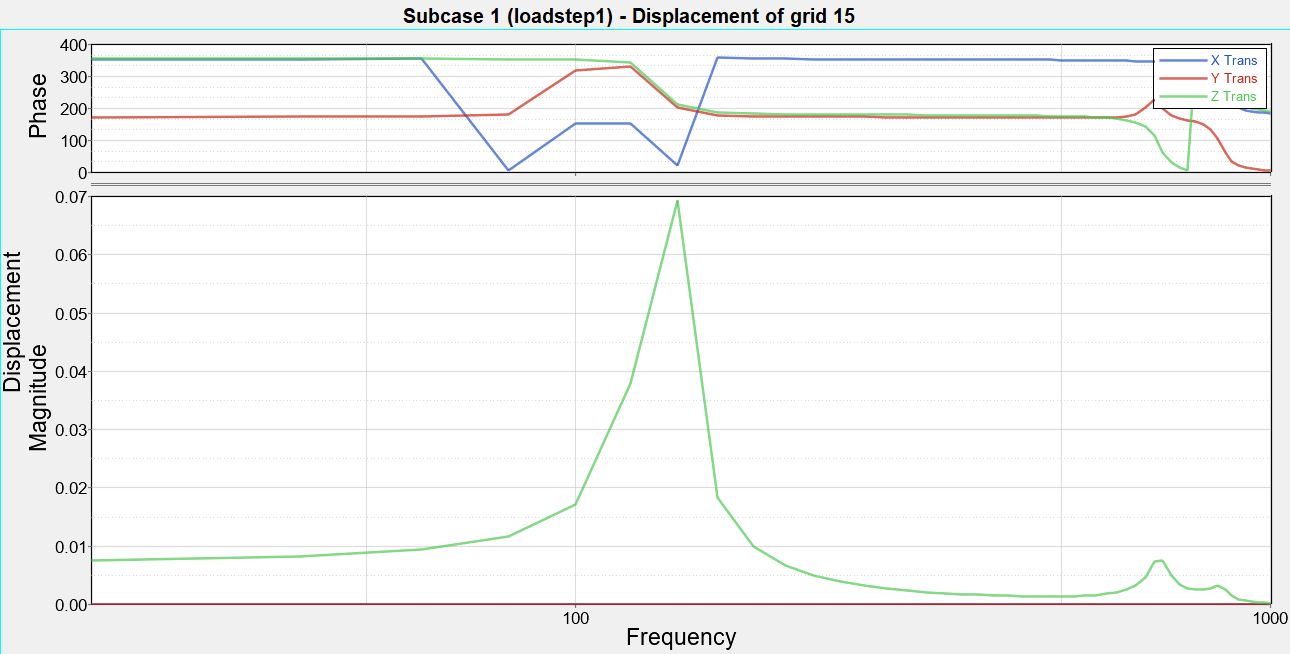

    Two graphs per page and a total of three pages are displayed in HyperGraph. The graph title shows Subcase 1 (subcase 1) - Displacement of grid 15 on page 1.

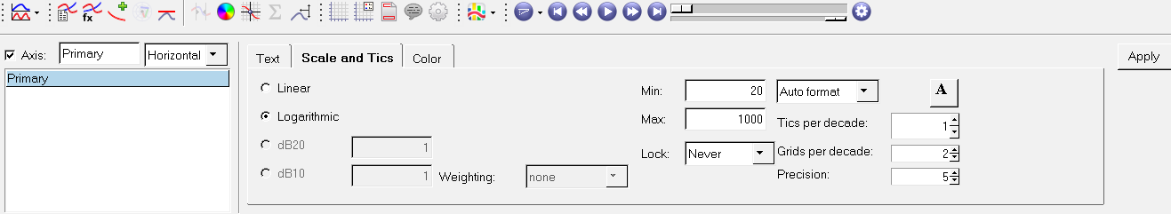

  7. Click the Axis toolbar icon annotateAxes-24. Select Logarithmic option and use the parameters shown below to make logarithmic plots of the results.
    Figure 5.
    rad_logarithmic
    There are two sets of results on this page. The top graph shows Phase Angle verses Frequency (log). The bottom graph shows Magnitude verses Frequency (log) (see figure) for Displacement of grid 15.
    Figure 6. Frequency response of node 15
    rd2010_results15
