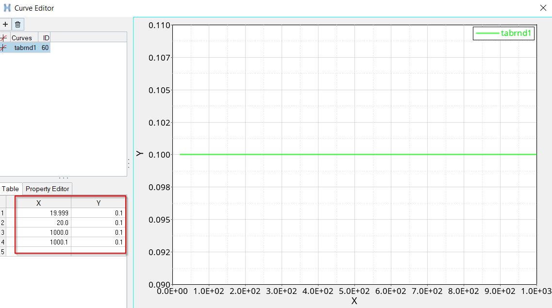

Create TABRND1 Curve
- In the Model Browser, right-click and select from the context menu.
- For Name, enter tabrnd1.
In the Curve Editor window, enter the values shown in Figure 2.
- Close the Curve Editor window.
- In Curves, select tabrnd1.
- For Card Image, select TABRND1.

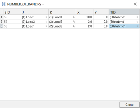

Create RANDPS Load Collector
- In the Model Browser, right-click and select .
- For Name, enter randps.
- For Card Image, select RANDPS.
- For NUMBER_OF_RANDPS=, enter 3 to define three RANDPS entries.
In the NUMBER_OF_RANDPS= dialog, input the
parameters.
The TABRND1 curve is selected for the TID(i) column entries.
Figure 3.
- Click Close.

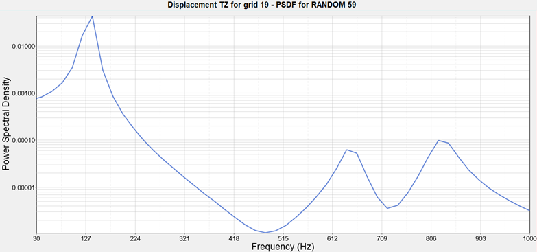

XYPLOT,DISP,PSDF/ 19(T3)OptiStruct will output the PSDF for the translational displacement in z direction at node 19.

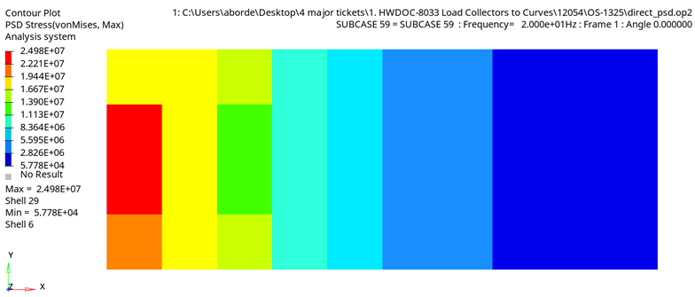

- Go to Contour panel.
- In the Load Case and Simulation Selection window, select the random subcase and the frequency = 20.0 Hz as the Simulation.
Select result type PSD STRESS (t), vonMises, and click
Apply.
The PSD vonMises stress contour at frequency 20.0 Hz is displayed as:
Figure 5.

In the HyperView window, click .
The Open Session File window opens.
- Select the directory where the job was run and select the file direct_psd_rand.mvw.
Click Open.
Figure 6.
