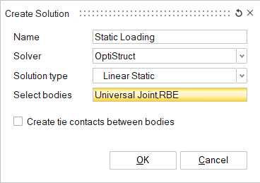

  3. In the Create Solution dialog, define the following options:
    1. For Name, enter Static Loading.
    2. For Solver, select OptiStruct.
    3. For Solution type, select Linear Static.
    4. Click OK.
    Figure 1. Create Solution

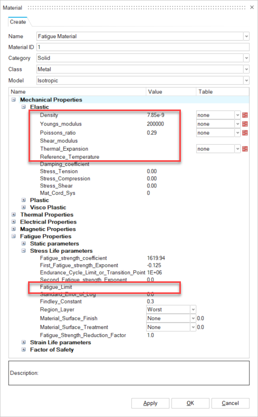

Create Material
  1. From the Analysis ribbon, Property group, click the Material tool.
    The Material dialog opens.
  2. In the Material dialog, enter the values as shown below and click OK.
    Figure 2. Fatigue Material Creation
    The Fatigue material is created in the Property tab of the Model Browser.

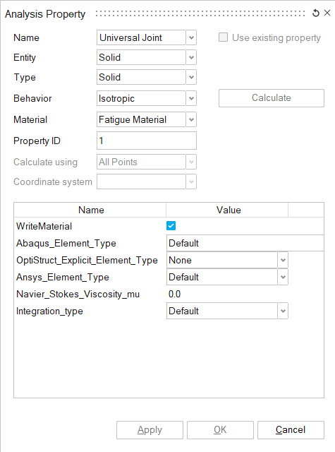

  2. In the Analysis Property dialog, enter the values as shown below.
    Figure 3. Create Analysis Property

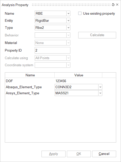

  5. Create a RBE property.
    1. In the Analysis Property dialog, enter the values as shown below.
      Figure 4. Create RBE Property
    2. In the Assembly tab of the Model Browser, select RBE.
    3. In the Analysis Property dialog, click OK.
The created properties are displayed in the Property tab of the Model Browser.

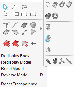

  3. In the modeling window, right-click and select RBE Node from the context menu.
    Figure 5. Select RBE Main Node Selection Filter

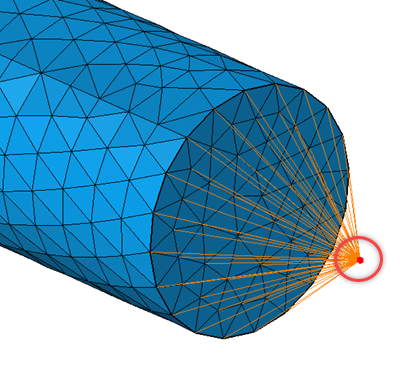

  4. In the modeling window, select the RBE main node attached to the Universal joint.
    Figure 6. Select RBE Main Node

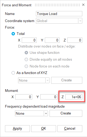

  5. In the Force and Moment dialog, enter the values as shown below and click OK.
    Figure 7. Torque Load Creation

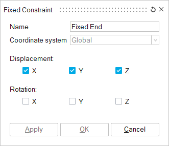

Define Constraints
  1. From the Analysis ribbon, Loads and Constraints group, click the Constraints tool.
  2. From the secondary tool set, select the Fixed tool.
    The Fixed Constraint dialog opens.
  3. In the Fixed Constraint dialog, enter the values as shown below.
    Figure 8. Create Fixed End Constraint
  4. In the modeling window, select the faces of the Universal Joint body.
    Figure 9. Face Input for Fixed End Constraint
  5. In the Fixed Constraint dialog, click OK.
The Fixed End constraint is added to the current Loadcase.

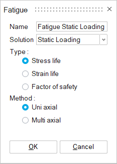

  2. In the Fatigue dialog, enter the values as shown below and click OK.
    Figure 10. Set Fatigue Solution Parameters

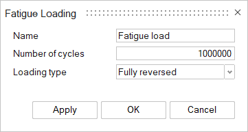

  3. From the Analysis ribbon, Loads group, click the Fatigue tool.
    The Fatigue Loading dialog opens.
  4. In the Fatigue Loading dialog, click Apply.
    Figure 11. Define Fatigue Loading
    The fatigue loading is defined.

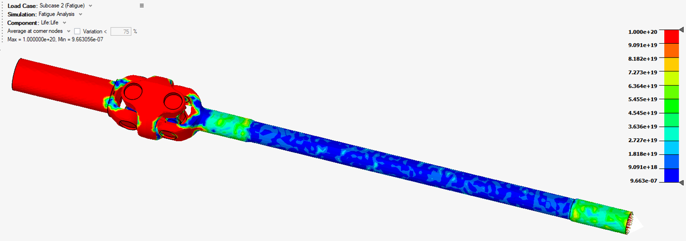

  2. Right-click on Results under the Fatigue solution and select Update from the context menu.
    The solution begins to solve.
The results are automatically loaded back into the database.
Interpret the Results
The results are automatically loaded in the modeling window.
Figure 12. Result Example

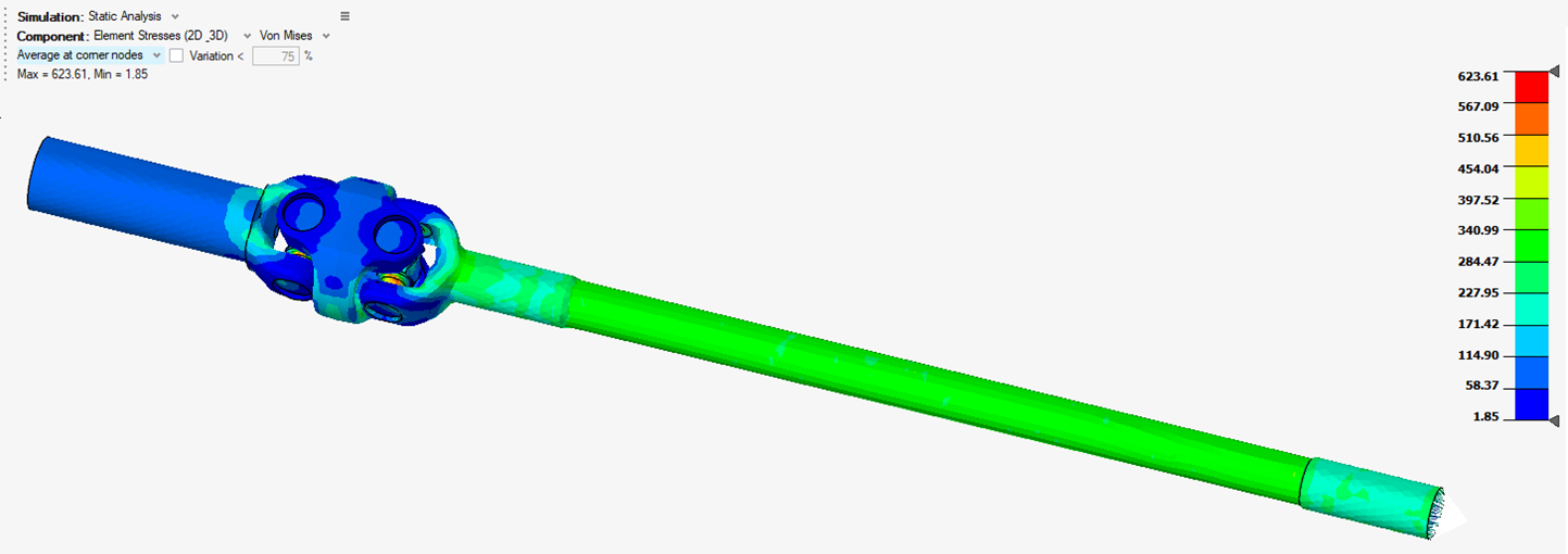

  2. In the Solutions tab of the Model Browser, right-click Results under the Static Loading solution and select Display from the context menu.
    Figure 14. Result Example
    The results for the Static Loading solution are displayed.
