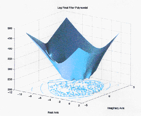

  8. Eigen modes are computed using ARPACK software (R. Lehoucq, K. Maschhoff, D. Sorensen, C. Yang).
    clip0033
