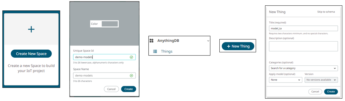

In IoT Studio, .

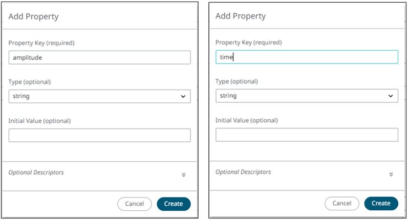

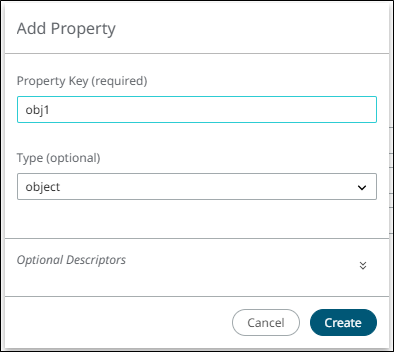

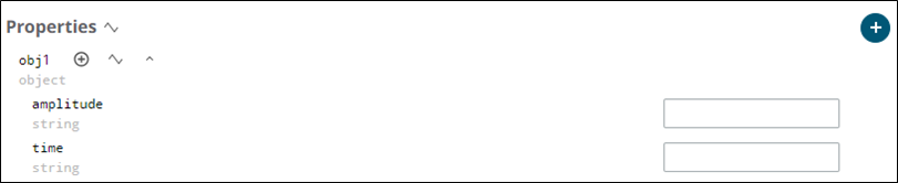

After the Thing is created, a property is created to receive data from Twin Activate and be stored on IoT Studio.
Select .
Create Properties to be attributed to this object:

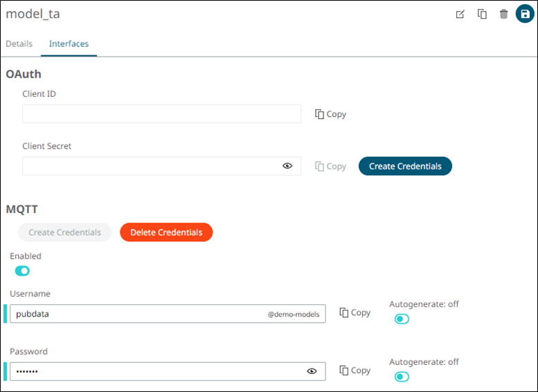

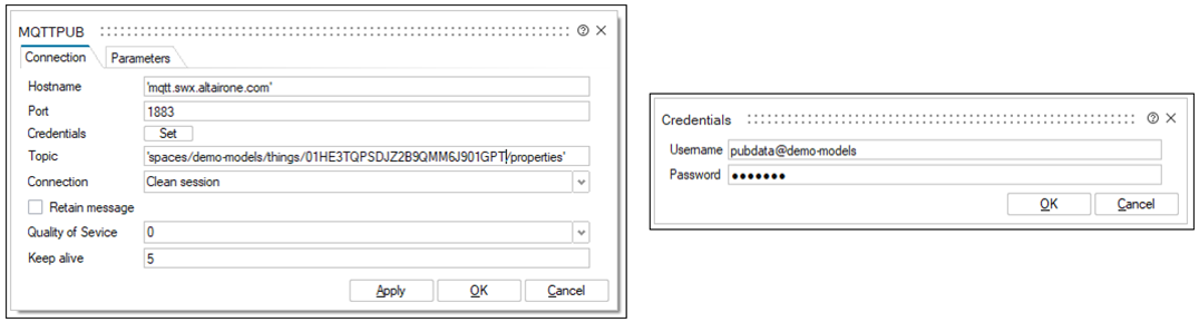

To set the MQTT credentials on IoT Studio, select .
Publishing to an MQTT Topic on IoT Studio
- In Twin Activate environment, select .

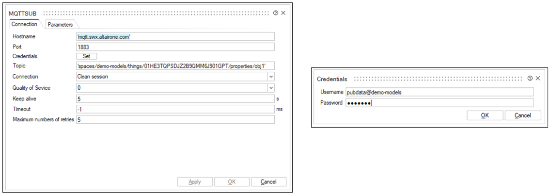

In the block Connection tab set the Hostname,
Credentials, and the Topic end
point with the Space name, Thing ID, and, in this case, properties (not
mandatory), following the structure:
'spaces/<space-name>/things/<thing-id>/properties'Note: You can find the main topic structure in the URL
href.

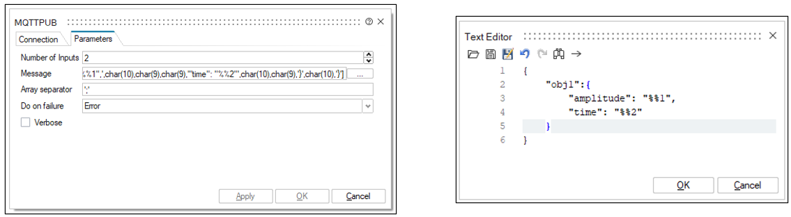

Ensure the block Parameters tab has the Number of
Inputs, in this case two (amplitude and time), and the
Message. It is required to use JavaScript Object
Notation (JSON) format to send data to IoT Studio:
{ "obj1":{ "amplitude": "%%1", "time": "%%2" } }

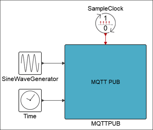

After doing the setup for the MQTT PUB block, connect some of the Signal
Generators blocks to the inputs and a SampleClock to activate the block:

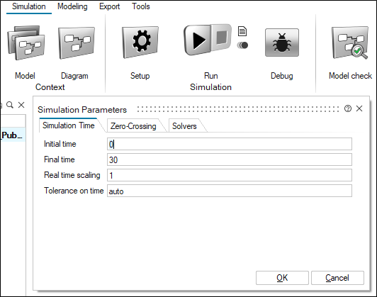

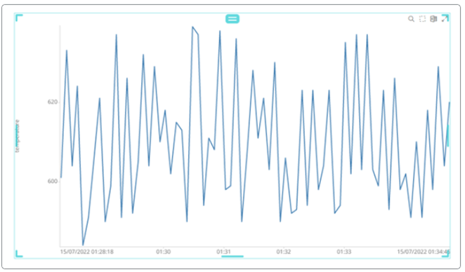

Select . The simulation sends data in real time to IoT Studio.
Click Run Simulation.

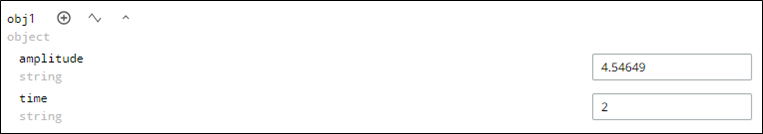

It is possible to see that the data sent from Twin Activate is being received on IoT Studio using the MQTT protocol.
'spaces/<space-name>/things/<thing-id>/properties/<property-name>'

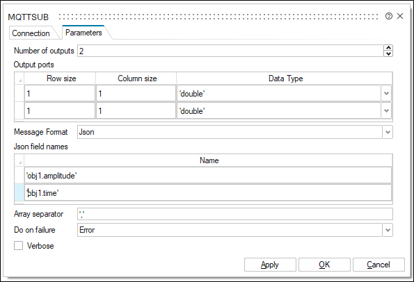

Outputs, in this case two (amplitude and time), and the
Message. As it is being received from IoT Studio, select JSON format, and as the message will be
received from one object, the format below must be respected to receive each of
the attributes.

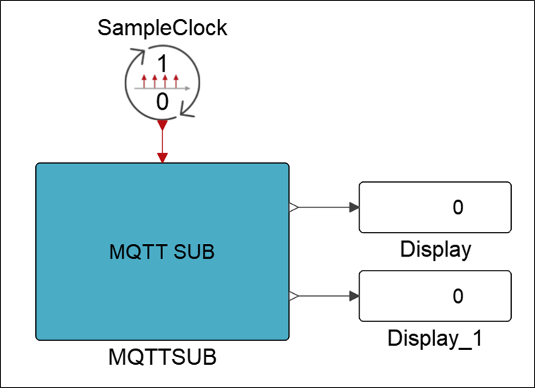

After doing the setup for the MQTT SUB block, connect some of the Signal
Viewers blocks to the outputs and a SampleClock to activate the block:

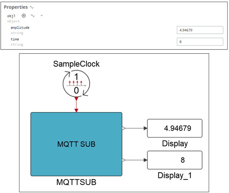

After being subscribed to an MQTT topic, any message sent to the topic is received in Twin Activate. Say that some device is sending message to IoT Studio on the created object, on its attributes. Considering that Twin Activate is connected to IoT Studio, those messages appear in the software:
It is possible to see that the data sent from IoT Studio is being received on Twin Activate using the MQTT protocol.
