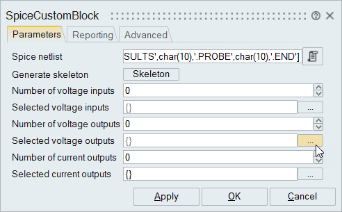

- From the , drag one SpiceCustomBlock into your diagram and double-click it.
From the Parameters tab, select the SPICE Netlist button.

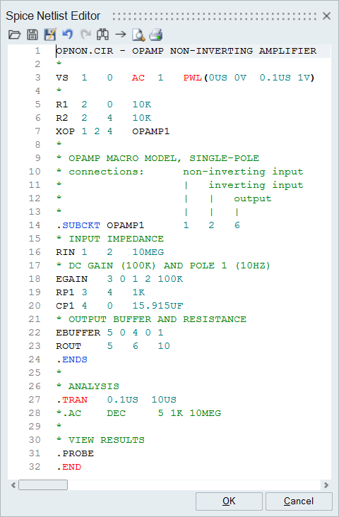

The Spice Netlist Editor appears. -
Copy the code from the OP_NON.cir file and paste it into
the Spice Netlist Editor.
- Click OK.

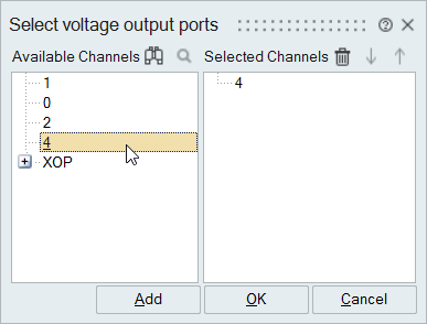

From the Parameters tab, select the button to define the Selected
voltage outputs.
The Select voltage output ports dialog appears. -
From the list of Available Channels, double-click
4.
Click OK.
Note: You do not need to define the input as the stimulus is already defined in the Spice netlist that you entered.

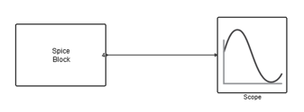

- From the Palette Browser, select .
Drag one Scope block into your diagram and connect it to
the output of the SpiceCustomBlock.
This portion of the model is ready to run and test. -
From the Run
tool, select Setup
- Select the Simulation Time tab.
- For Final Time, enter 10e-6 seconds.
Click Run
Double-click the Scope block in the model. The plot should look something like this:

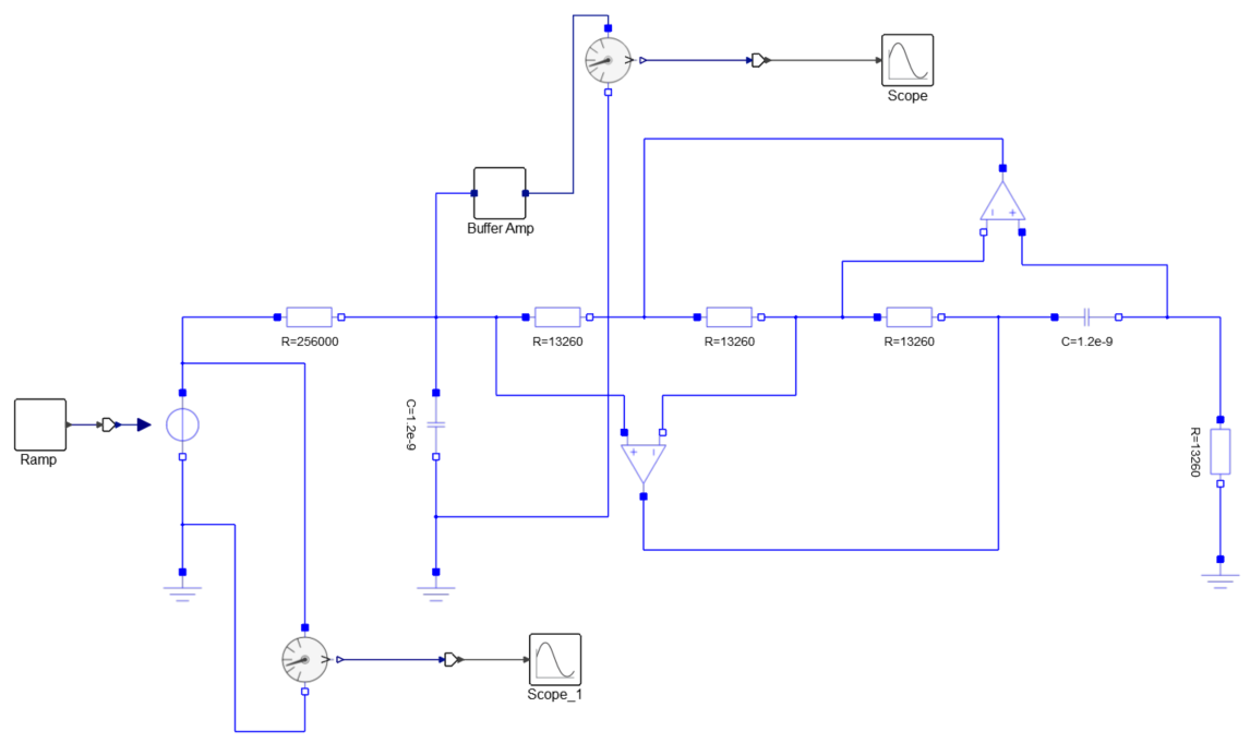

Create a Spice Model from a Modelica Model
Create a circuit with components from the HyperSpice palette. Base your model on the Modelica example that is provided.
From the Demo Browser, select BandPassFilter.scm
The BPF model constructed from Modelica blocks appears.
Beginning with the Filter.scm model you started, construct
a Spice version of the circuit model using the blocks from the HyperSpice
palette.

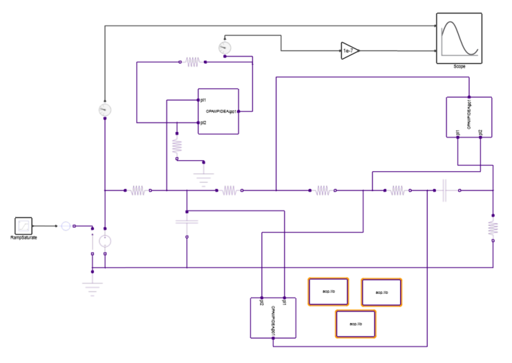

Add an xinst block to your model and reference the block through a Spice.lib file.
- From the , drag one xinst block into the current diagram.
With a text editor of your choice, create a text file with the following code
and save the file as aop.lib.
.subckt opampideal 2 1 3 G1 0 3 2 1 100000000 R3 3 0 1 C3 3 0 636e-6 .ENDSNote: In this tutorial example, the aop.lib file references the xinst block in your model through the.subckt(sub circuit) description. Alternatively, you can use the.modeldescription to reference the block. -
In your model, double-click the xinst block and define
it as follows:
For this parameter Enter this value Instance Model name or subckt instance name opampideal Input ports number 2 Output ports number 1 Keep the defaults for any remaining parameters. - Click OK.

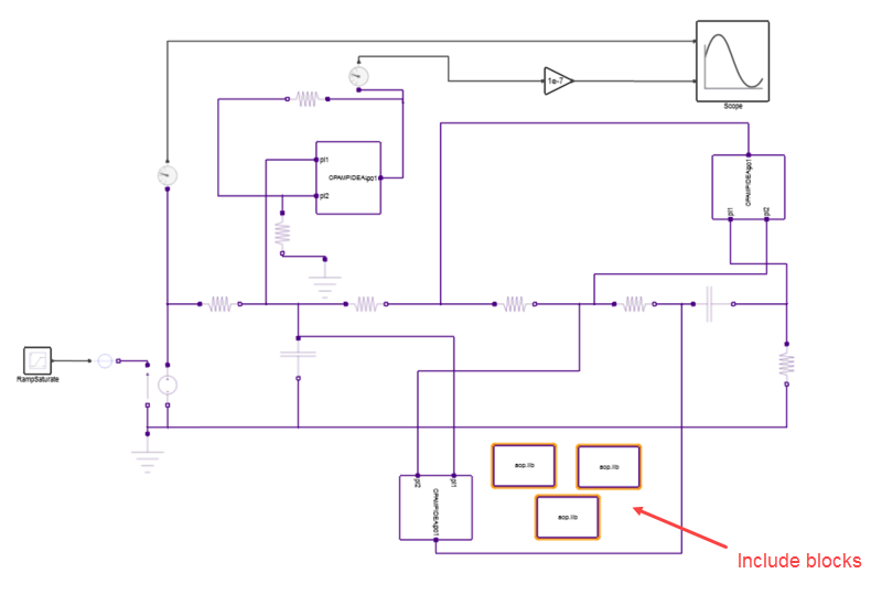

From the , drag one include block into the current
diagram, then double-click the block.
The include block must reside in the diagram, but does not require a connection to the blocks in the diagram.
- For File name to include, enter: aop.lib. Keep the defaults for any remaining parameters.
Because three operational amplifiers are required for your model, three include
blocks are also required. To duplicate the current include block, select it and
press Ctrl+D two times.
Your final model should look something like this:
