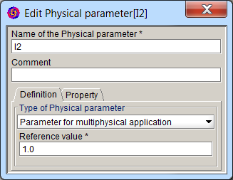

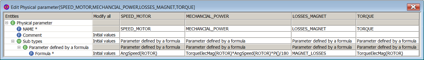

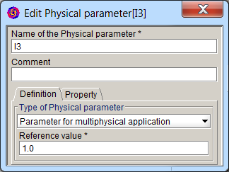

The inputs for the IPM motor are defined as multi-physical parameters and include:
- I_1: Physical quantities: μr, Bs, Br
- I_2 Electrical quantities: resistance, voltage, current
- I_3: Mechanical quantities: position, speed, electromagnetic torque
The outputs for the IPM motor are scalar I/O settings that retrieve values through the sensors, formulas (torque) and parameters (position, speed, acceleration).

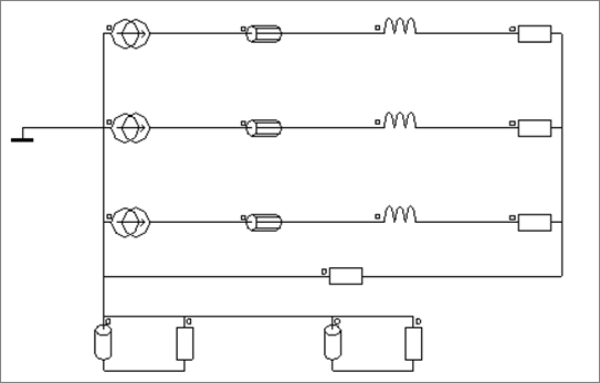

The circuit of the IPM motor is configured with a current source, coil conductor, resistor and inductance.

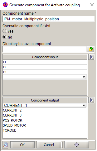

- From the Flux 2D toolbar, select .

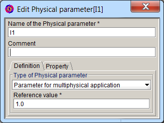

In the dialog, enter the following information for the component:
- Enter the name for the component: IPM_motor_Multiphysics_positionF2STA
- Enter the path to your working directory: <name_without_spaces>

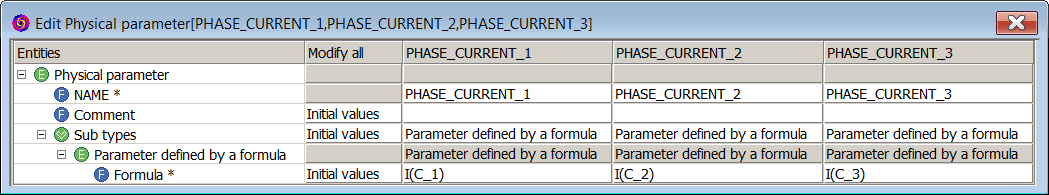

- Select the input (geometric I/O parameters) for the component: I1, I2, I3
- Select the output: PHASE_CURRENT_1, PHASE_CURRENT_2,PHASE_CURRENT_3, TORQUE, SPEED_MOTOR and POS_ROTOR
The dialog should look something like this:
Click OK.
The coupling component is saved to your working directory as IPM_motor_Multiphysics_position.F2STA.

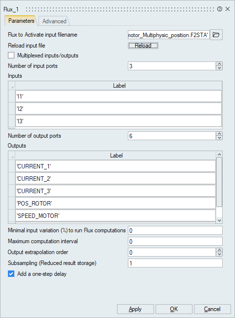

- From the Palette Browser, select , and drag one Flux block into your diagram.
- Double-click the Flux block. In the block dialog, for Flux to Activate input filename, enter the path to the coupling component you generated from Flux: <working_directory>/ IPM_motor_Multiphysics_position.F2STA.F2STA.
Click OK.
The Flux block populates with the model data from the Flux coupling component.
For the last three fields in the Flux block dialog, enter these values:
- for Numerical memory (MB), enter 2721.
- For Character memory, enter 200.
- For Minimal input variation %, enter 10.
Click OK.
The Flux block dialog should look something like this:

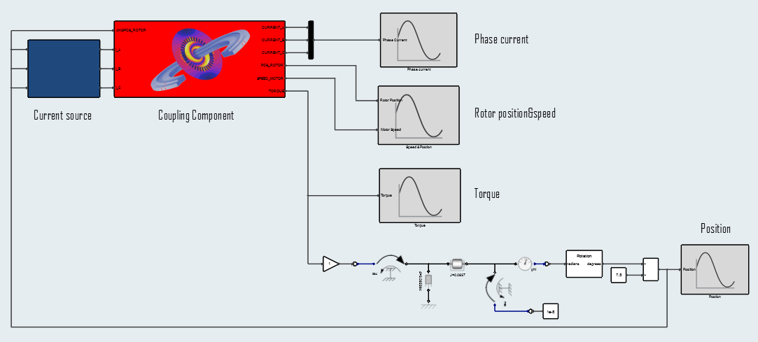

In the diagram, add three SineWaveGenerator blocks to the left of the Flux
block and define them as follows:
Define Sine Wave_1 Sine Wave_1 Sine Wave_3 Magnitude 200 200 200 Frequency (rad/s) 2 * pi * 80 2 * pi * 80 2 * pi * 80 Phase (rad) 45*pi/180 -2 * pi / 3+45*pi/180 -4 * pi / 3+45*pi/180 -
In the diagram, add four Scope blocks to the right of the Flux block, and
Define Scope 1 Scope 2 Scope 3 Scope 4 Block name Currents Rotor position
Rotor speed
Torque Position Number of inputs 3 2 1 1 -
Assemble and connect the blocks as you see in the following figure, and save
the model.
Figure 3. Flux block assembled with inputs and outputs
The Twin Activate model is complete and configured to supply the Flux model of the IPM motor with three currents.

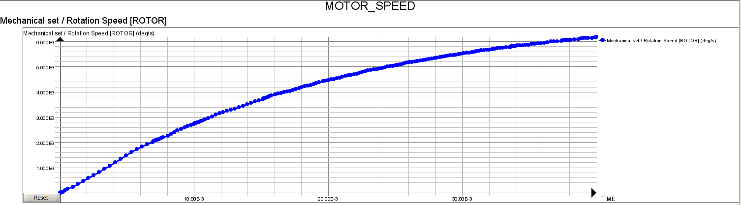

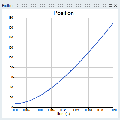

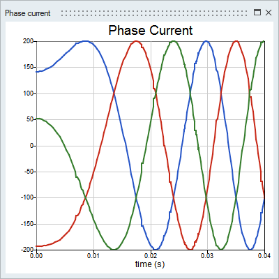

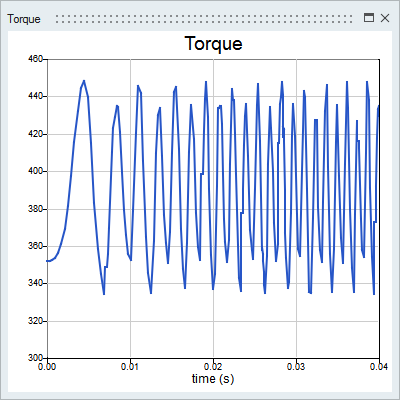

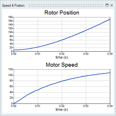

The simulation results show the currents fed into the motor and the motor performance.Figure 4. Phase current (A), rotor position (deg), motor speed (deg/s), torque (Nm) and position (deg)

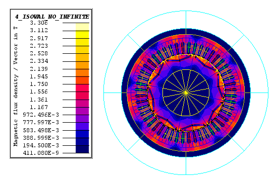

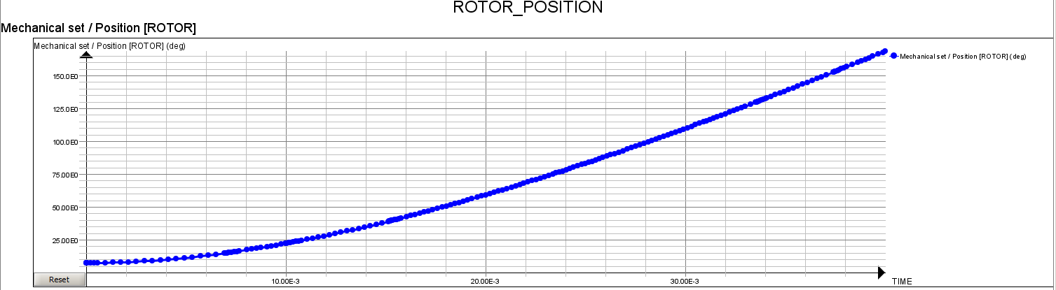

Flux post-processing results show density isovalues; phase current, rotor position, motor speed, torque and position.
Figure 5. Flux density isovalues

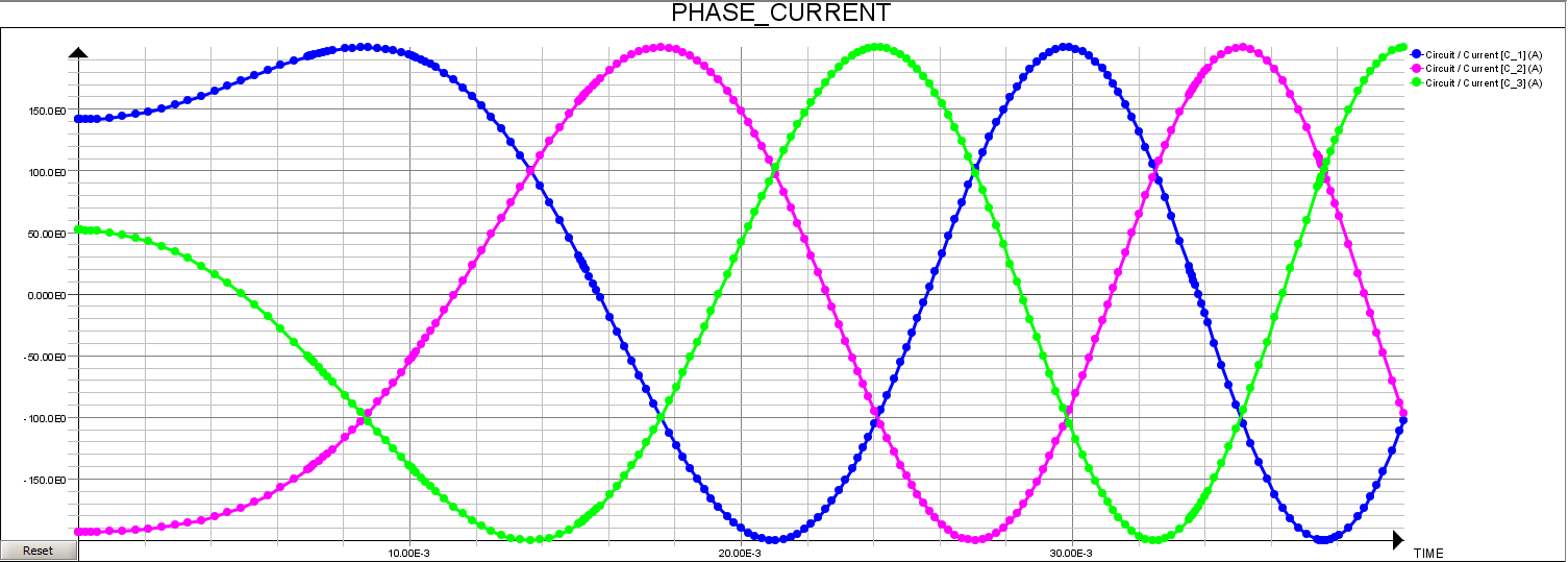

Figure 6. Phase current (A)
Figure 7. Rotor position (deg)
Figure 8. Motor speed (deg/s)

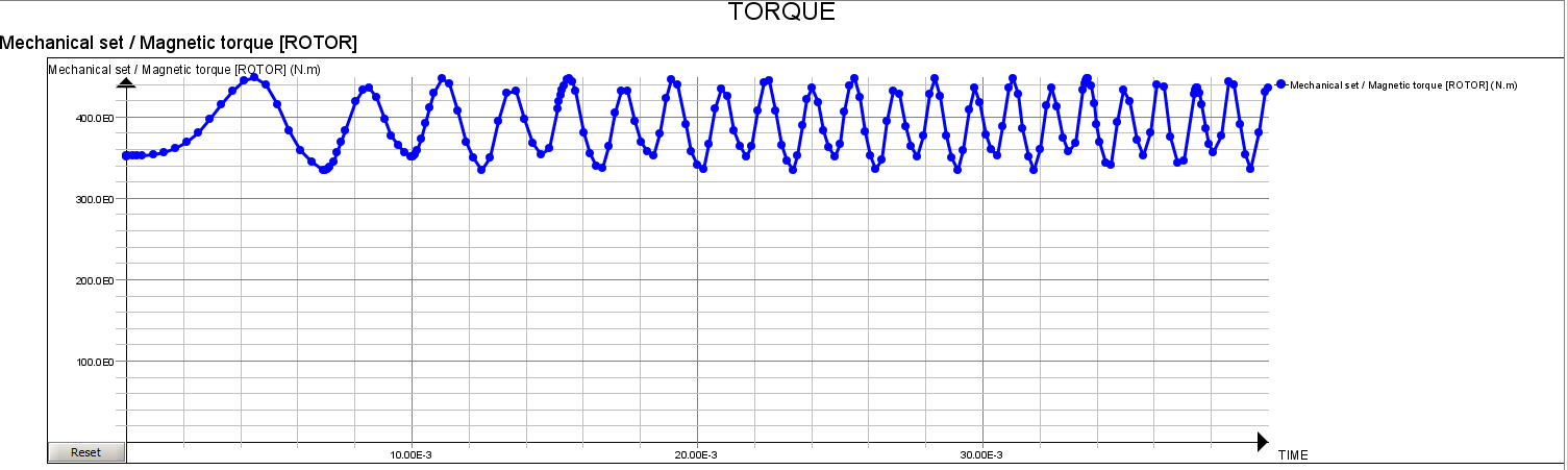

Figure 9. Torque
