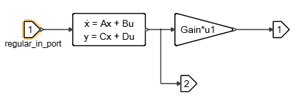

Exporting a Super Block to the FMU
Export a super block from the controller model into the FMU.
From the ribbon, select Open and
navigate to Controller.scm.

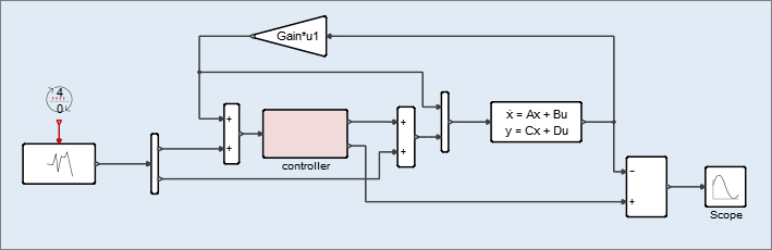

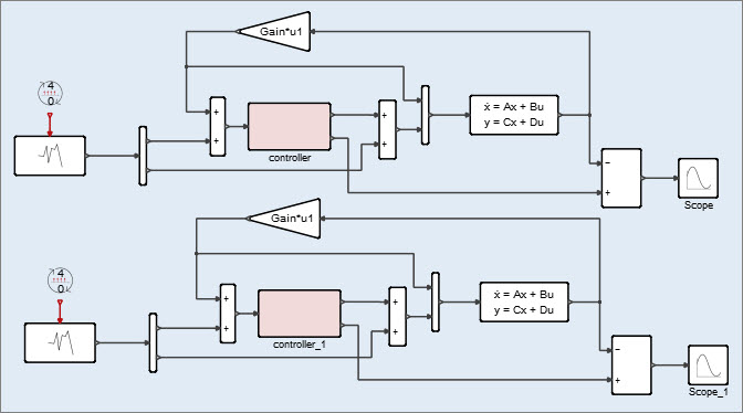

The Controller model opens with its main diagram displayed:
From the main diagram, double-click the super block
controller:

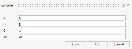

To expose parameters in the FMU, right-click the super block, and then select Mask > Auto Mask.
If you double-click the super block, you can see the parameters.

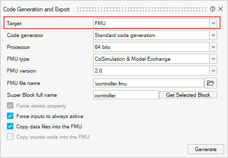

From the menu bar, select Tools > Code Generation and Export.
In the dialog box, select FMU as the
Target, and then click
Generate.
The FMU is generated and can be imported into another Twin Activate model or other software product that supports
FMI, and subsequently run in either Cosimulation or Model Exchange.

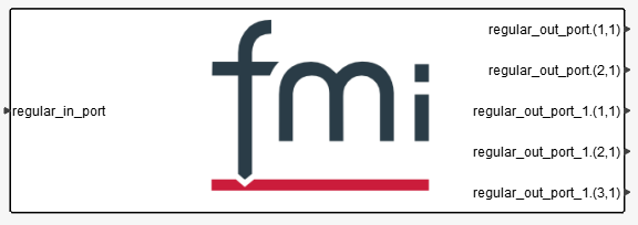

From the Palette Browser > Activate > CoSimulation, drag and drop one FMU block into the
modeling window.
The FMU block provides the interface to import and configure the
exported FMU file.

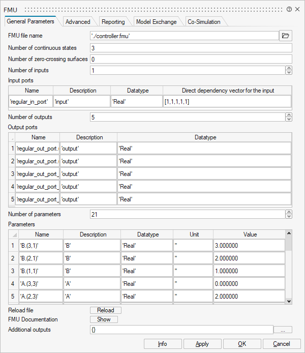

On the FMU block, double-click.
In the FMU block dialog, for the FMU filename, click , and browse to the exported FMU file that you
created in the last steps. Alternatively, to use the example FMU that is
provided for this tutorial, browse to
<installation_directory>\tutorial_models\controller.fmu.
All other parameters on the General Parameters tab are automatically
populated.
In the Input ports table, for the Direct
dependency vector for the input, enter
0.
Click OK.
The Direct dependency vector for the input sets the input to affect the
output directly. In this case, the input does not affect the output, therefore
the value is 0.

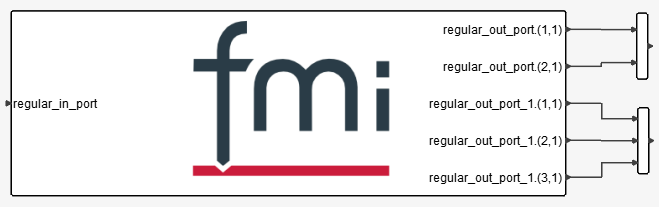

To resize the FMU block, select it and drag it from the corner until you can
easily read all of the labels on the block.
The FMU block has one input and 5 outputs. Note that all inputs and
outputs carry a scalar signal and that vector or matrix data is not allowed in
the FMI standard.
You can derive the input and output dimensions of the original super
block controller by examining the ContStateSpace and MatrixGain blocks
inside. The input size is 1x1; the first output size is 2x1; and the second
output size is 3x1.
In the Palette Browser, from System > Activate > Routing, drag and drop two Mux blocks into the
diagram.
On one of the Mux blocks, double-click.
In the block dialog, for number of inputs, enter
3.
Assemble the scalar outputs from the FMU block so that the block resembles the
original super block from the input/output (I/O) perspective.
Convert the FMU block and Mux blocks into a super block, and then in the
Property Editor, Under General, for Name, enter
FMU ME.

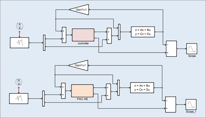

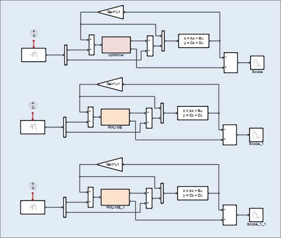

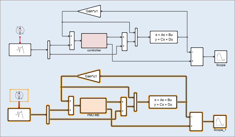

To duplicate the main diagram, box-select the entire main diagram, press
Ctrl+C, and then Ctrl+V.
A duplicate diagram is added to the model:
Select the super block FMU ME containing the FMU block;
press Ctrl+X; select the super block
controller_1; press Ctrl+V.
The super block, controller_1, is replaced with FMU ME:

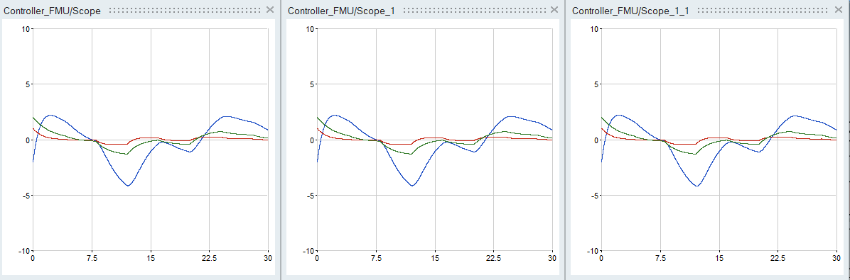

On the ribbon, from the Simulate tool group, click
Run.

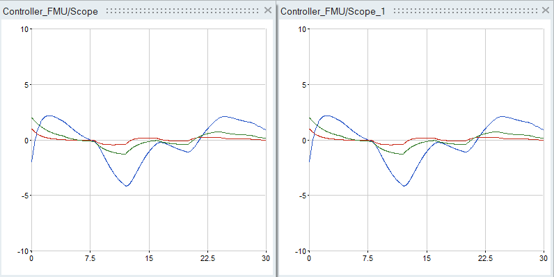

As the simulation runs, examine the Scope windows of the two Scope
blocks. The windows should display the same curves indicating that the imported
FMU is co-simulating successfully with the rest of the model, and that the
imported FMU behavior is the same as the original super block from which the FMU
was exported.

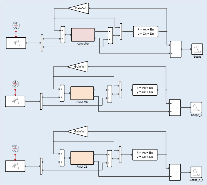

Box-select the diagram that contains the super block, FMU
ME, and press Ctrl+C:
Move your cursor to a blank area below the diagrams, click, and press
Ctrl+V.
The diagram with the FMU ME super block is added as a third model for
comparison.
The next steps show you how change the simulation type to
co-simulation.
Select the super block, FMU ME_1, and in the Property
Editor, enter the name FMU CS.

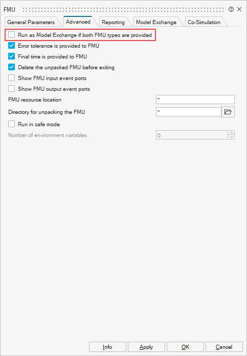

Configure the FMU block to run the FMU in co-simulation mode: Enter the FMU CS
super block, then on the FMU block, double-click.
From the block dialog that appears, select the Advanced
tab and clear the check box: Run as Model Exchange if both FMU types
are provided. When the check box is cleared, the FMU runs in
co-simulation mode; when the check box is selected, the FMU runs in model
exchange mode.
Your model should look something like this:
On the ribbon, click Run.
The simulation runs and the Scope windows produce the following
plots:
Compare the simulation results in the three Scope windows. You should see three
identical curves supporting that the FMU exported from the steps in the topic,
Exporting a Super
Block to the FMU, could be imported back and simulated in both Model
Exchange and Co-Simulation modes, and that the FMU results are identical to the
original super block from which the FMU was generated.
