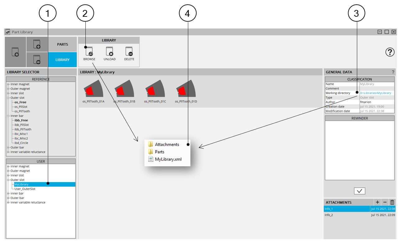

From the library environment it is possible to directly access the folder in which the data dealing with the selected library are stored.
| Browsing to access the library folder | |
| 1 | Selection of a library. |
| 2 | Browse function available from the top part of the environment. |
| 3 | Browse function available from information table. |
2. Contents of folders
2.1 Overview
The contents of folder directly reachable from the LIBRARY interface are described below.

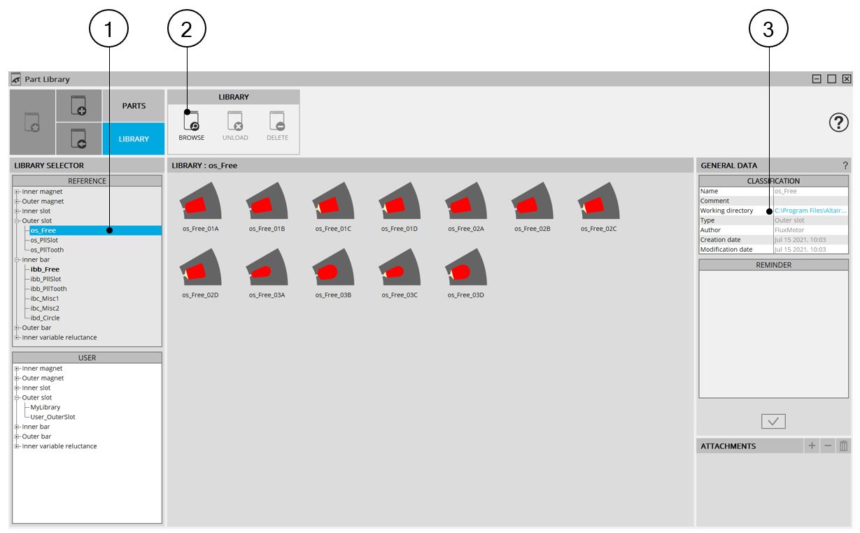

| 1 | Selection of a user’s library. In our example the name of this library is “MyLibrary”. |
| 2 | Click on the icon “BROWSE” to reach the folders dealing with the part. |
| 3 | Click on the path in the “Working folder” field to reach the folders dealing with the part. |
| 4 | Content of the folder “MyLibrary”:Two folders “Attachments” and “Parts”
+ one xml file: MyLibrary.xml. See below the content of these folders. |

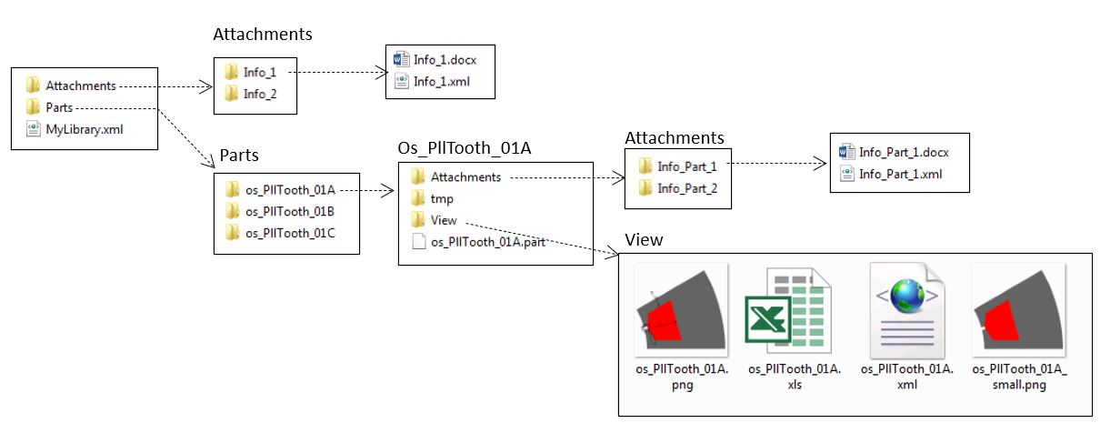

2.2 Folder organization
The graph below shows how to reach the main files dealing with libraries or parts.
| Content of folders |
Folder “Attachments” :
All the documents associated to the considered library (or Part).
Folder “Parts” :
All the parts stored in the considered library.
Note: In the folder associated to each part (like os_PllTooth_01A in
the example above) the Excel file, contains all the part’s properties. It is stored in a
folder with the name as “View”.
