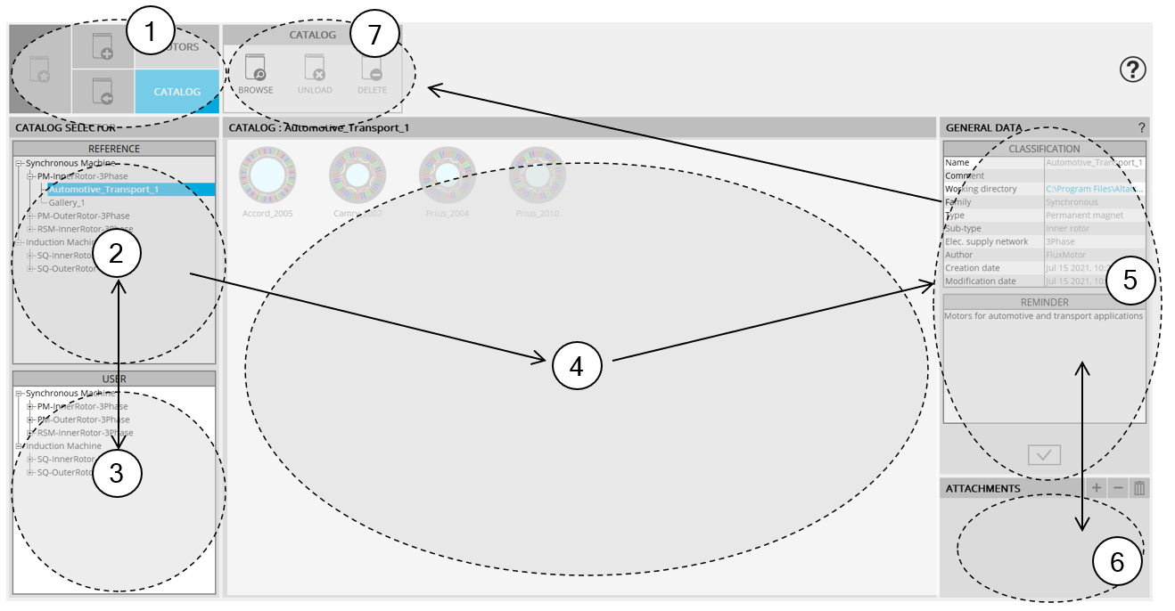

1. Main areas
Here are the main zones that compose “CATALOG” environment of the Motor Catalog.
| Zones of Motor Catalog – Catalog area view |
| Zone 1 | Motor Catalog has two main environments: CATALOG and
MOTORS.When CATALOG is selected = Blue color Catalog environment of
Motor Catalog is displayed.Moreover, three main functions are
available from the top of this panel:
| Zone 2 | Reference catalogs provided with the software are available.
Selections of catalogs must be done in this field. Motors of these catalogs are read only. However, they can be copied and moved into user’s catalogs. |
| Zone 3 | User’s catalogs. Selections of catalogs must be done in this field.
The users can create new catalogs. See the process in the chapter “Reference commands”. |
| Zone 4 | Visualization of all the motors (thumbnails) are stored in the selected catalog. |
| Zone 5 | Information relative to the selected catalog.“Reminder” is an area in
which a memo can be written if needed. Note: The
working folder is accessible for all the catalogs. |
| Zone 6 | It is possible to attach documents to the selected catalog (pictures, pdf files etc.). |

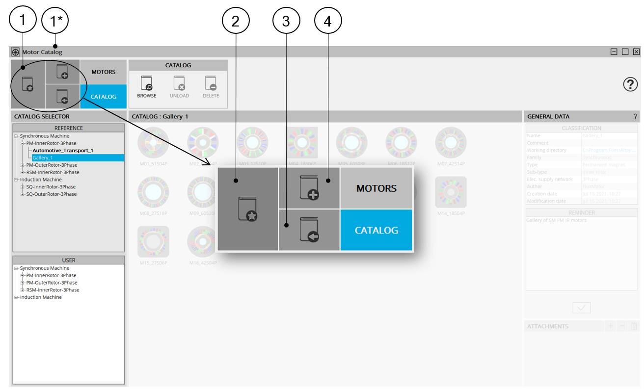

2.Direct access to main functions
All the functions listed below are described in the section dedicated to reference commands.
Note: These commands are available in CATALOG environment as well as
in MOTORS environment.
| 1 | Click on one of the three main buttons to use some main system
functions.
Note: These three functions are available in the
CATALOG and MOTORS areas. |
| 1* | Clicking on this zone allows access to the main menu. |
| 2 | Set catalog as favorite. The selected catalog (bold characters) is opened. See the process in the chapter “Reference commands”. |
| 3 | Load a catalog from a folder. See the process in the chapter “Reference commands”. |
| 4 | Create a new catalog. See the process in the chapter “Reference commands”. |

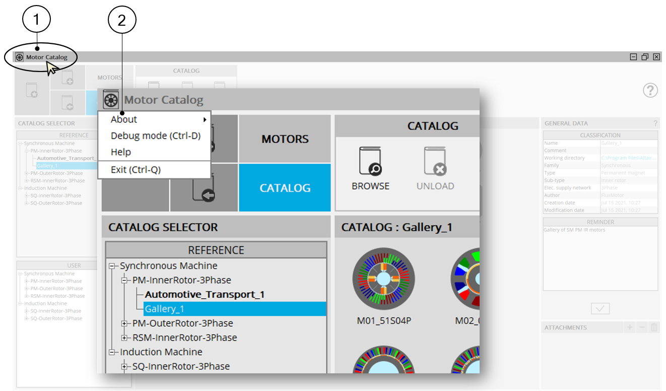

3. Expanding the menu in Motor Catalog
This menu gives access to system functions related to help and exit.
| 1 | Expand the menu on the left top part of Motor Catalog in both areas: CATALOG or MOTORS. |
| 2 | List of actions available:
Close Motor Catalog is also possible by using this icon on the right top part of the Motor Catalog panel. |
| * | Close Motor Catalog is also possible by using the shortcut CTRL-Q defined in the user's preferences from the supervisor. For more information, refer to the chapter “user’s preferences”. |
