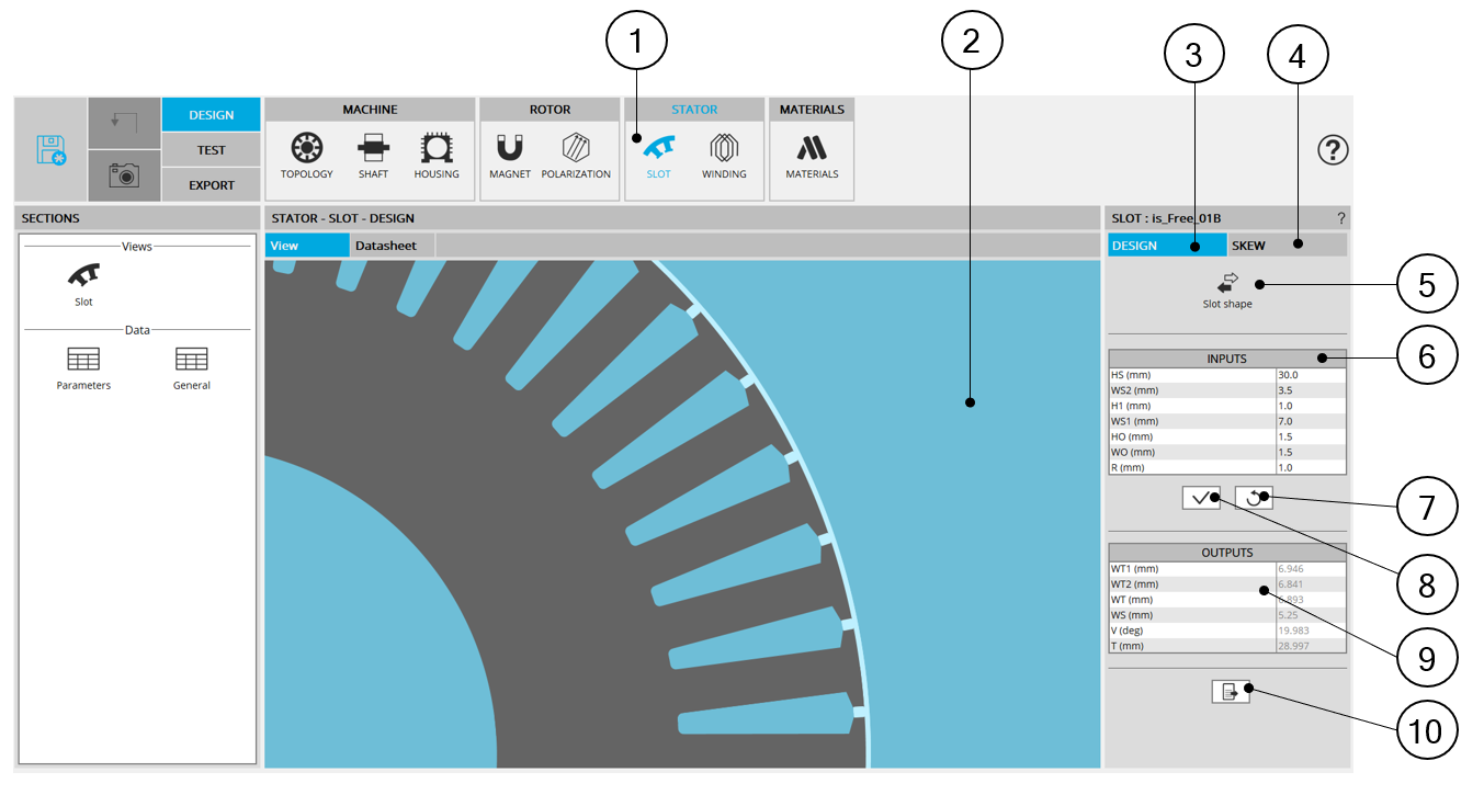

Slot - Overview
| SLOT design area | |
| 1 | Selection of the STATOR subset: SLOT panel (Click on the icon SLOT) |
| 2 | Visualization of the motor radial view to see the slot topology and dimensions. |
| 3 | DESIGN tab indicates the tools to define the slot topology and parameter
values. Note: By default, DESIGN tab is
selected. |
| 4 | SKEW tab indicates the tools to define the slot skewing angle. |
| 5 |
"Slot shape" button allows accessing the slot libraries to change the slot topology. See additional information below. |
| 6 | User input parameter fields to enter the value. |
| 7 | Button to restore default input values. |
| 8 | Button to Apply inputs. Pressing the enter key twice applies inputs too. |
| 9 | Output parameters (read only data) to complete the description of the topology. |
| 10 | Icon to export slot data into *.txt or *.xlsx files. |
