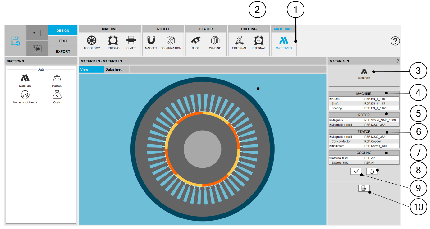

| MATERIALS design area | |
| 1 | Selection of the Material subset: MATERIALS panel (Click on the icon MATERIALS) |
| 2 | Visualization of the machine regions. |
| 3 | Direct access to open material manager. It allows seeing properties of materials. |
| 4 | Area to assign materials to machine regions (frame, shaft, bearings). See additional information below. |
| 5 | Area to assign materials to rotor regions (magnets, magnetic circuit).
| 6 | Area to assign materials to Stator regions (magnetic circuit, coil
conductor, insulators). See additional information below. |
| 7 | Area to assign materials to Cooling fluids (internal fluid, external
fluid). See additional information below. |
| 8 | Button to restore default materials.Default materials are those defined as favorite materials in Material manager. See “Materials” application for more information. |
| 9 | Button to validate assignment of materials. Pressing the Enter key twice applies inputs too. |
| 10 | Icon to export material data into *.txt or *.xls files. |
