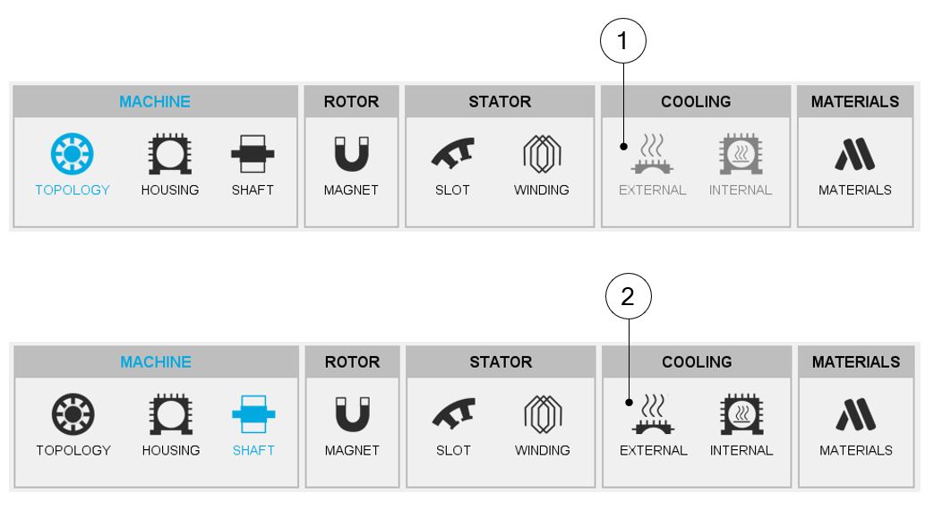

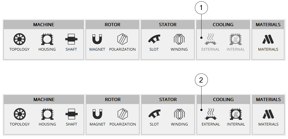

By default, accesses to External cooling and Internal cooling environments are locked.
External cooling is unlocked when a frame is defined (Housing / Frame environment)
Internal cooling is unlocked when on the one hand a frame is defined (Machine / Housing / Frame environment) and on the other hand a shaft with bearings are defined (Machine / Shaft / Bearing environment). See below illustrations.
| How to unlock cooling environments | |
| 1 | External and internal cooling environments are locked |
| 2 | External and internal cooling environments are unlocked |
