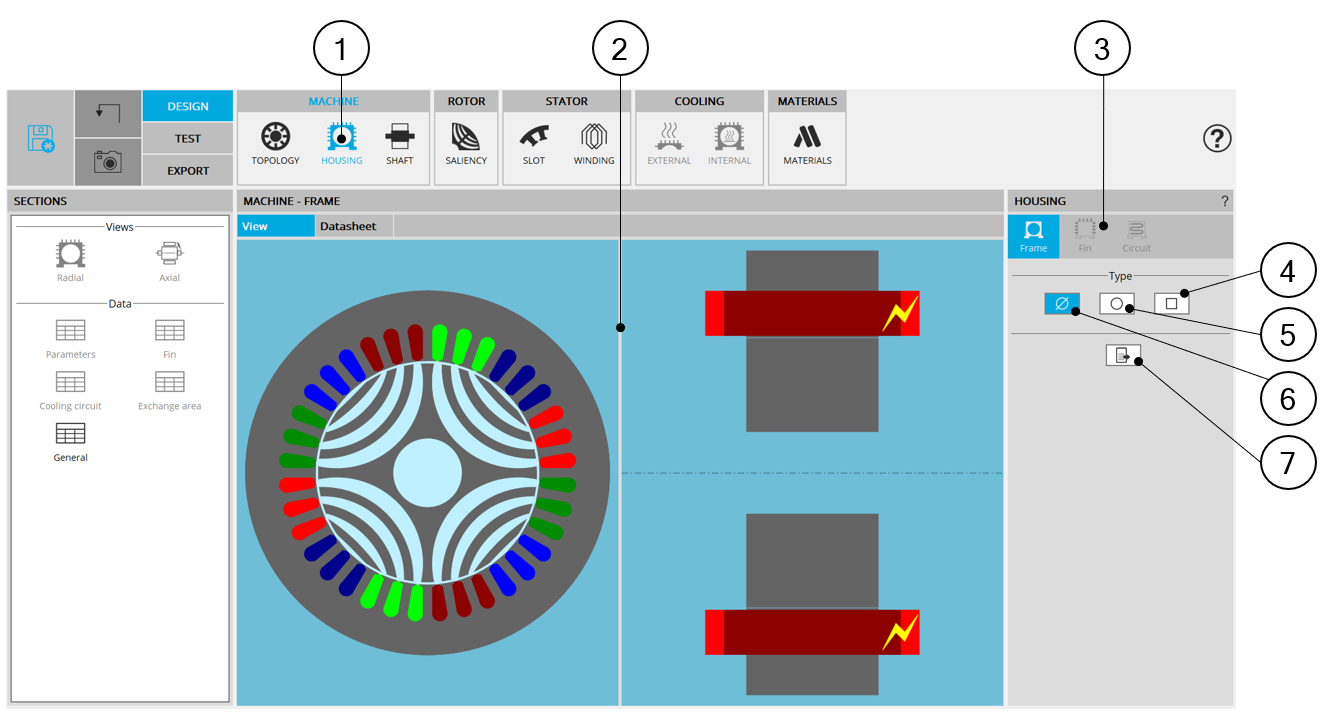

HOUSING
Housing - Overview
| HOUSING design area | |
| 1 | Selection of the MACHINE subset: HOUSING panel (Click on the icon HOUSING) |
| 2 | Radial and axial view of the motor. |
| 3 | Several sections allow defining all characteristics which are dealing
with the Housing: Frame, Fin and Cooling circuit. Note: By default, the section Frame is selected. |
| 4-5-6 | Three choices are available to define the lamination topology:None, Circular and Square |
| 4 | Choice of a square shape lamination. See additional information below |
| 5 | Choice of a circular shape lamination. See additional information below |
| 6 | Choice of “None” meaning that the outer shape of lamination is circular.
Outer dimensions of lamination are indicated in general data (structural data part). |
| 7 | Icon to export lamination data into *.txt or *.xlsx files. |
