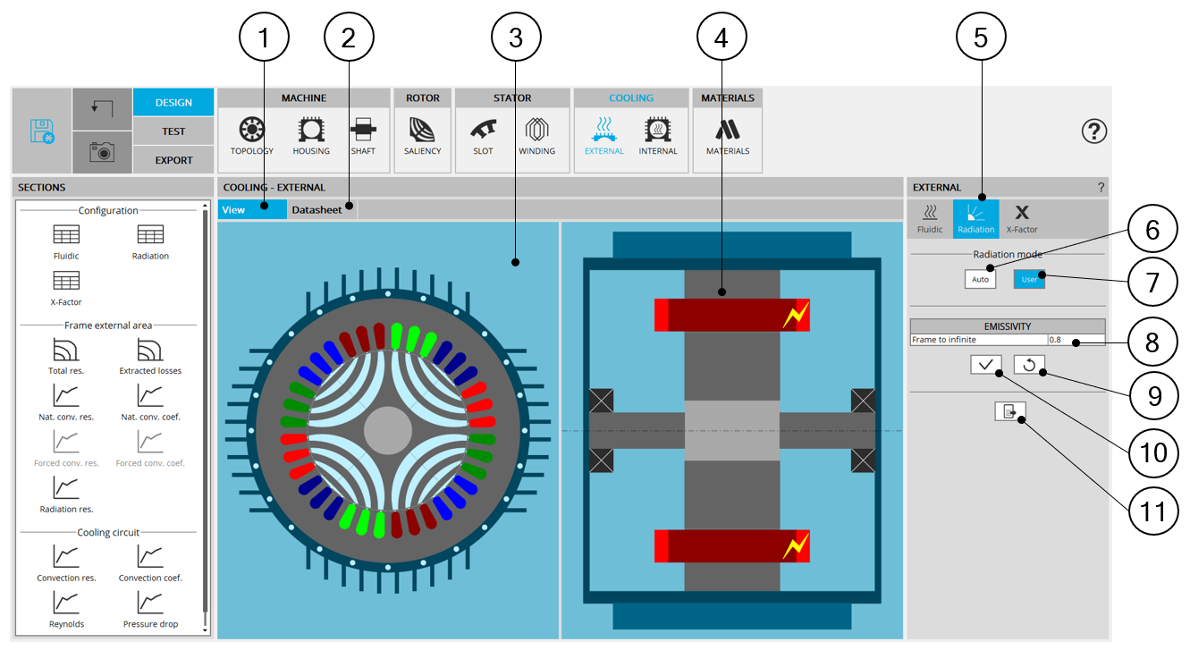

Display the axial and radial view of the machine. |
| 2 |
Display the external cooling datasheet, showing the main
thermal parameters of the frame cooling. |
| 3 |
Radial view of the motor, where specific exchange areas can be
highlighted depending on the selected input. |
| 4 |
Axial view of the motor, where specific exchange areas can be
| 5 |
The section radiation is selected. |
| 6 |
Button to set the external emissivity of the frame by automatic
process. |
| 7 |
Selected button, to set the external emissivity of the frame
manually |
| 8 |
Input related to the radiation corresponding to the selected
radiation mode. In user mode, only the Frame to infinite emissivity
must be define. The default value is 0.8. |
| 9 |
Button to restore default input values. |
| 10 |
Button to apply inputs. Pressing the enter key twice applies
inputs too. |
| 11 |
Icon to export external cooling data into *.txt or *.xlsx
files. |
