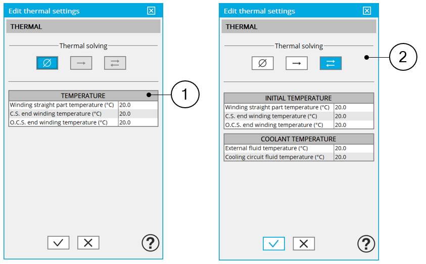

| 1 | Default mode of thermal setting for all the tests without thermal analysis |
| 2 | Thermal settings with two solving modes for all the tests with thermal analysis |

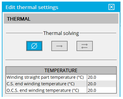

2.1 Temperature of winding
| Settings of winding temperature |
It is possible to define temperature of the three main parts of the stator winding:
- Winding active length temperature (part 1)
- Connection Side (C.S.) end winding temperature (part 2)
- Opposite Connection Side (O.C.S.) end winding temperature (part 3)
| Definition of the main parts of winding |

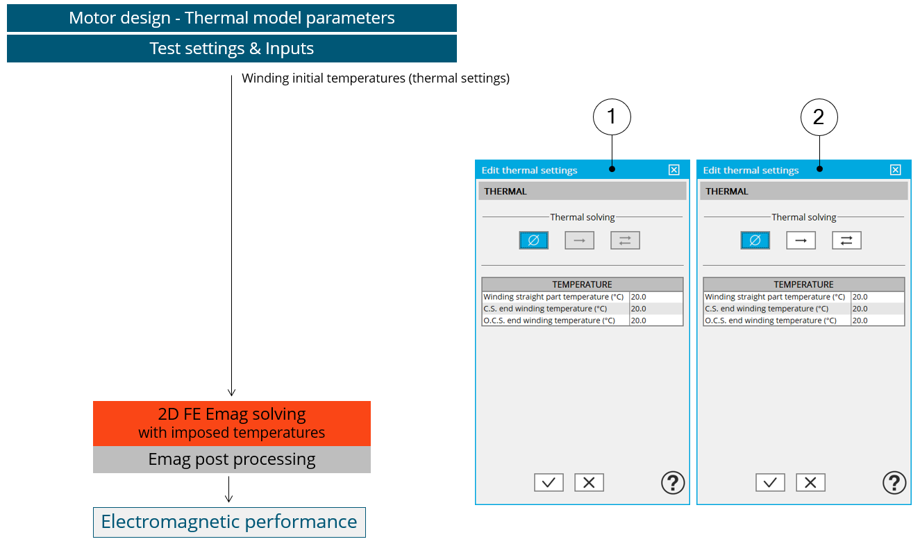

2.2 Flow chart of the tests without thermal solving mode
Below is the flow chart of computation, for test without thermal solving mode, available for all the tests.
| 2 | Thermal settings for the tests which have a thermal analysis are available |

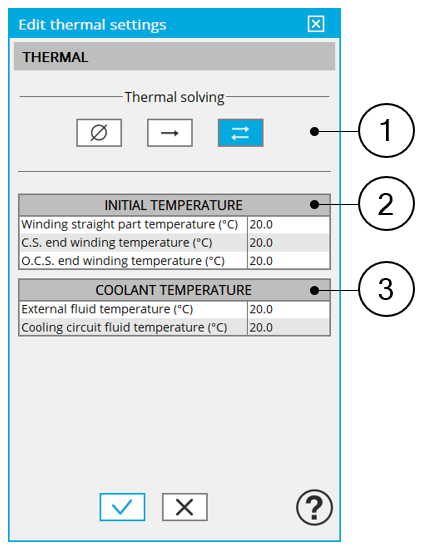

3.2 Thermal settings to initialize the test
For both scenarios, here is the list of thermal settings needed to initialize the test.
| 1 | Dialog box to define thermal setting. Iterative solving mode is selecting |
| 2 | Initial winding temperatures.These temperatures are used to initialize the electromagnetic-thermal process of computation. |
| 3 | Definition of coolant temperatures to be considered:
- The external fluid temperature corresponds to the temperature of the fluid surrounding the machine. It is also considered as the temperature at the “infinite” for the computation of radiation from the frame to the infinite.
- The cooling circuit fluid inlet temperature is proposed only when a cooling circuit has been added by the user in the design environment.

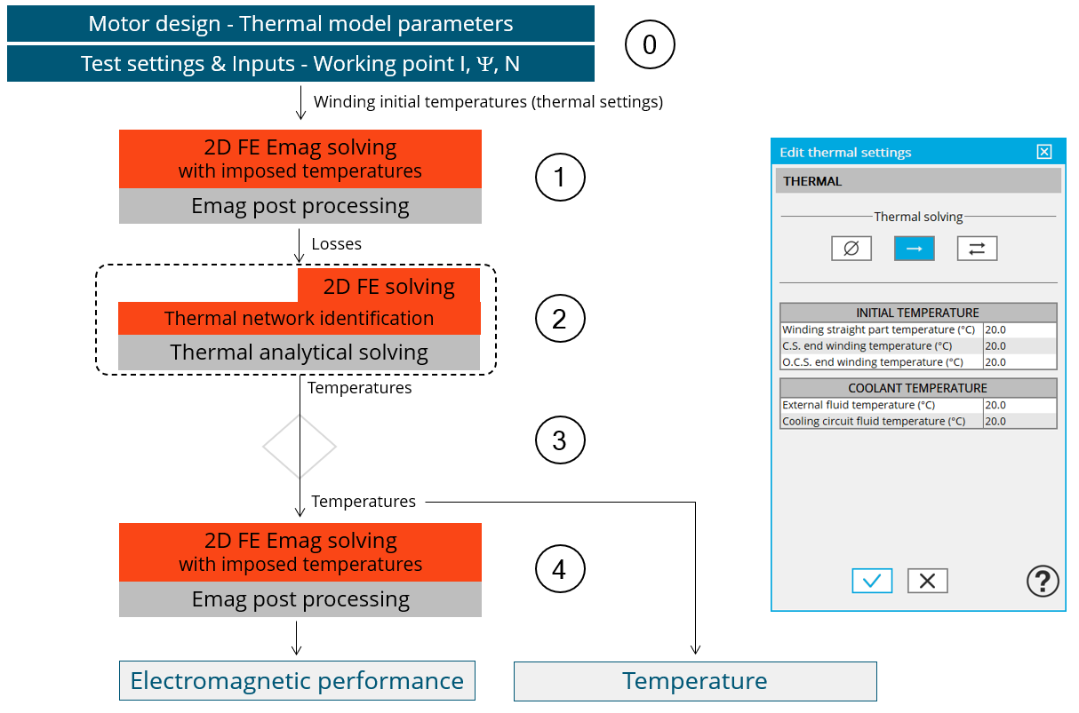

1) Flow chart or thermal solving mode test with iterative process.
| 0 | Definition of the initial temperatures (see the list in the previous section) and working point inputs |
| 1 | 1 st electromagnetic solving (Finite Element computation) with initial temperature defined in the thermal settingsLosses are computed. |
| 2 | Based on losses and speed defined by the electromagnetic working point,The thermal characterization is performed to define the temperature distribution inside the machine.The materials physical properties corresponding to the machine active components are then updated. |
| 3 | Iterative process = loop between electromagnetic and thermal computations until the convergence on the temperature is reached (See below where can be adjusted the convergence criteria when needed) |
| 4 | A last electromagnetic solving (Finite Element computation) with final
set of temperatures is performed once the convergence on the temperature is
reached (1) . Electromagnetic performance and chart of temperatures are computed and displayed.The test outputs are illustrated in the sections dedicated to the considered tests. |

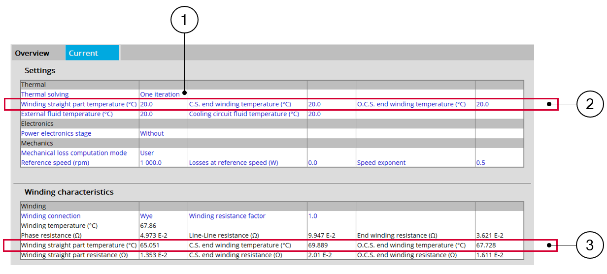

The temperatures which are considered for computing the final machine performance (step 4 in the previous flow chart) can be read in the table dealing with “Winding characteristics” of the test configuration at the beginning of result report. See below illustration.
The temperatures are also displayed in the chart of temperature and table after the electromagnetic results.
| 1 | Initial winding temperatures |
| 2 | Resulting final temperatures which are considered for computing resulting machine performance |
