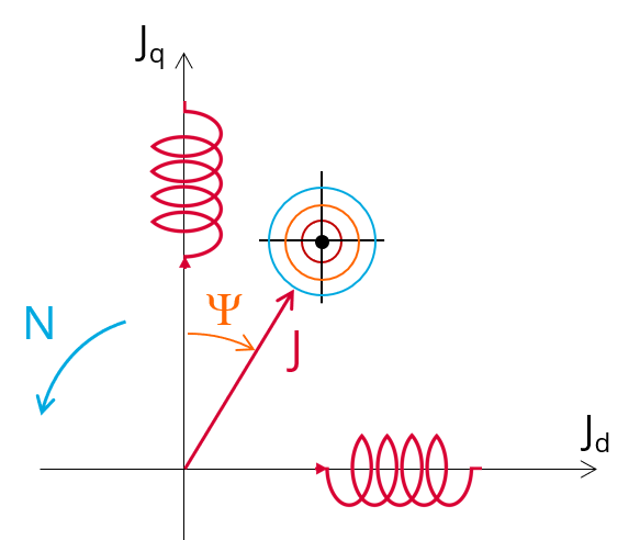

1. Positioning and objective
The aim of the test “Working point – Sine wave – Motor – I, Ψ, N” is to characterize the behavior of the machine when operating at the targeted input values I, Ψ, N (Magnitude of current, Control angle, Speed).
These three inputs are enough to impose a precise working point.
For instance, a working point can be chosen on the efficiency map, by identifying the current, the control angle and the speed with different curves or maps displayed in the “Performance mapping / Sine wave / Motor / Efficiency map” test. Then, the “Working point – Sine wave – Motor – I, Ψ, N” test allows to compute the performance for this working point.
