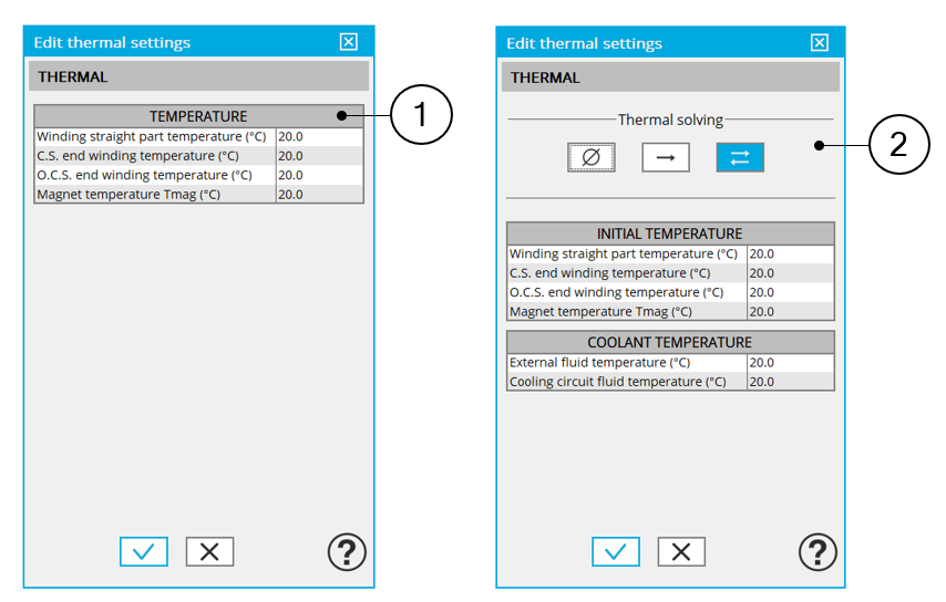

| 1 | Default mode of thermal setting for all the tests without thermal analysis |
| 2 | Thermal settings with two solving modes for all the tests with thermal analysis |

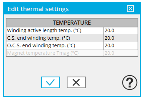

2.1 Temperature of winding
| Settings of winding temperature |

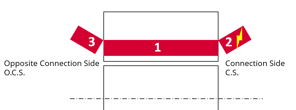

It is possible to define temperature of the three main parts of the stator winding:
- Winding active length temperature (part 1)
- Connection Side (C.S.) end winding temperature (part 2)
- Opposite Connection Side (O.C.S.) end winding temperature (part 3)
| Definition of the main parts of winding |
The resulting resistance of each part of the winding is updated according to the temperature:
- Winding straight part resistance (part 1)
- Connection Side (C.S.) end winding resistance (part 2)
- Opposite Connection Side (O.C.S.) end winding resistance (part 3)
The resulting resistance for the whole winding (considering the three parts described above) is computed as phase resistance and line-line resistance.

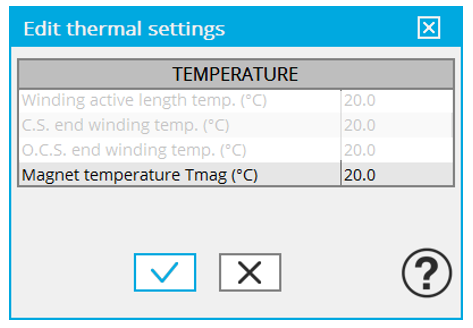

2.2 Temperature of magnets
The physical properties of magnets are updated considering the temperature set in this field.
The physical properties which are affected by this temperature are: the residual flux density (remanence) Br, the intrinsic coercivity (HcJ), the normal coercivity (HcB) and the resistivity.
| Setting of magnet temperature |

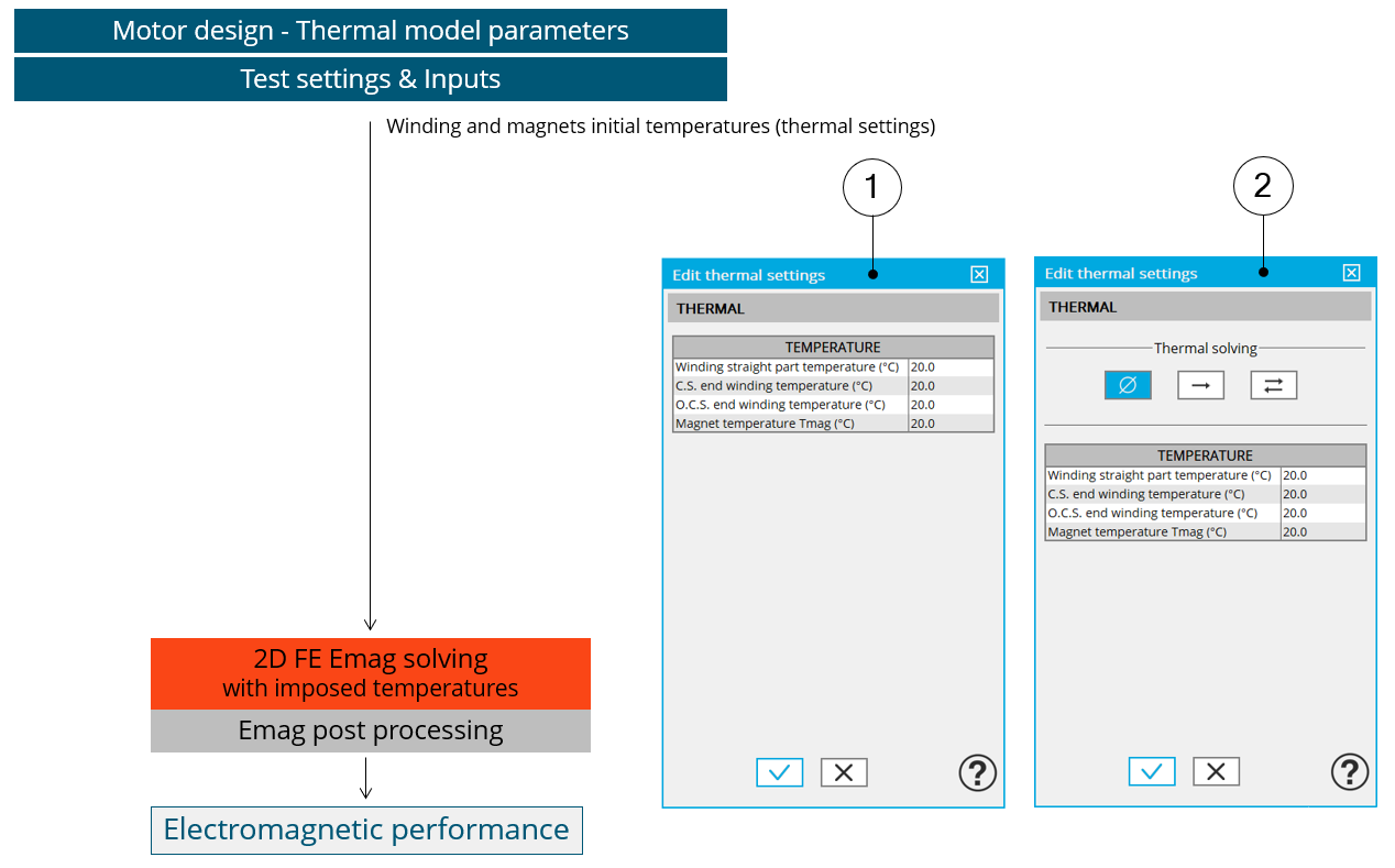

2.3 Flow chart of the tests without thermal solving mode
Below is the flow chart of computation, for test without thermal solving mode, available for all the tests.
| 2 | Thermal settings for the tests which have a thermal analysis are available |

| 1 | Dialog box to define thermal setting. Iterative solving mode is selecting |
| 2 | Initial temperatures of the machine active components: Stator winding
and magnets. These temperatures are used to initialize the electromagnetic-thermal process of computation. |

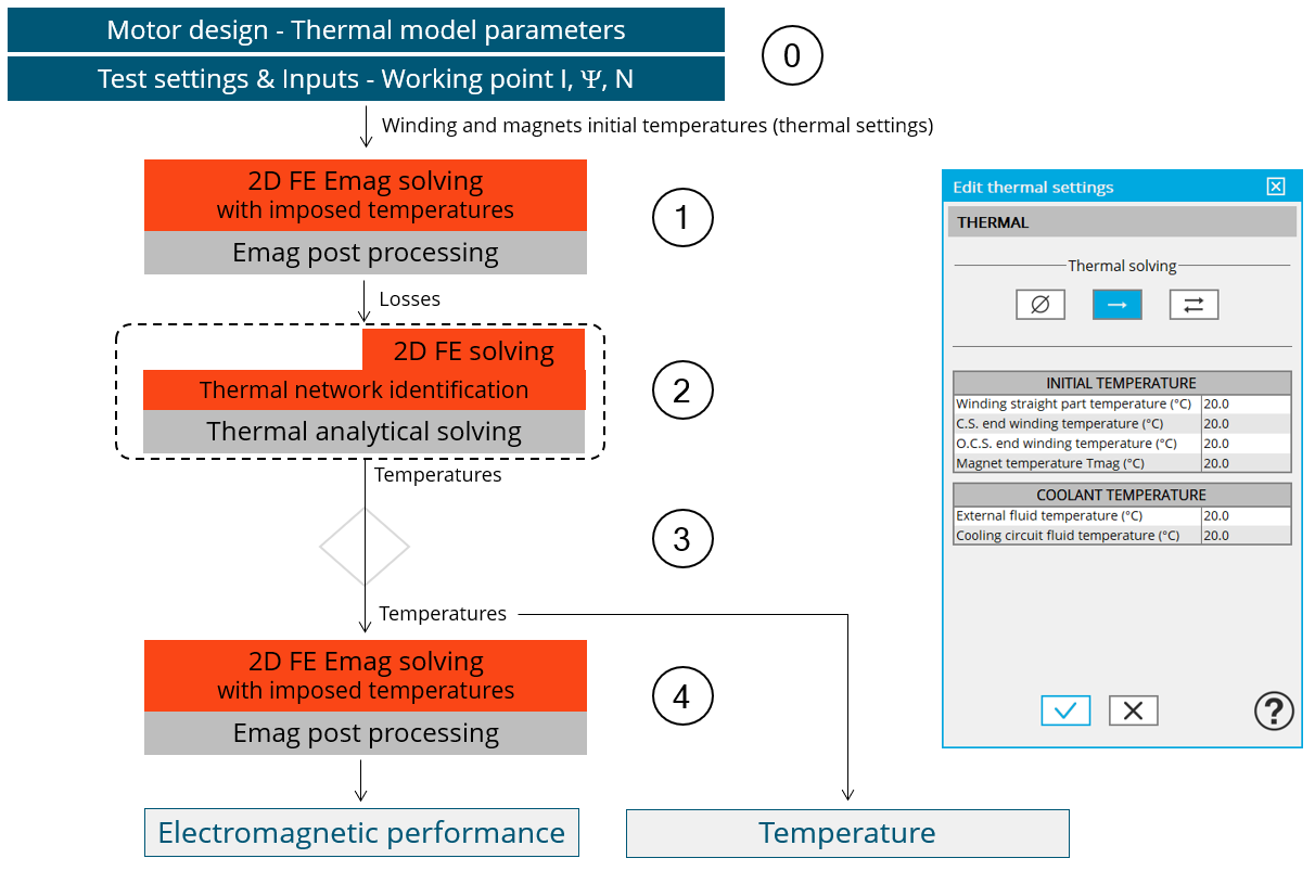

3.3 Flow chart of thermal solving mode – “Iterative” process

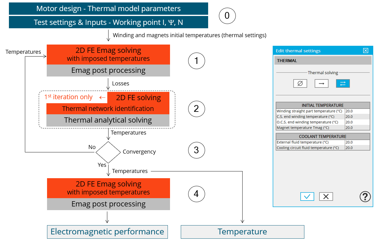

1) Flow chart of the thermal solving mode test with iterative process.
| 0 | Definition of the initial temperatures (see the list in the previous section) and working point inputs |
| 1 | 1 st electromagnetic solving (Finite Element computation) with initial temperature defined in the thermal settingsLosses are computed. |
| 2 | Based on losses and speed defined by the electromagnetic working
point. The thermal characterization is performed to define the temperature distribution inside the machine. The materials physical properties corresponding to the machine active components are then updated. |
| 3 | Iterative process = loop between electromagnetic and thermal computations until the convergence on the temperature is reached (See below where can be adjusted the convergency criteria when needed) |
| 4 | A last electromagnetic solving (Finite Element computation) with final
set of temperatures is performed once the convergence on the temperature is
reached (1) . Electromagnetic performance and chart of temperatures are computed and displayed. The test outputs are illustrated in the sections dedicated to the considered tests. |

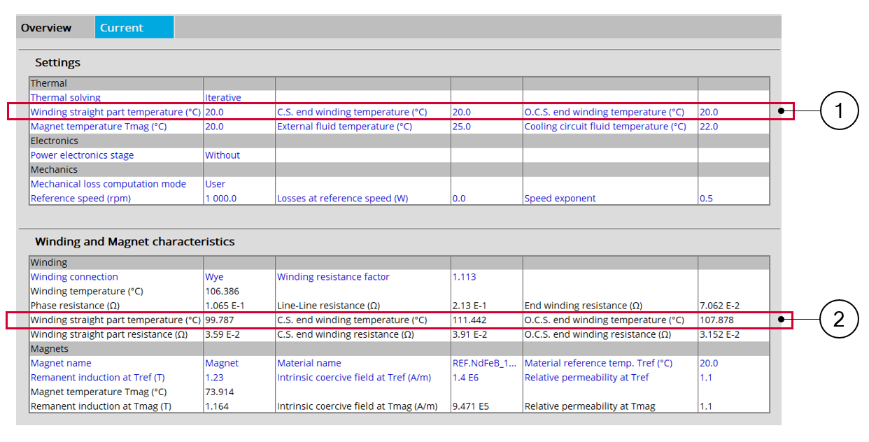

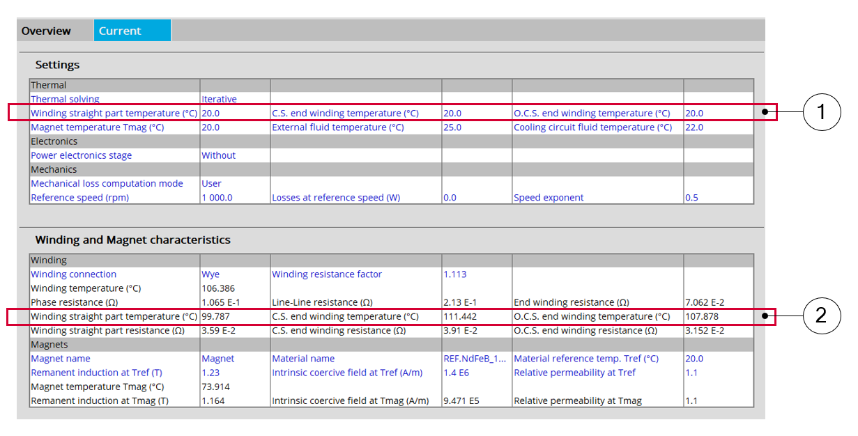

The temperatures which are considered for computing the final machine performance (step 4 in the previous flow chart) can be read in the table dealing with “Winding and Magnet characteristics” of the test configuration at the beginning of result report.
See below illustration.
The temperatures are also displayed in the chart of temperature and table after the electromagnetic results.
| 1 | Initial winding temperatures |
| 2 | Resulting final temperatures which are considered for computing resulting machine performance |

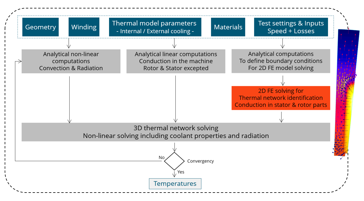

2) Thermal characterization in steady state – Flow chart
This section illustrates how the thermal characterization is performed to define the temperature distribution inside the machine from a set of losses and a working point speed
This process corresponds to what is performed to make the thermal characterization of the machine in the test Characterization / Thermal / Steady state
It corresponds to the second step of the previous general flow chart.
| Thermal test – Internal process flowchart |
The inputs of the internal process are the parameters of: Geometry, Winding, Internal cooling, External cooling, Materials, Test settings and inputs.
Then, the resulting network is extended with analytical computations to consider the 3D effect of the geometry.
The solving allows to get and to display the whole chart of temperatures of the machines.

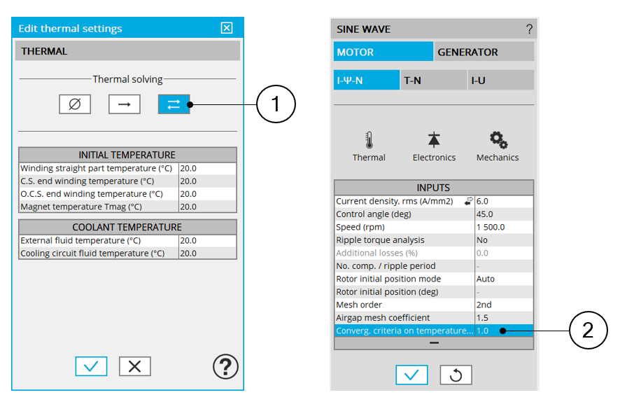

3) Iterative process – Adjustment of the convergence criteria
| 1 | Selection of the thermal solving Iterative process in thermal settings |
| 2 | Convergence criteria can be adjusted for reaching steady state behavior.
The iterative solving is stopped once the temperature variation in the machine between two iterations is lower than the convergence criteria. A percentage close to zero gives more accurate results but takes a higher computation time. A high percentage can make the convergence shorter but decreases the accuracy of the results. |
