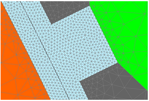

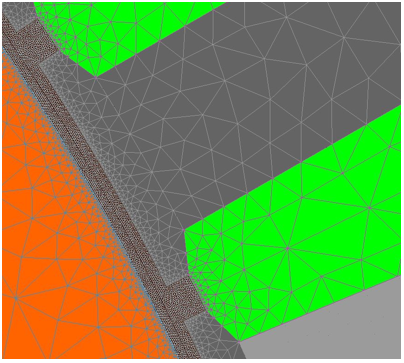

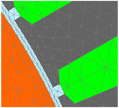

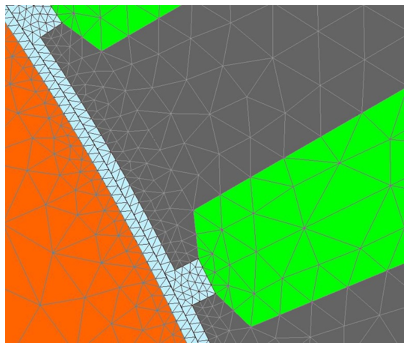

3.5 Airgap mesh coefficient
The airgap mesh density is a very sensitive parameter for cogging torque computation. To get better results, sometimes it is necessary to modify the default applied mesh.
The advanced user input “Airgap mesh coefficient” is a coefficient, which adjusts the size of mesh elements inside the airgap. When the value of “Airgap mesh coefficient” decreases, the mesh elements get smaller, leading to a higher mesh density inside the airgap, increasing the computation accuracy.
The imposed Mesh Point (size of mesh elements touching points of the geometry), inside the Flux software, is described as:
MeshPoint = (airgap) x (airgap mesh coefficient)
Airgap mesh coefficient is set to 0.45 by default.
The variation range of values for this parameter is [0.05; 2]
0.05 giving a very high mesh density and 2 giving a very coarse mesh density.
However, this always leads to a huge number of nodes in the corresponding finite element model. So, it means a need of huge numerical memory and increases the computation time considerably.
| Airgap mesh density = 0.45 = default value | Airgap mesh density = 1.0 |
| Airgap mesh density = 0.1 | Airgap mesh density = 0.1 (zoomed view) |
