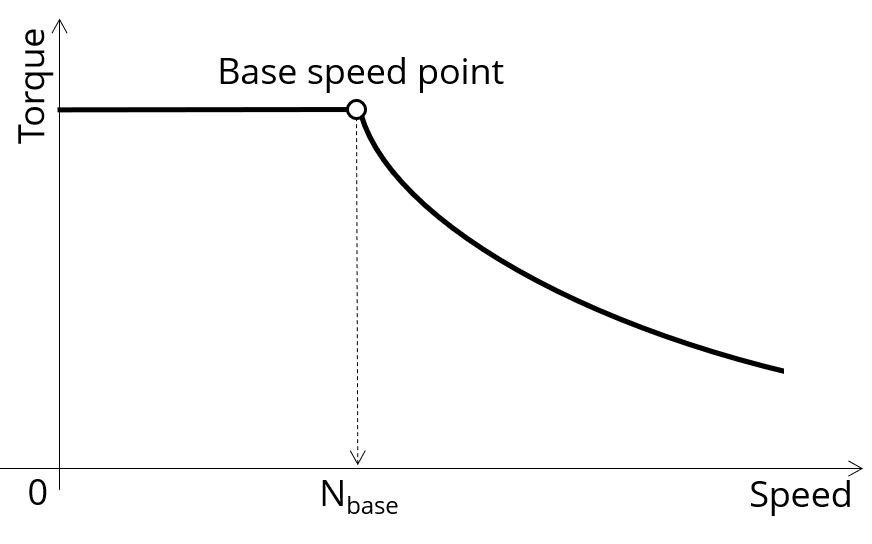

| Characterization of the corner point on the torque-speed curve |
Input parameters like the maximum “Line-Line voltage”, the maximum “line current” and the desired “Maximum speed” of the machine are considered.
Two types of command modes are available: The Maximum Torque Per Volt command mode (MTPV) and the Maximum Torque Per Amps command mode (MTPA).
Input parameters allow to define torque-speed envelope in the framework of which the targeted working points can be selected.
By default, the NVH evaluation is computed by considering working points on the torque-speed envelope.
But, one can define a list of working points located anywhere under (or on) the torque-speed envelope.
