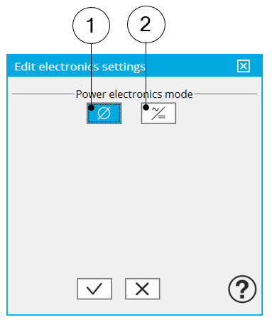

A dedicated dialog box allows the user to operate the motor with power electronic stage or without power electronic stage.
The following tests are concerned by this feature:
- Working point / Sine wave / Motor / U-f-N
- Performance mapping / Sine wave / Motor / T(slip)
| 1 | Button to not consider power electronics stage (=default mode) |
| 2 | Button to define the user parameters of the power electronic mode |

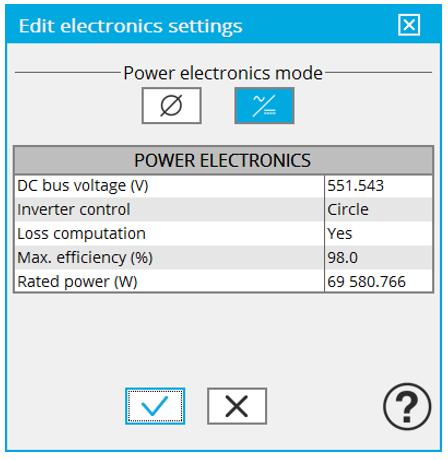

2. Power electronics parameters
When available, the selection of the “Power electronics mode” gives access to a dedicated list of user input parameters.
The number of user parameters to define depends on the selected test.
The whole list of power electronics parameters is illustrated below.
| Power electronics mode: whole list of input parameters |

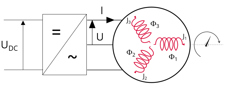

When the power electronics stage is active, the line-line voltage at the machine terminals required in inputs of some tests becomes non- accessible.
In this case, the line-line voltage is computed from the DC bus voltage (DC bus voltage before inverter UDC) and the Inverter control strategy set in power electronics settings.
The variation range of values of DC bus voltage is ]0; +inf. [
| Voltage and current inputs of the power electronics stage and electrical machine |

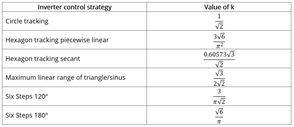

The chosen inverter control drives the ratio between the DC bus voltage and the line-line voltage seen at the machine terminal. This ratio is defined as:
Where U DC is the DC bus voltage before inverter stage and U rms is the rms value of the first harmonic of the line-line voltage at the terminal end of the machine.
The considered inverter control strategies and their corresponding values of k are listed in the table below.

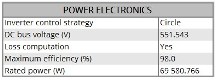

An internal process allows evaluating the power dissipated in the power electronics stage and its efficiency.
To get the result of this computation the user input Loss computation (Power electronics loss computation) must be set to “Yes”. The default value is “No”.
When this input is set to “Yes”, the computation of power electronics losses and efficiency is performed based on two other parameters to define: Max. efficiency and Rated power.
2.3 Max. efficiency (Maximum power electronics efficiency)
This parameter defines the maximal efficiency that the power electronics stage can reach. This efficiency can correspond to the efficiency of an inverter or a variable speed drive.
The losses occurring in the power electronics stage are computed using this parameter and the “Rated power” settings.
Max. efficiency is set to 98% by default.
The variation range of values for this parameter is [10; 100[
2.4 Rated power – inverter or variable speed drive
This parameter defines the rated active power of the power electronic stage to consider.
It corresponds to the maximum active power that the power electronics stage (inverter or variable speed drive) can deliver without being overloaded.
The losses occurring in the power electronics stage are computed using this parameter and the parameter “Max. efficiency”.
The rated power default value is defined from the default values of the system (machine and inverter) input voltage and current.
The variation range of values for this parameter is [0; +inf. [
- The internal process for evaluating the power electronics efficiency versus its rated power is based on analytical empirical formula.
- Only the first harmonic is considered to compute the behavior of machines. Induced losses due to the switching frequencies are not considered.

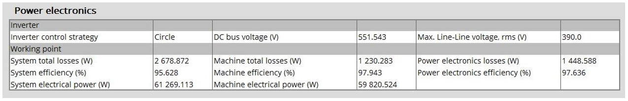

4. Dedicated outputs
When power electronics is active, the line-line voltage at the machine terminals and the DC bus voltage are computed/displayed.
Moreover, when the “loss computation” is selected by the user, additional output data are computed and/or displayed.
The losses and the efficiency are computed for the machine, the power electronics stage and the system. The “system” gathers the machine and the power electronics stage.
Then, the electrical power is computed for both the machine and the system.
| Power electronics mode with loss evaluation – Example of dedicated output table |

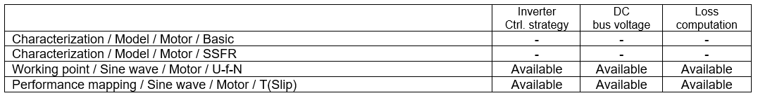

5. Power electronic and tests
The available input parameters dedicated to the power electronics mode depend on the considered test.
Below is the table in which are defined the correspondence between the tests and the input parameters of the power electronics mode.
The whole list of input parameters is illustrated below.
| Whole list of input parameters dedicated to power electronics |
- Loss computation uses Max. efficiency and rated power user inputs
- “-“ means the parameter is not used in the considered test
