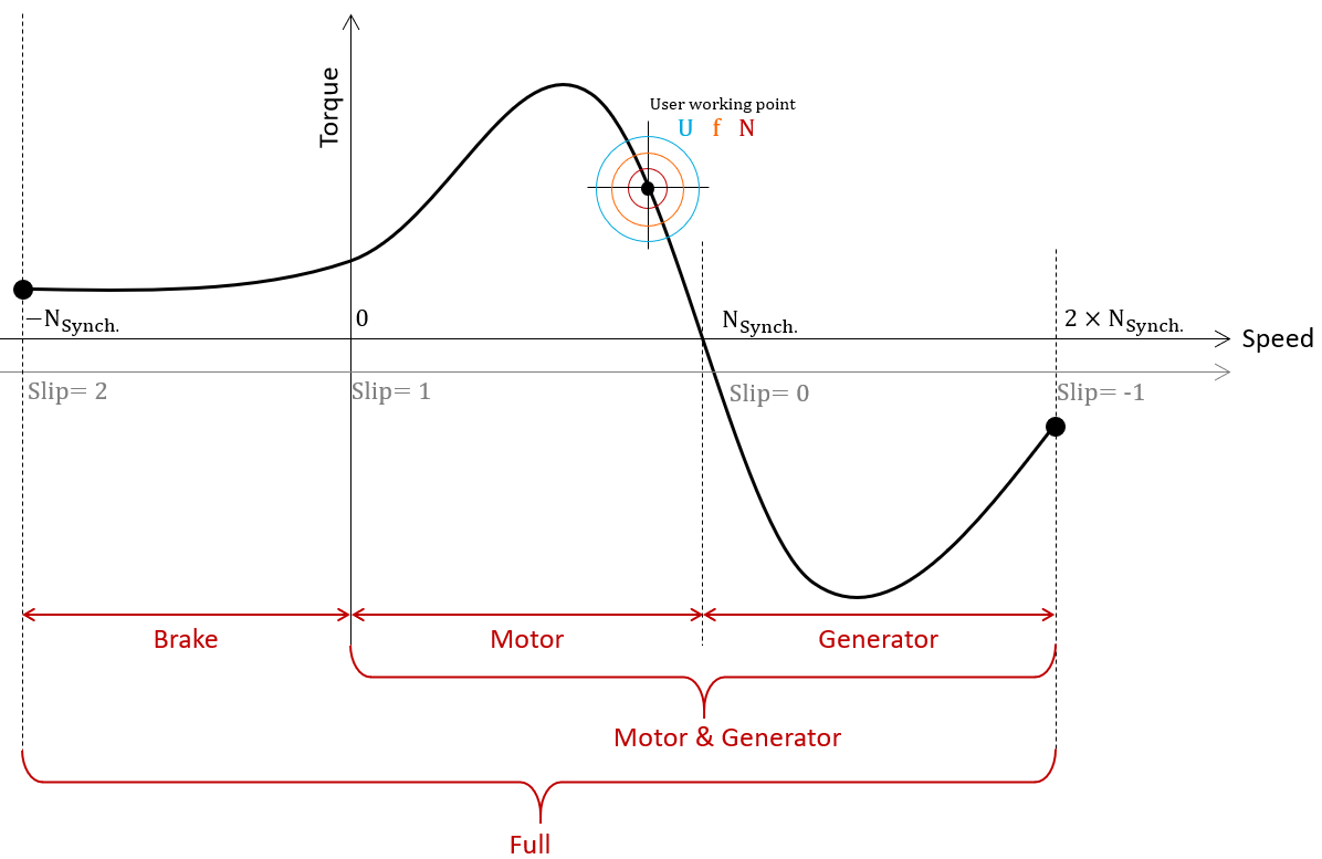

1. Positioning and objective
The aim of the test “Performance Mapping – Sine wave – Motor – T(Slip)” is to characterize the behavior of the machine when operating over a speed range corresponding to a targeted operating mode (“Motor”, “Generator”, “Brake”, “Motor & Generator”, “Motor & Brake” and “Full”). This also corresponds with the operating magnitude of line-line voltage (U) and power supply frequency input values (f).
Hence, these inputs are enough to define a T(Slip) curve and to get additional curves defining all electromagnetic quantities.
| “Performance mapping – Sine wave – Motor – T(Slip)” Illustration |
