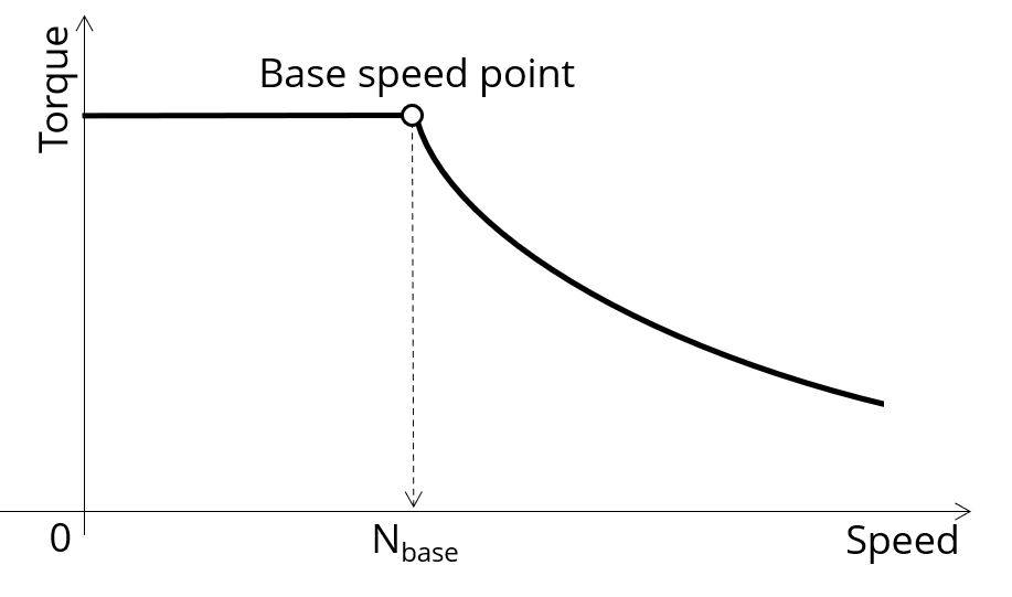

| Characterization of the corner point on the torque-speed curve |
In the results, the performance of the machine at the base point (base speed point) and for the maximum speed set by the user are presented.

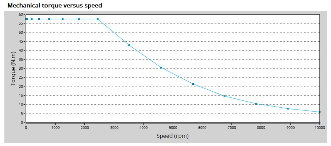

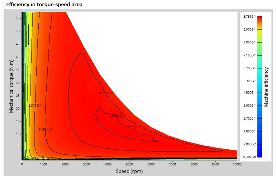

A set of curves (like Torque-Speed curve) and maps (like Efficiency map) are computed and displayed.
| Mechanical torque versus speed - Example |

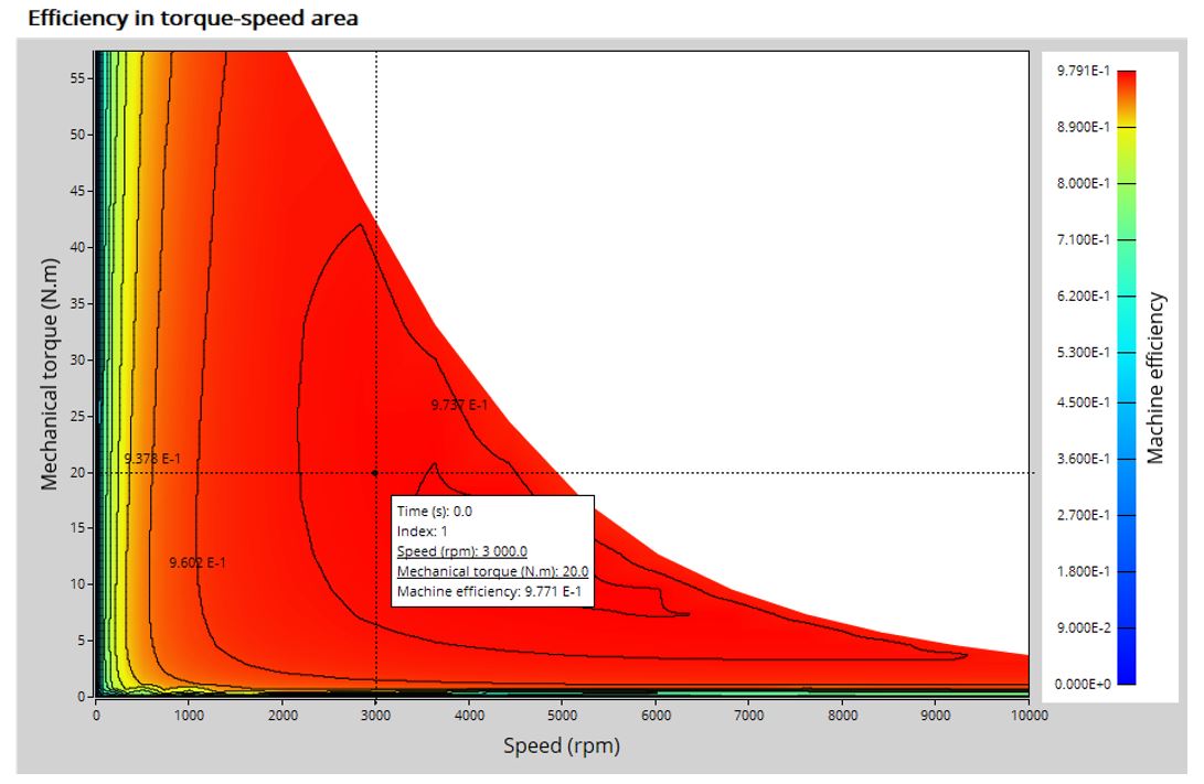

| Efficiency in torque-speed area - Example |
| A “single” working point displayed on the efficiency map - Example |

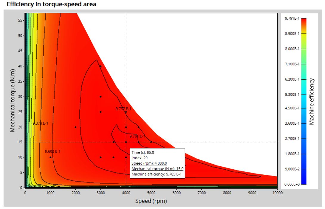

The second feature allows the user to define a duty cycle by giving a list of working points (speed, torque) versus the time. The displayed results illustrate the machine performance over the considered duty cycle (mean, min, and max values).
The time variation of the main quantities is also displayed (Mechanical torque, speed, control angle, current, voltage, power, efficiency, losses).
All the corresponding points are displayed on the different provided maps. Each working point can be selected to visualize the corresponding main information.
| A “Duty cycle” displayed on the efficiency map - Example |
