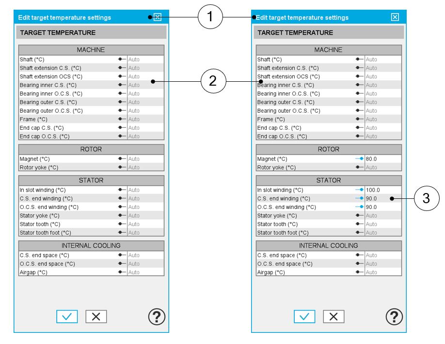

The aim of this dialog box is to collect the targeted temperatures to be reached. They are defined at each main node of the internal thermal network. See the illustration below.
| Target temperatures | |
| 1 | Opening of the dialog box for defining the target temperatures. |
| 2 | The main temperature nodes are listed. A target temperature can be set at each listed node. |
| 3 | Auto/User mode switches allow you to select the thermal nodes and set the corresponding target temperatures. |
Note:
By default, the target temperatures are all set to “Auto”, meaning that the thermal behavior of the machine will be computed based on a thermal working point defined by a speed and a set of losses.
This is the same test process as the one described above in the section dedicated to the Characterization – Thermal – Motor & Generator- steady state.
Note: In such a case, all the resulting calibration factors
(X-Factors) are set to 1 whatever the user inputs set in the X-Factor fitting
settings. See the section below.
