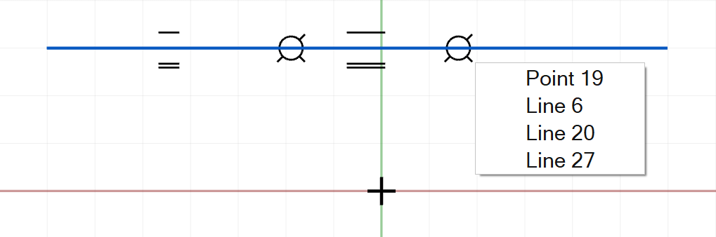

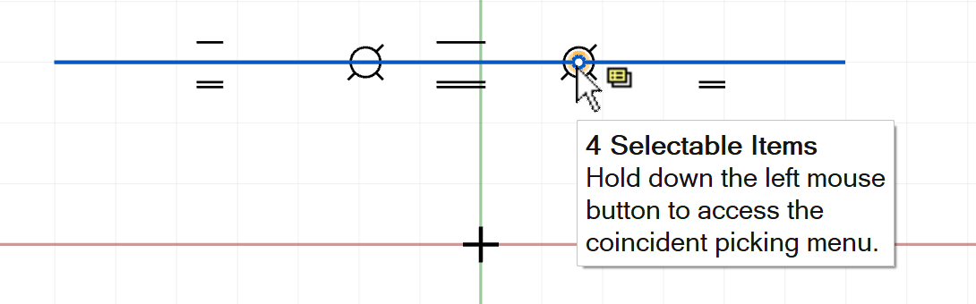

Click a point and any other entity to constrain the point to be coincident with the other entity. Tip: When you hover over coincident sketch entities, a badge appears next to the cursor and a tooltip appears.
This indicates that you can hold down the left mouse button to access the coincident picking menu, from which you can select the desired sketch entity.

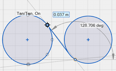

Constraint Description Tan/Tan When you sketch a line between two circles, the Tan/Tan inference helps you make the line tangent to both circles.

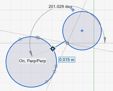

Perp/Perp When you sketch a line between two circles, the Perp/Perp inference helps you make the line perpendicular to both circles.
