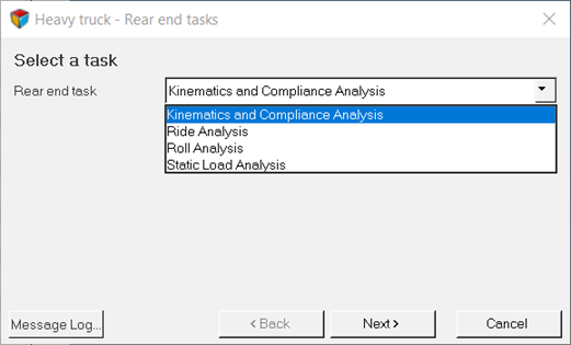

Select the required Rear end task from the drop-down menu.Figure 3.
Note: To learn more about the Ride Analysis, Roll Analysis, Steering Analysis, and
Static Load Analysis refer to the Rear Suspension Analysis Tasks topic.

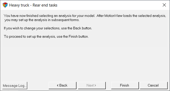

Select Finish to exit the Task Wizard.Figure 4.
